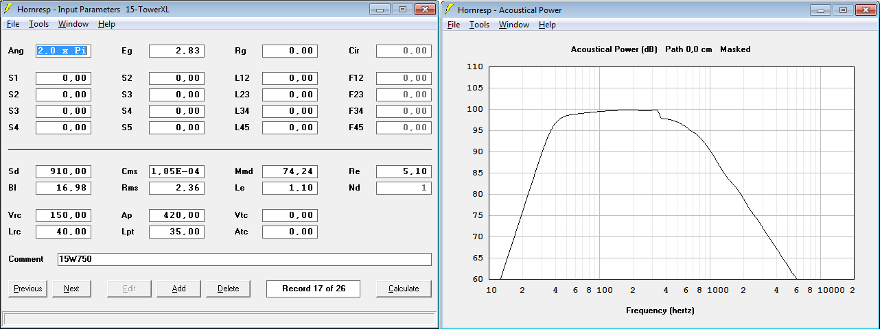

LORDSANSUI, your simulations are not right, this is off topic but some quick pointers :
First, that equation (Fs/Qts*0.39) is not to calculate f3, f3 has direct relation with given volume.
you cannot run different drivers with different Qts, Vas ... in same cab size, you have to change your cab size, port diameter and length (not just length) based on your driver and calculated tuning frequency, if you take a look at Paul's results you see he has different cab sizes.
you cann't have higher SPL than the driver itself, your result have 99db for 18Sound driver while the driver itself has only 97.
and to answer your question about AE driver, as been talked about before, first its Qms is not that bad and they are other thing that comes into equation as well, besides the overall high quality of the driver itself and good parameters, none of the other drivers can go that low and w relatively smaller cab, also Paul simulation shows it goes 90db which pretty damn high for that low freq and totally acceptable as a high sensitivity speaker.
I suggest to take a look at WinISD, not fancy but it calculates the volume and tuning freq for you and and you can see f3 and also you can see how changing volume and tuning freq can effect the low freq response.
Hope this helps :)
If the volume is a constrain, there is no problem to use the same volume for all simulation. The result would not be optimized for some drivers, but it could be optimize after. The major part of frequency response was flat.
The port area and port length are not linked to the driver, they are linked to the rear chamber volume and the tuning frequency to be achieve. So I just changed the length to better align with some drivers Fs. Simulating at 2,83v the port isn't a problem, Port fine tuning is done to reduce chuffing noise and compression (port velocity under 30m/s), but it's checked at Pmax or around it not at 2,83v.
I don't think the simulation are not right, it could be said that they are not fine tuned, but for driver comparison I didn't saw reason to fine tune all simulations. maybe I'm missing something, but if they didn't help, there is no reason to keep doing it. it's not my intention to mess the thread. I will keep reading it to discover what I didn't got.
Attached you can check the simulation to 18Sound. It has already been proven that Hornresp results are aligned with WinISD.
Sorry to disagree but a clarification is needed, the sentence above is wrong because technically is possible to achieve higher efficiency based on two things:
  • Space radiation
  • Enclosure type
Specifically for the 18Sound 15W750 simulation, the datasheet value was measured at free space (4pi) using 125L sealed box while the simulation was done using half-space (2pi) and bass reflex.
  • Space radiation
  • Enclosure type
The 18Sound 15W750 has a sensitivity of 99.5dB in half space if calulated out of the TSP parameters.
It is B4 basrelflex for Vb = 175 L and tuned at fB = 42 Hz, then F3 = 42 Hz.
  • Space radiation
  • Enclosure type
ok, thought we r done w this, we are not talking "technically", yes technically we can go active and achieve 100db from a 90db driver ! while at it we can also use dsp and eq and get the flattest respond too but it is not about this project and I assumed we are talking within this project and same goes with 18Sound driver, one would assume you are talking full space unless mentioned other wise, and if this helps and makes thing go faster yes you were right, technically that MAYBE possible and yes we can achieve 99db half space from a driver w 97db full space ;) hope we can let go and move on now.
