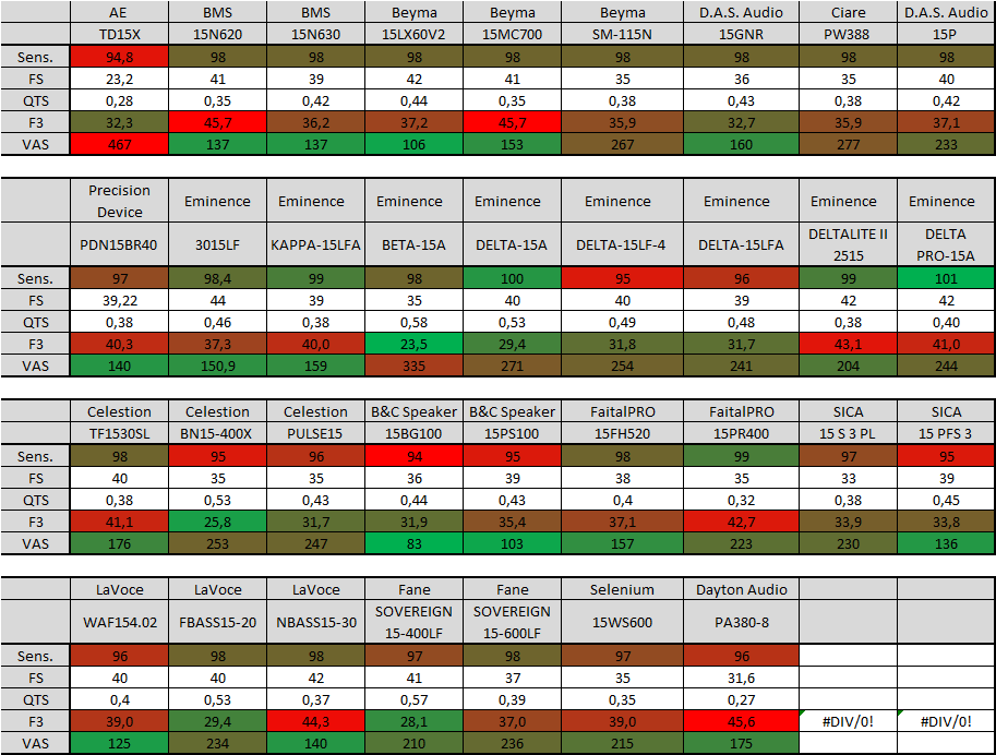

previously you indicated that you was looking for drivers with higher sensitivity than TD15X that has 94,8 dB/W/m and also lower VAS than 467L, probably these parameters alone are not telling all the history so I put some drivers in the same picture with color map in order to support for better comparison.
Leggend:
Sensitivity: Higher = green ; lower = red ; mixed color in between
F3: Higher = red ; lower = green ; mixed color in between
VAS: Higher = red ; lower = green ; mixed color in between

please review the correct parametres.
Tell me which are the correct parameter and I will update the charts. All values were took from datasheet except F3 that was calculated using Aato estimation F3=FS/QTS*0,39.

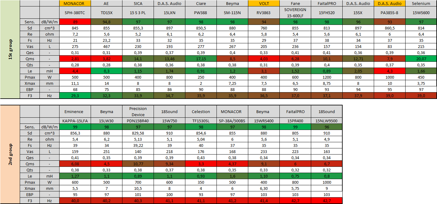

Thanks for explanation and considering all you said, I filtered some drivers again to respect the indications and from math standing point the attachment #1 indicates the results organized from lower F3 to higher in two groups, first one for F3 under 40Hz and second one for F3 higher but close to 40Hz.

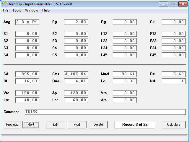

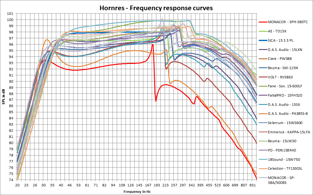

I also run some simulations using Hornresp with fixed cab volume, dept and port area, (150L/40cm/420cm^2). The only variable I was tunning was the port length. see attachment #2 for input data.
All drivers + cab SPL results are presented at attachment #3

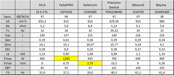

To eliminate some drivers I took into account the indication below:
QMS < 8
Le > 2,1mH
Driver + Cab Sensibility < 96dB/2,83v/qm
Only 6 drivers survived: (see attachment #4)
SICA - 15 S 3 PL
FaitalPRO - 15FH520
Selenium - 15WS600
Precision Device - PDN15BR40
18Sound - 15W750 (Winner for efficiency achieving 99dB/2,83v/1m)
Beyma - 15WRS400
