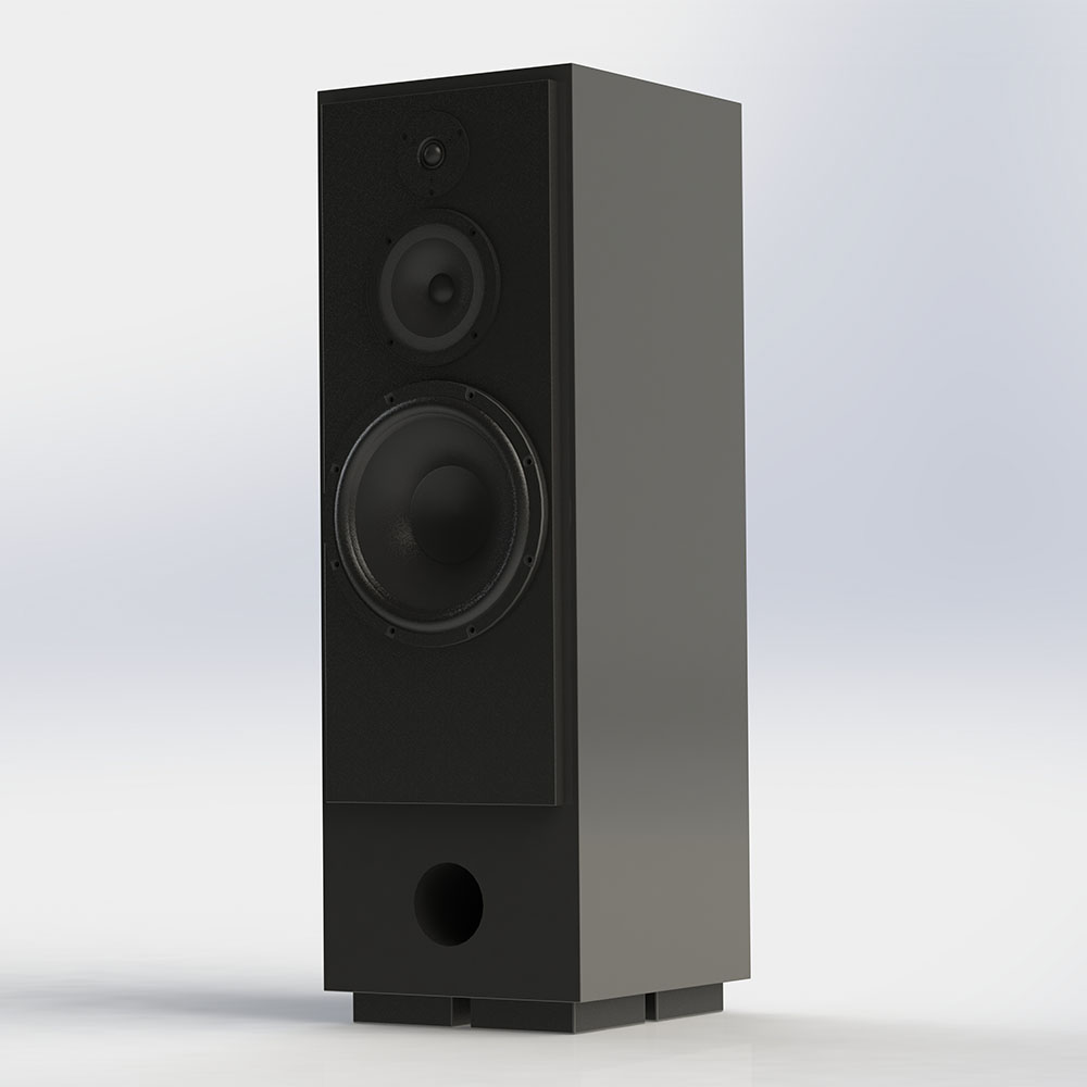

IMO the ATC SCM150 cabinet concept, apart from the midrange dimension at this time, is the most interesting for this project to get the targets.
like this 😀:
AE TD6M as midrange maybe ?
With a 15 inch woofer the X-over crossover frequency with the midrange cannot be too high; 400 Hz max, dependent on the woofer characteristics in the mid frequency region.
So a 3 inch midrange combination will become at the limit.
ATC crosses at 380 Hz with their 3 inch midrange. That woofer has a Sd = 774 cm2 (they specify a diameter of 314 mm). That is already a little less than the mean 15 inch driver.
We have to find a 15 inch woofer with a not too high Le value, that it can operate up to a few hundred Hz.

+1 for AE TD6M and also I like lower XO point for woofer/mid anyways. the closest we got was the Eminence Kappa 15FLA. we do not have much options for woofer. they are just simply not many single driver out there w specs we need, so maybe we may have to look at this from another perspective, instead of looking for a driver to match our needs maybe we can find a way to get close to the goal with the drivers we have available. anyhow another driver would be FaitalPro 15PR400. needs quite large cabinet tho (~200 liters).
Could achieve 91dB half space with 1-2 10" drivers.
Seas CA26RE4X one of these has 91 dB efficiency, should be able to get down to F3 of 36 Hz
Satori WO24P-4 two of these would work for 91dB, but expensive.
you ll need a woofer with sensitivity close to 100 (98-99db) do be able to achieve close to 92db in over all sensitivity after baffle step and all that 😉 with a single 91db driver you will end up with close to about 82-83db.
I wouldn't call anything with a driver larger then a 10" on the front a "tower".
But have to keep in mind that this is not a regular home hifi WAF friendly tower. a tower with this specs will be gigantic, it is just physics.
