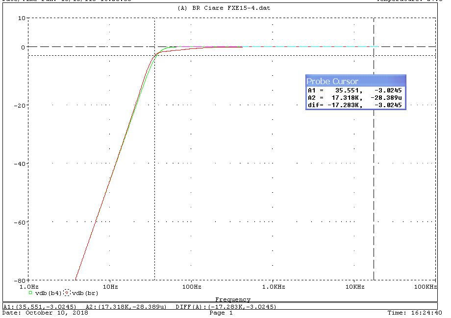

For the Ciare FXE15-4, I think 170 L and fB = 35 Hz is a too large cabinet volume and the tuning frequency a little too low.
--> Ciare FXE15-4 in 170 L tuned at 35 Hz, F3 = 35.5 Hz, F6 = 31 Hz, F10 = 27 Hz, sensitivity 90.4 dB full space.
Look in the plot below what is happening. You see the response in red, compared with a Butterwoth B4 alignment at the same system frequency. It is a little more resonant at 38 Hz than the B4.

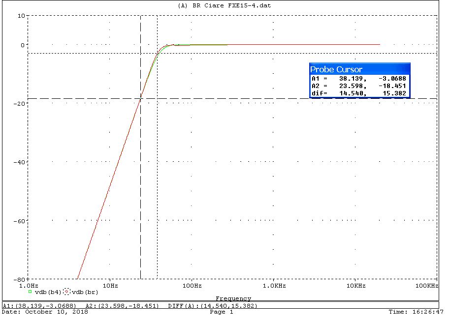

Maybe choosing something between, 145 L and tuned at 40 Hz.
--> Ciare FXE15-4 in 145 L tuned at 40 Hz, F3 = 38.0 Hz, F6 = 34 Hz, F10 = 30 Hz, sensitivity 90.4 dB full space.
Looking in the other plot now, you can see the difference, it is almost a B4 now.
Maybe the listening performance in 170 L is ok, but I prefer to choose for some standard response.

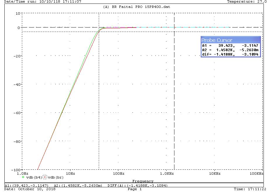

The Faital PRO 15PR400 was also an option, but F3, F6 and F10 are a little higher, because Qts is lower for that driver. But the sensitivy is almost 2dB higher.
--> Faital PRO 15PR400 in 170 L tuned at 40 Hz, F3 = 39.3 Hz, F6 = 35.1 Hz, F10 = 31 Hz, sensitivity 92.2 dB full space.

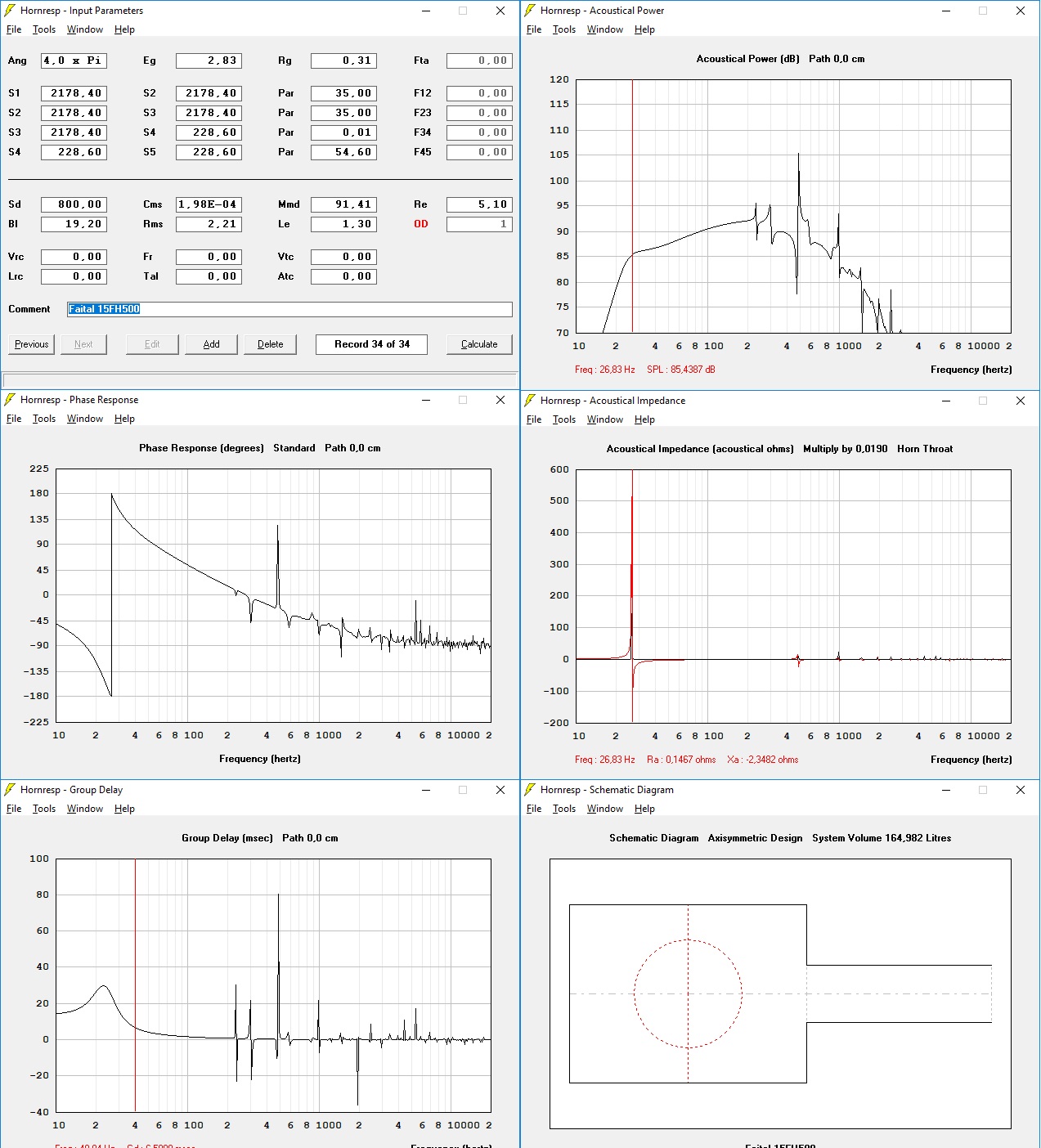

Noone has considered the Faital 15FH500?
Just noticed the GD is almost unreadable, it says 6.5888msec/40hz (quite low). Around 15msec/30hz.
