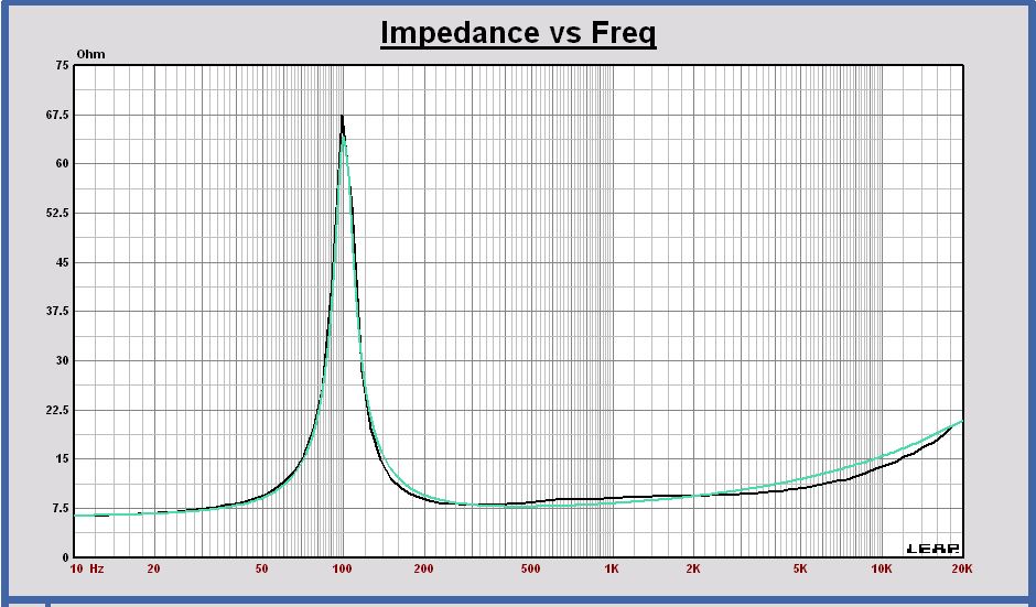

I looked already closer to your impedance measurement.
I take the assumption at this moment that for your drivers Mms = 20 g, like mentioned in the datasheet.
Making a model in Leap which impedance fits on your impedance measurement, I have to decrease the BL to 10.5 N/A. In the datasheet BL = 15.5 N/A.
The sensitivity of your drivers is to be expected 3 dB lower than the specification, or 91.5 dB @2.83 Vrms, 1 m.
See in plot 1, the impedance of the Leap model (green) and your measurement (black).
In plot 2, the SPL of the Leap model using the TSP of your measurement (grey) and the SPL of the TD8M datasheet (red). You can see the 3 dB difference and the higher Q impact for lower frequencies.
Without any further comments at this moment, just to inform you, based on your first preliminary measurements.
Only this, maybe trying to do an "added mass" measurement or a calibrated SPL measurement at 2.83 Vrms, 1m on IEC baffle. Then TSP of your drivers can be exactly calculated.

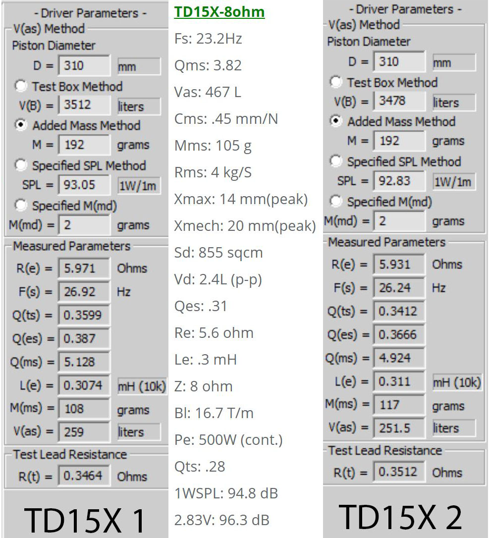

I measured the TD15x after 24hrs burning in with 15 to 25Hz sweeps.
the added mass method is weird, I get different results each time, I read about it and everybody say that if you do not add the mass right ( no vibration) you will not get accurate results.
How much mass do you usually add ? is the iron and the magnet have the same weight ?
By the way, the results did not change much since the first time I measured after 12 hours burning, so I either don't doing it right or it's just it.

The total weight (magnet + iron piece) is what counts. The weight should be a "good percentage" of the cone mass. 20% or 30% should work ok, maybe also a bit more.
I'd suggest to use a higher drive voltage. I had to beat my Faital woofers quite a bit by running them at 15 Vrms for about 24h. Also remember to cool down the drivers from break in before measuring the impedance curves (a hot driver will have a weak motor and softer suspension than cold).

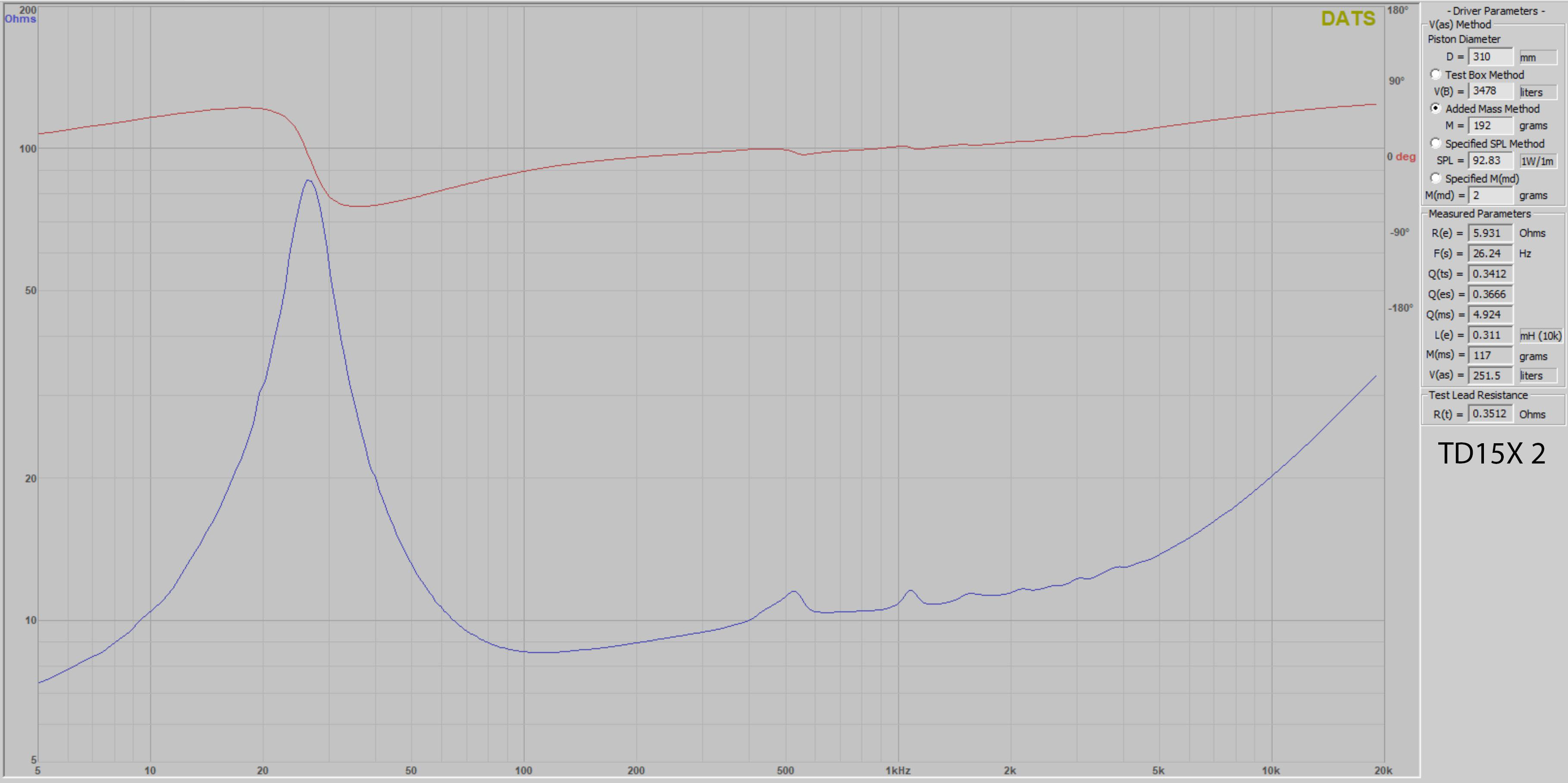

Out of your first measurement, the TD15X looks close conform specification. fs = 26.3 Hz (spec = 23.2 Hz), Qms = 5.2 (spec = 3.82).
That is good news then Paul, the woofers are taking some serious beating since last night, 15Hz 15v, will do a 30Hz 15v on the mids after that.

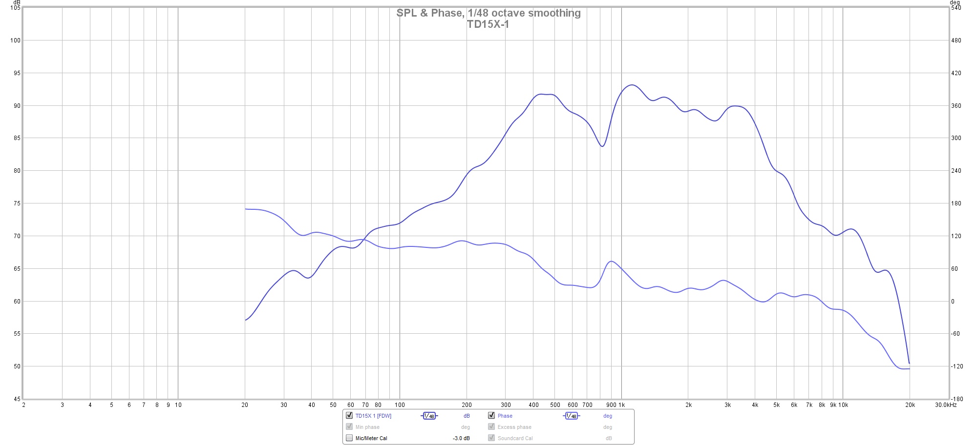

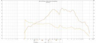

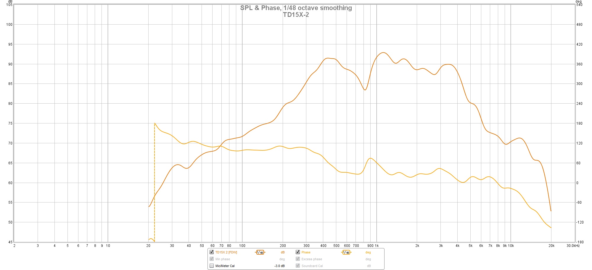

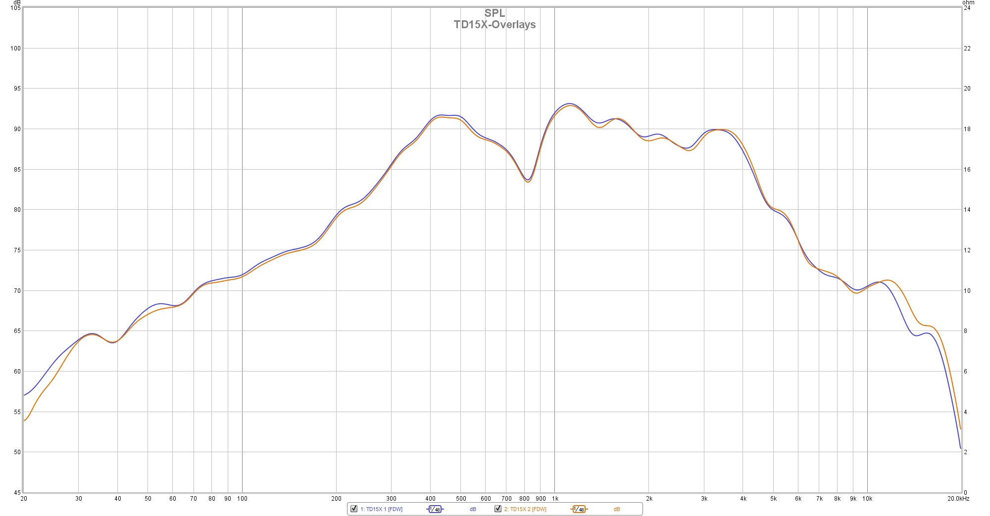

I attached the latest measurements for the TD15Xs, it's after 12 hours of 15Vrms beating, I ll let it burn more but it probably has to wait until next weekend. but numbers are close enough I think.
I also did the first free air FRD measurement as well, it is not ideal since the woofers were on the ground (isolated by isolation pads), the mic was pointing directly at them from above at 60cm from the cone of the speaker ( pointed at side of the phase plug), I brought it down from 1m to avoid some reflection. and please keep in mind that the SPL is not calibrated, so it's just the frequency response. that 800Hz dip is probably reflection from something.
(mic is calibrated USB umik-1).
You need to mount the driver in a baffle and far away from all reflecting surfaces or objects (floor, ceiling, walls, furniture) for free field measurements.
For low-frequency measurements you might also take near-field measurements with the microphone just a few mm away from the cone / dustcap. This will give useful data in the bass only, where echoes/reflection are masked. But I guess you are mainly interested in bass with these drivers anyway.

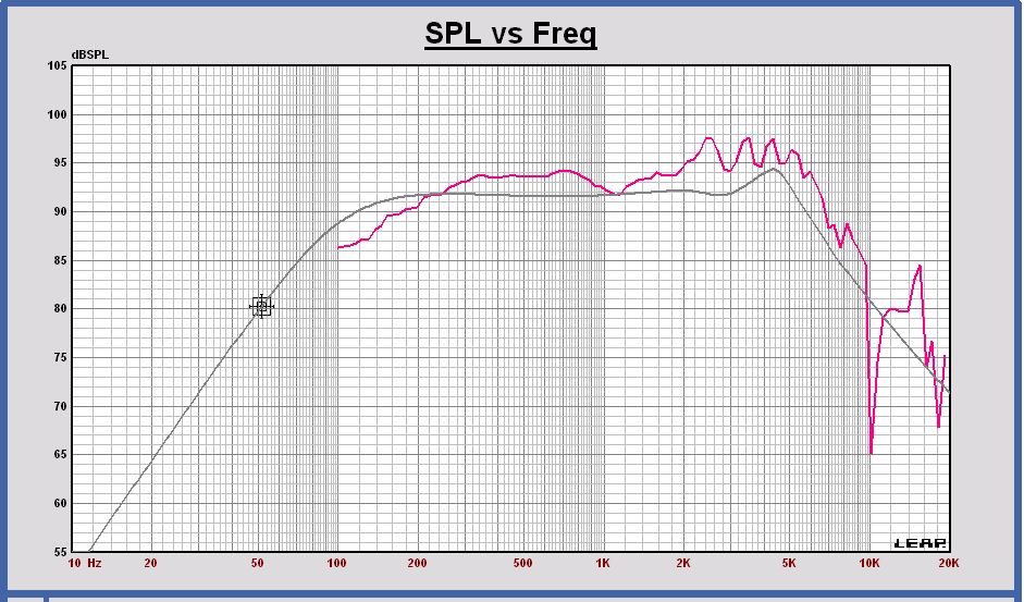

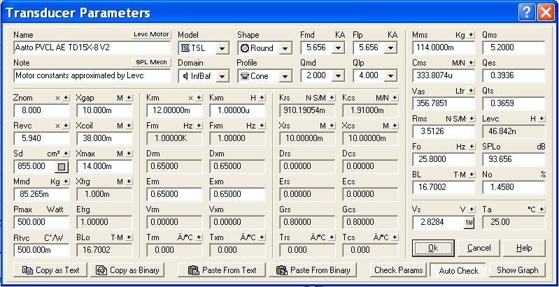

Aatto:

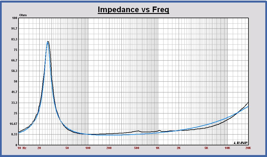

I did a fit again on the measured impedance to make a Leap model of your driver 1.
In the plot your driver in black and the Leap model in blue. Also the TSP chart of the model added.
Some differences w.r.t. the datasheet:
fs = 25.8 Hz vs. 23.2 Hz
Qts = 0.37 vs. 0.28
SPL 2.83Vrms = 94.9 dB vs. 96.3 dB (higher Mms and Re, same BL)
We have to review the basreflex system, Qts is too much different.
Have you measured Re separately with an multimeter? Best to do that accurately.
You take a different piston diameter than the datasheet, that one is 330 mm. Best to take the same to compare parameter values. Finally an absolute SPL and impedance measurement should be the reference for the design.
To make a SPL model for a driver I use the TSP of the datasheet or of a measurement at low frequencies up to 400 – 600 Hz and a SPL measurement for the higher frequencies, out of datasheet or other measurement. I used a link of John now to make an expected model for the high frequencies,
AE Speakers TD15X 4ohm - drivervault

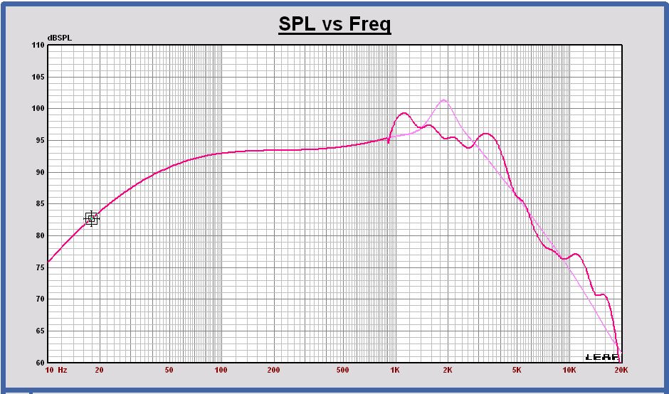

In the SPL plot, your measurement (blue) with the expected SPL (pink), using your measured TSP.
What you see around 300-800 Hz in your SPL measurement, is a dipole behavior of the driver, because there is no baffle. Without a baffle you cannot measure almost anything that makes sense, like Matthias is mentioning also.
Doing a datasplice at 900 Hz now of the Leap model and your measurement, a very roughly driver model can already be made, see red curve in second SPL plot.
For a good driver model the datasplice should be located around 400 Hz for such size of driver, together with accurate TSP and SPL measurements.
Edit: Aatto, if you measure the SPL later on, please give me also the voltage on the driver and the distance of the microphone to the front side of the driver, that will become flush with the front baffle. Take 2.83 Vrms or some lower value, 1 Vrms for example, if it becomes all too loud.
Also a nearfield measurement will be welcome, its shape is an extra check of the TSP.

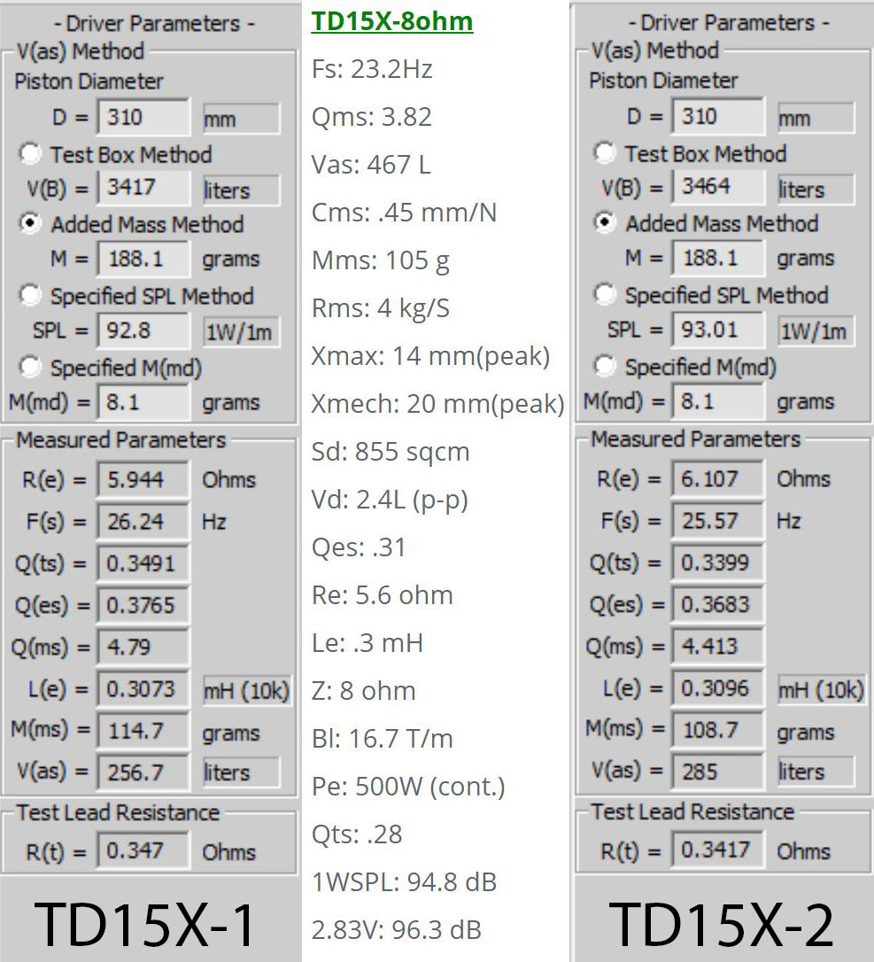

Paul, mbrennwa
in baffle (IEC or anykind of baffle) measurement is not possible for me at the moment. I m not sure but I think we did talk about it, I do not have access to a baffle and building one at the moment is not possible since I may have to move in very near future.
I can do some nearfiled measurements tho.
Is it possible to use initial factory measurements and values for initial design and then measure the rest in intended cabinet ?
as for the T/S parameters, this DATS is weird, I have a calibrated Fluke meter and I get different values than DATS when I measre the Re.
I also used 330mm for diameter before, I m not sure how to actually get the Diameter since I saw different methods and never had to measure one muself before, my main use of DATS was limited to measure the impedance curve.
As for the added mass I used 68g in my first measurement but since my second time measuring I keep getting errors for anything lower than 100g, it keeps saying that the mass is too light and it need to be 25% of ... but the added mass and diameter is only for measuring mms and vas, the rest of T/S parameters is the open air measurement with no added mass, so the different QTS has nothing to do with it and the driver may need more beating ?
Aatto,
We are going to make the best of it. Maybe we can do as follows.
- We assume Mms and Sd to be the same as datasheet.
- Like you say, then we calculate all TSP out of free air impedance measurement.
- Nearfield measurement to check TSP.
- Re measurement with accurate multimeter.
- SPL measurement in cabinet at 1m and if possible SPL calibrated. If you have correct SPL values, Mms can be checked again with high frequency level at a few kHz. And we have also the relative SPL of all drivers.
Edit: we can make an initial design with the assumption of some parameters, maybe already before the cabinet measurements for a first idea.
