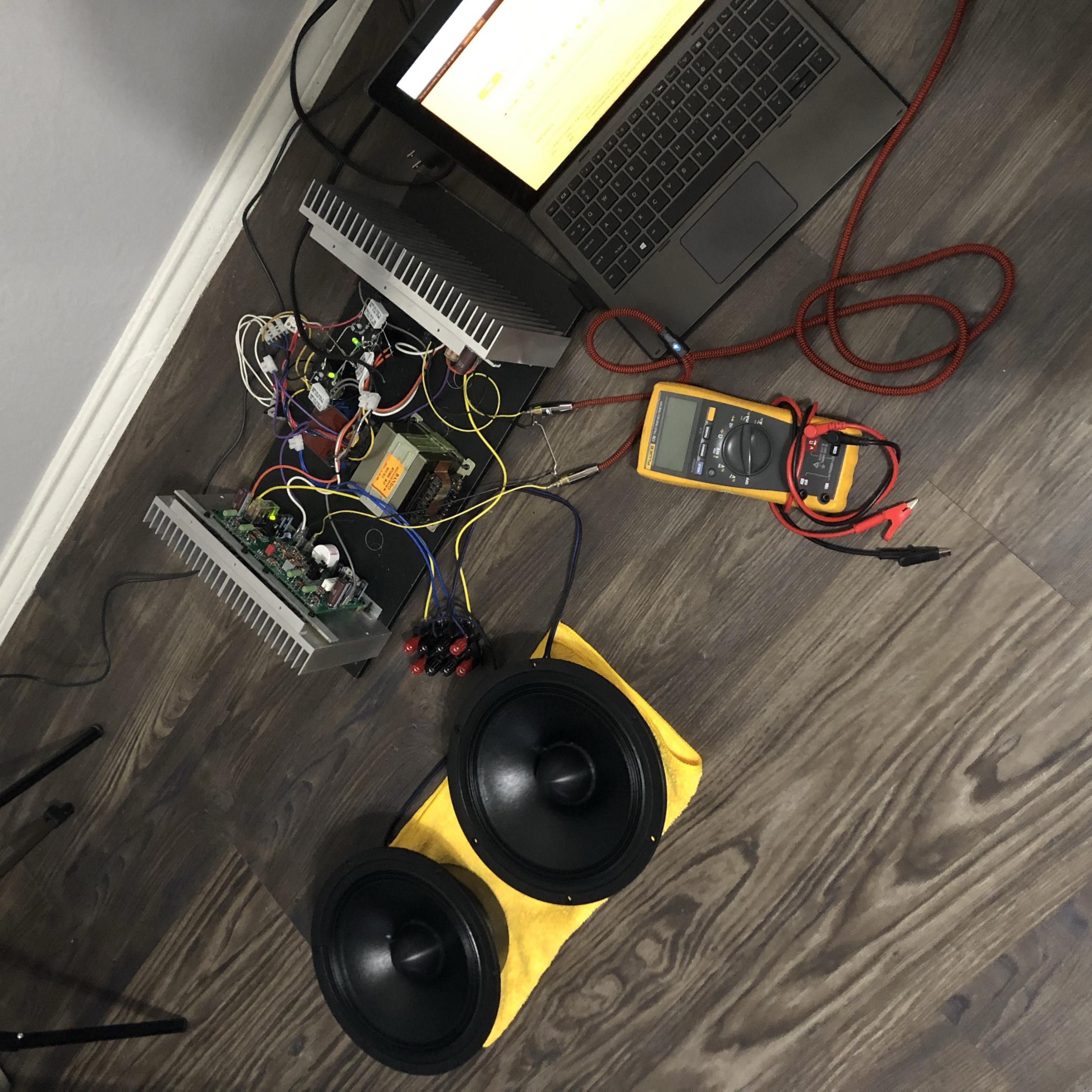

in other hand the TD8Ms are burning !
40-60Hz sweeps at about 6Vrms.

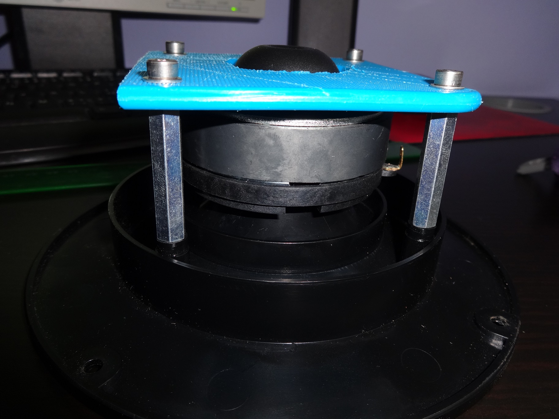

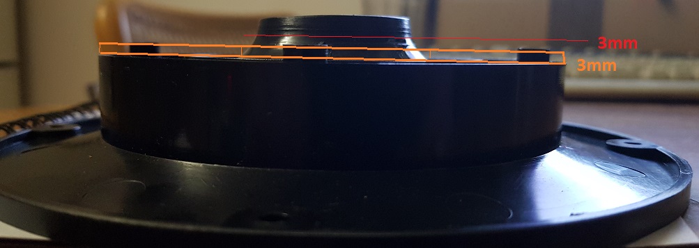

Attached image shows the idea of mounting. I am sorry, this was one of my first projects, I do not have detailed photos. Orange color represents 3mm mdf ring, sitting on the WG, I used silicon glue to fix it, it also added some weight and supressed resonances. After that I used another 3mm ring, representing by red line, and sanded away the rest of the throat. After sanding, that "red" ring is removed, and you can fit the tweeter, just press it with 4 bolts and another piece of MDF . These 3+3mm provided the right throat diameter. You will have to experiment a bit. Photo with blue plastic shows just the first version of attachment, used for testing, but it shows the idea.
