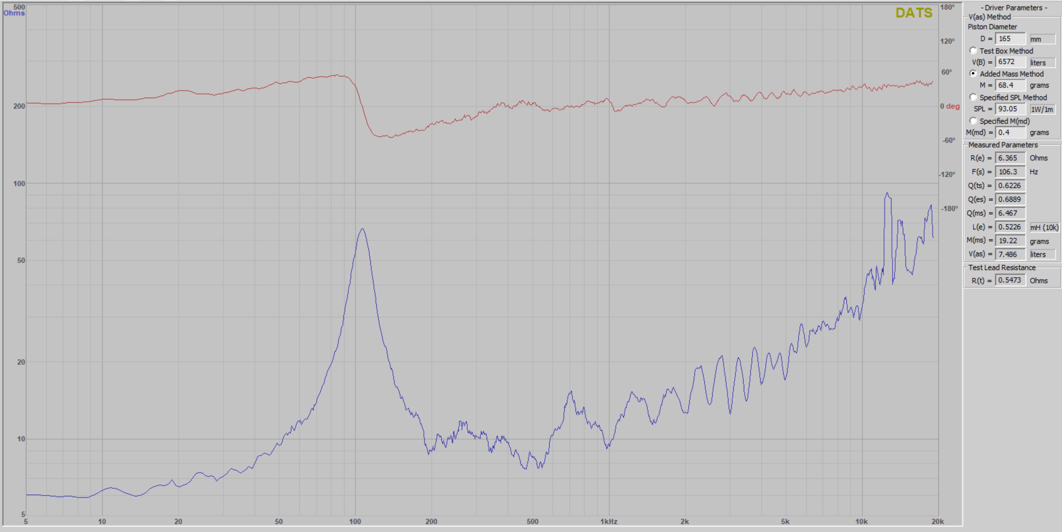

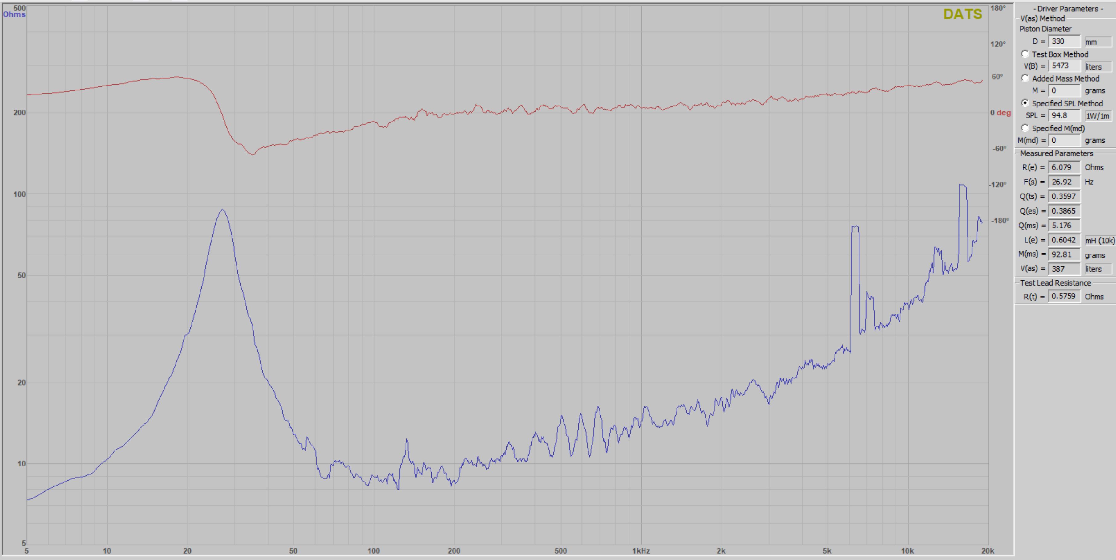

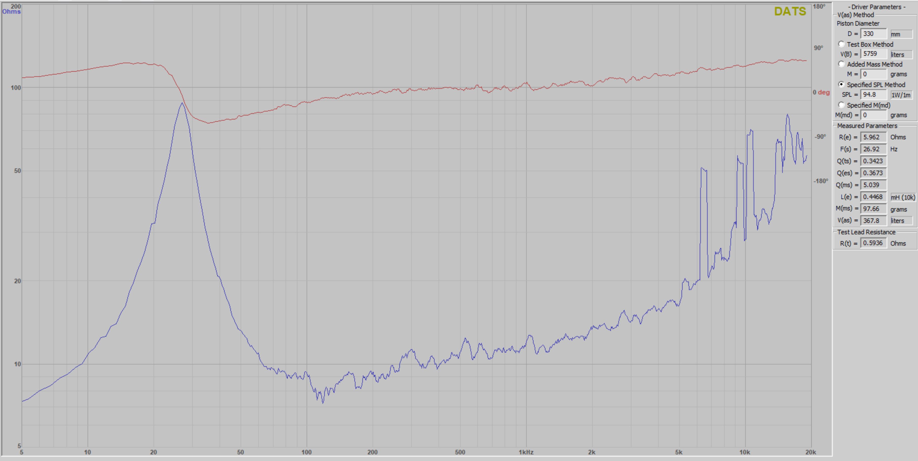

the first measurements after 12 hours burning for each driver. they are still under load for at least another 12 hrs.
the td8m vas cal is with added mass method, I do not trust it much since i used a big tape as weight.
this is just for demonstration, numbers are vary on each try, I ll have more accurate numbers hopefully tomorrow.

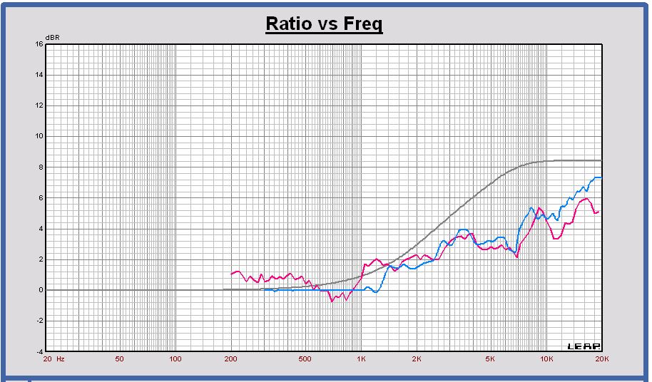

If 2.5kHz is a possible option with the Dayton, I did look to the DI.

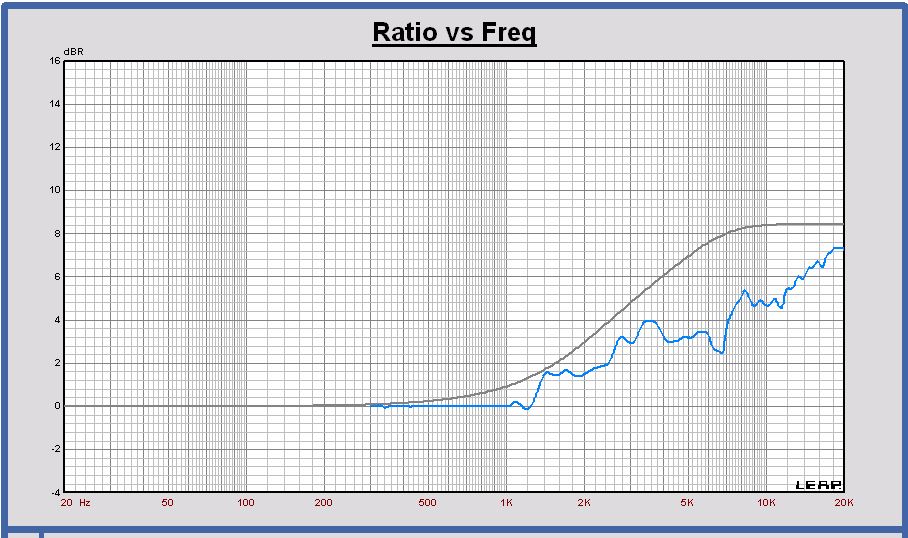

I can only calculate the DI in a single horizontal plane +/-45 degrees, because I have no more measurements. But it gives an idea.
In the first plot, the DI of the AE TD8M in grey and the Dayton PHT1-6 in blue. A XO at 2500Hz is a possibility.
In the second plot I have added the DI of the Monacor TD300-WG300 in red to compare with, also a DI value in a +/-45 deg window. The DI response of the Dayton is almost the same as the WG300.
Remark again that these are DI values in a +/-45 deg horizontal plane. In a single hemisphere (that is incl. vertical response and +/-90 deg window) the DI of the Dayton will be higher than the Monacor waveguide, but I expect it can still be used together with the AE TD8M.
A minus point is the SPL fall off above 10 kHz. At 20 kHz the sensitivity is about 88 dB, but 90 dB up to about 18 kHz.
Looking to the mechanical drawing, the acoustical center of this driver is almost the same as the TD8M.
So much ripple on the impedance curve? It looks the tape is vibrating or the measurement signal is too low.
mm not sure what is going on, this is free air measurement no added weight at this point. I never got all smooth impedance curve but not like this, I usually measure a driver in cabinet tho, this is just the driver sitting on the table, any tips ?
Maybe the table is vibrating, you could try to put a soft rubber between driver and table
probably, I have some rubber mat somewhere, I ll try to have better isolation next time.

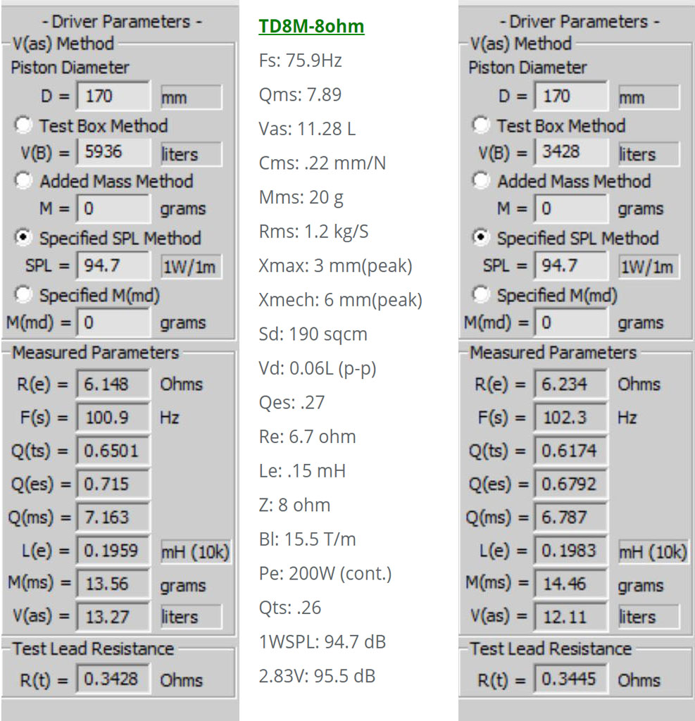

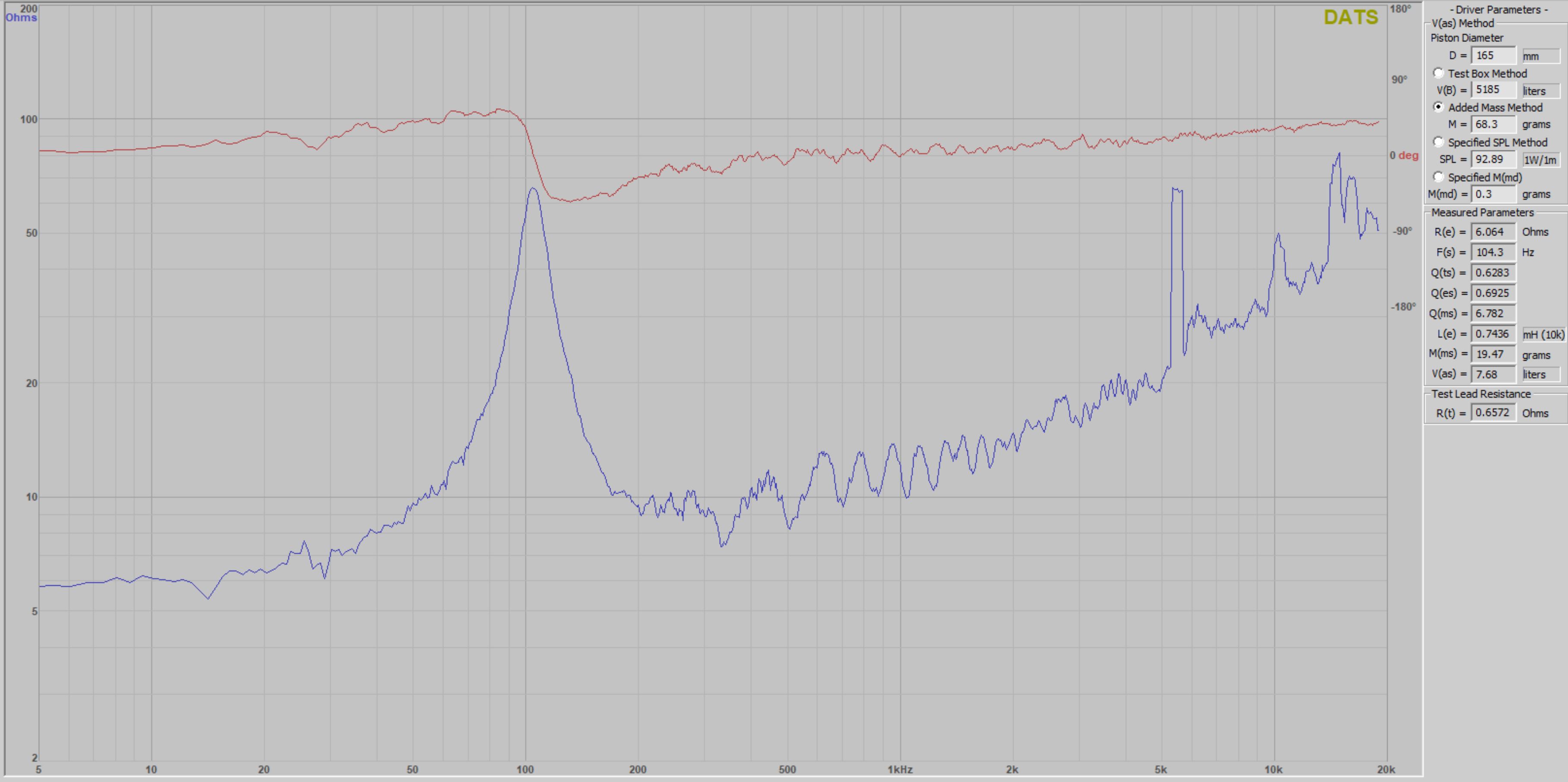

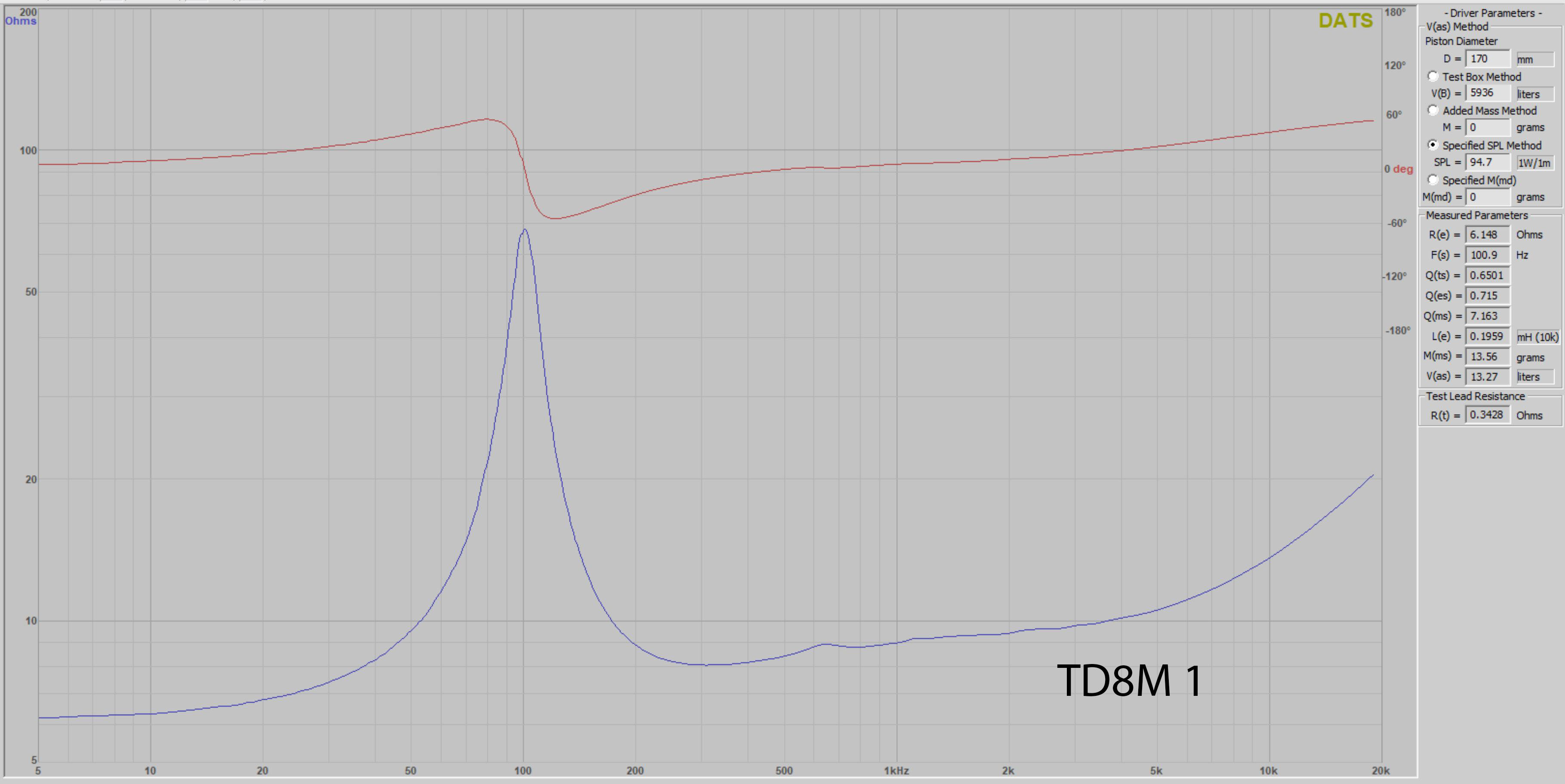

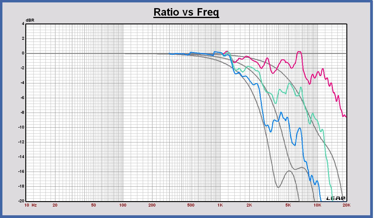

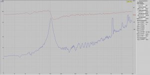

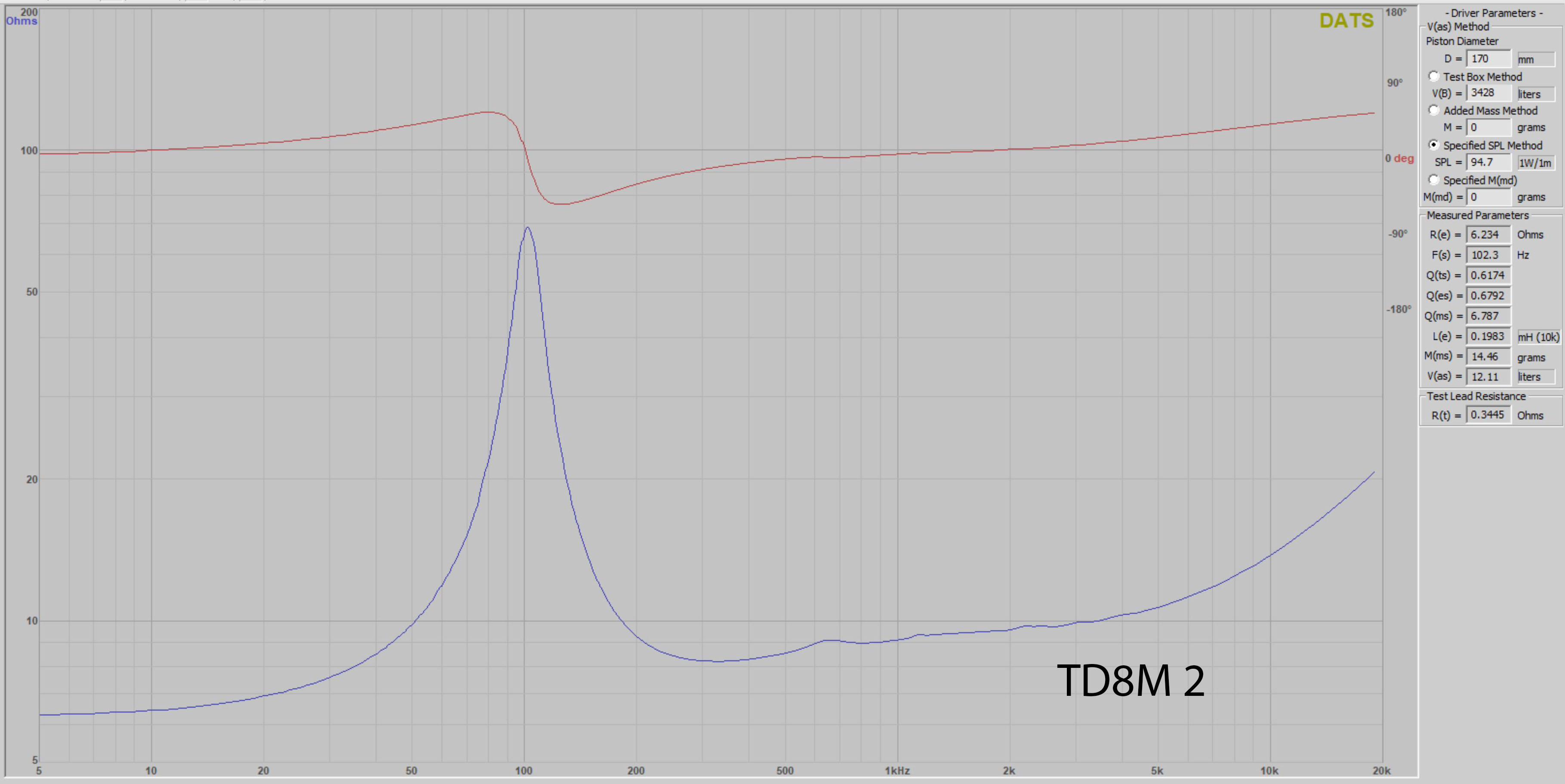

Got new measurements, it's after 22 hours of burning, what do you think ?
in the 3rd pic, the TD8M 1 is on the Left and TD8M 2 is on the right and in the middle is the factory measurements. I still wouldn't count on the VAS and the MMS numbers since I just added that by known SPL method, no "added weight".
Aatto,
Can you create some frd files of the impedance curves? Then I look in Leap also.
Just to know, did you measured a reference resistor, some 1% type for example?
The piston diameter calculated out of the specification is 155 mm, in your sheet it is 170 mm.
I checked the datasheet values of the TD8M in the past. If I use those TSP values, the SPL at 2.83Vrms is correct. So I think your piston diameter of 170 mm is too high. With a 155 mm value, you will get other TSP values.
The specified SPL method can give you a first indication of the parameters, but it isn't the good method, unless you do measure yourself the SPL value.
The SPL value is a result of the TSP parameters of 'your' driver.
The excessive ripple of the first measurement might be due to too low (noise) or too high (clipping) levels of the measurement signals.
Don't measure the drivers sitting on a table or on the floor. They need to "breathe", and you must not block the rear ventilation of the magnet. You need to mount them in free air. My cheap and dirty approach is usually to clamp the drivers between my knees during the measurement. But I am sure there are cleaner ways of doing that
How did you do the burn in? Signal type, voltage levels?
Anyway, I don't like the humps occurring at 600 Hz and at higher frequencies. These features indicate some resonance effects in the driver (suspension or cone breakup). They are deep in the intended pass band.
Or measuring the drivers on IEC baffle, if available. Parameter measurement is a little different. In Leap it is possible to make a 'free air' or 'infinite baffle' transducer model.
