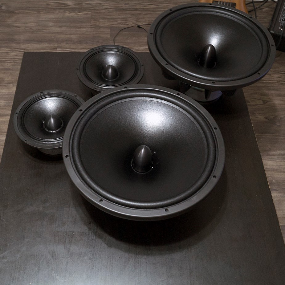

I appreciate that you taking time to reply to the forum, I received the drivers today and man they are heavy 😀 and very good looking !
We will finish this project and it is good to hear we have your support if anybody interested to try this 🙂
attachment.php
the GF is visiting her family so looking forward to start some measuring this weekend 😀

Grats Aatto, they look nice.
