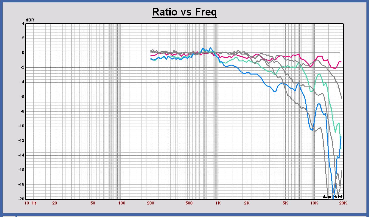

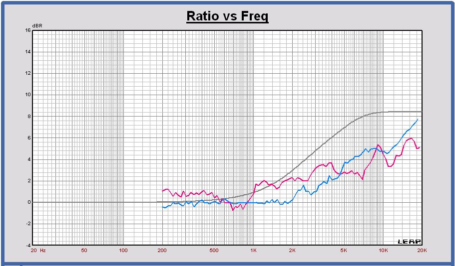

The Wavecor TW030AW11 is the same type of tweeter as the Morel Cat 378. Compared with a Monacor or Visaton waveguide they are less directional around 2 kHz and more directional around 10kHz, because of the waveguide different dimension and shape. I don’t like so much. Directivity is more constant for the Monacor-Visaton.
In the plots DI of AE TD8M (grey) compared with Monacor WG300 (red) and Wavecor TW030AW11 (blue).
Also a SPL off axis 15-30-45 degrees comparison between Monacor WG300 (colors) and Wavecor TW030AW11 (grey).
To combine with AE TD8M, the tweeter should have a waveguide IMO, so Morel ET338 is not so recommended.
Visaton WG220x150 is an option but a more complex behavior with the different horizontal and vertical dispersion. Maybe try out a round waveguide at first?
In general, IMO, for a dome tweeter a Monacor WG300 ar Visaton WG148 alike type is most recommended. For a CD tweeter the directivity will become higher around 2 kHz but it will be more flat up to 10 kHz, the speaker will be more directional.

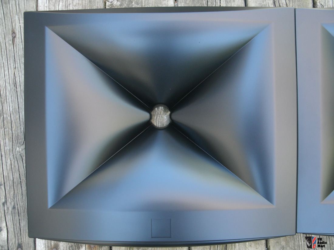

this JBL m2 horn looks very interesting, it would be nice if we could find something like this 😀
