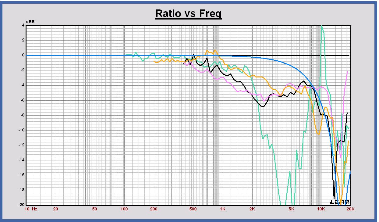

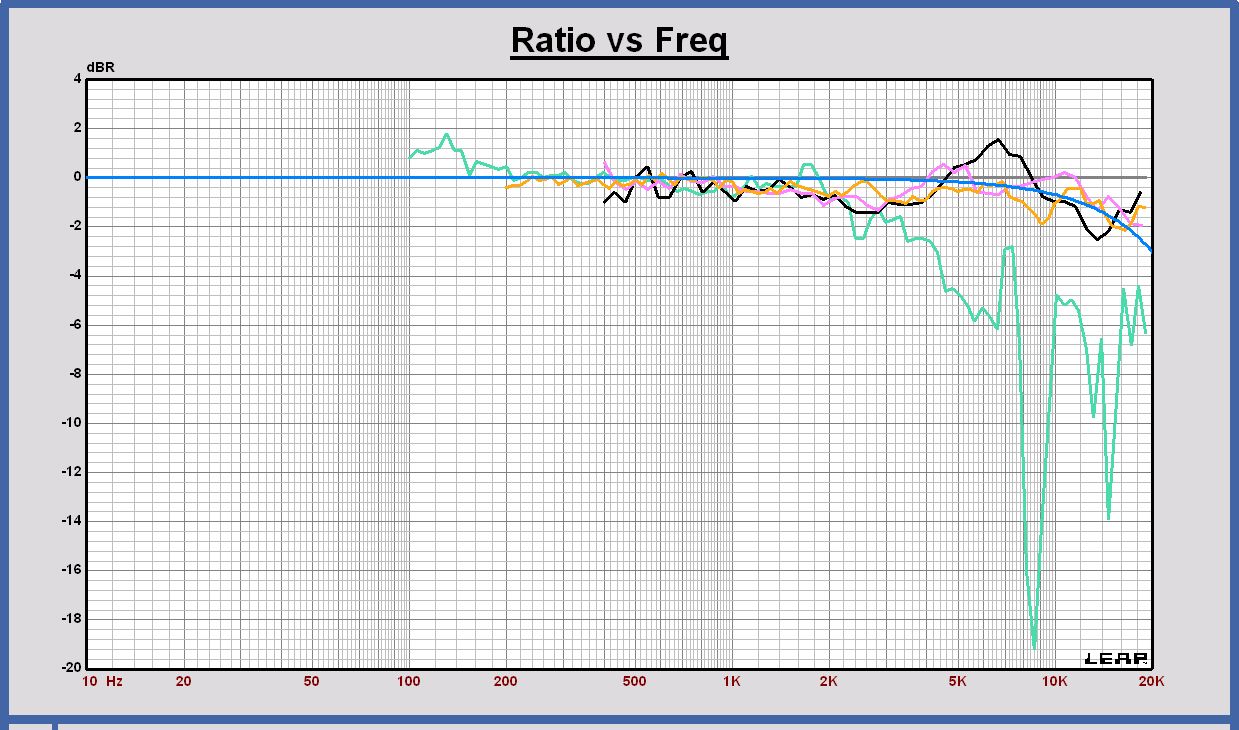

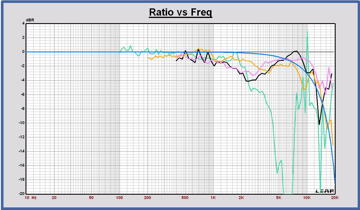

To get an idea how off axis responses will look like, combining midrange AE TD8M with different types of tweeters, I have compared 15, 30 and 45 degrees horizontal off axis responses, normalized to the on axis response.
- AE TD 8M - measurement AE (green color)
- Dome tweeter without waveguide - Satori TW29BN (blue color)
- Dome tweeter with waveguide - Monacor DT300-WG300 (yellow color).
- CD tweeter with horn - 18Sound XT1086 + ND1075 (pink color)
- Beyma TPL-150H – AMT with horn – off axis measurements found by Kaffiman (black color)
Looking to the off axis response of the midrange below 2 kHz and the off axis response of a particular tweeter above 2 kHz, gives an idea how the off axis responses of the total speaker with X-over at 2kHz are expected to look like.
The combi AE TD8M - dome tweeter with waveguide (Monacor) is expected to be most flat off axis, especially if looking at 45 degrees.
AMT without waveguide not considered here, because it can be compared with a dome without waveguide in the single horizontal plane.

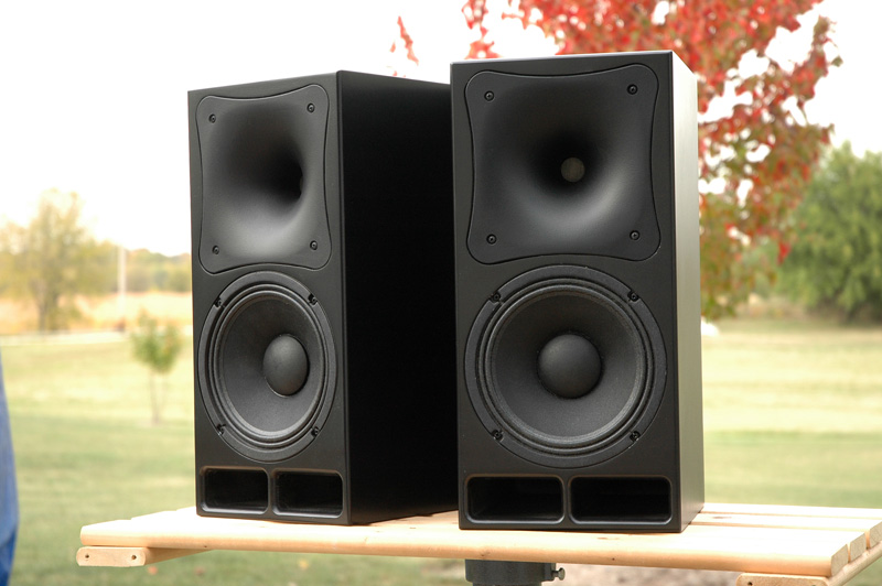

Here's a little study showing the sort of polars one can expect when an 8" woofer is mated to a shallow waveguide ( driven by a small compression driver ).

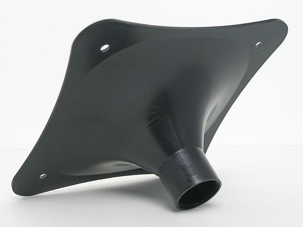

Here are a couple of pics of the actual waveguide ( NLA, I believe ).
And finally to give an idea of frontal size, a shot of the prototype DIYSG product ( which was discontinued some years back ) .

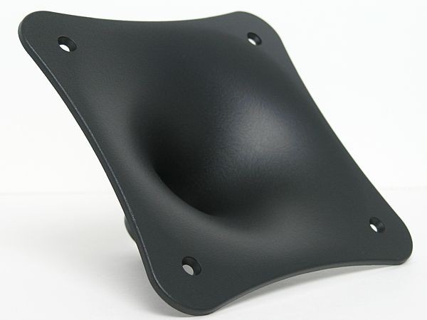

^^ JBL EWave project flare. Do some searching and you'll find the part number (330008?). About $15 as a spare and IIRC Pyle did a clone of them as well.
Option 2; get onto DIYSG and see if they'll be getting more stock of the plastic SEOS 12 or 12.
