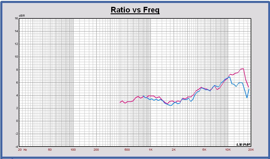

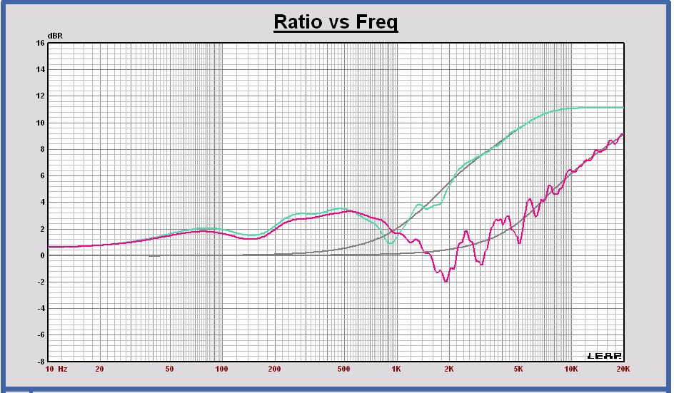

I have done a DI simulation of 2 drivers in the cabinet in the single horizontal plane +/- 90 degree. For the AE TD8M midrange and the Satori TW29BN.
In the first plot you see the DI responses in the cabinet for the AE TD8M (in green) and the Satori TW29BN (in red). I have added also the DI of the drivers mounted on infinite baffle (in grey) to show the cabinet impact on the directivity.
You can see that the bafflestep gives a DI boost below 1 kHz , almost the same for both drivers. The DI dip at 1 kHz of the midrange is caused by the bafflestep boost below. Not so visible in the tweeter DI, I will look at that later.
For the tweeter there is diffraction ripple above 1.5 kHz, because a dome without waveguide has a wide dispersion, which causes diffractions. Not for the AE TD8M above 1.5 kHz because that driver is more directional there.
Suppose a speaker with X-over at 2 kHz is designed with these two drivers, green to red curve at 2 kHz, a DI dip between 2 and 4 kHz can be expected.

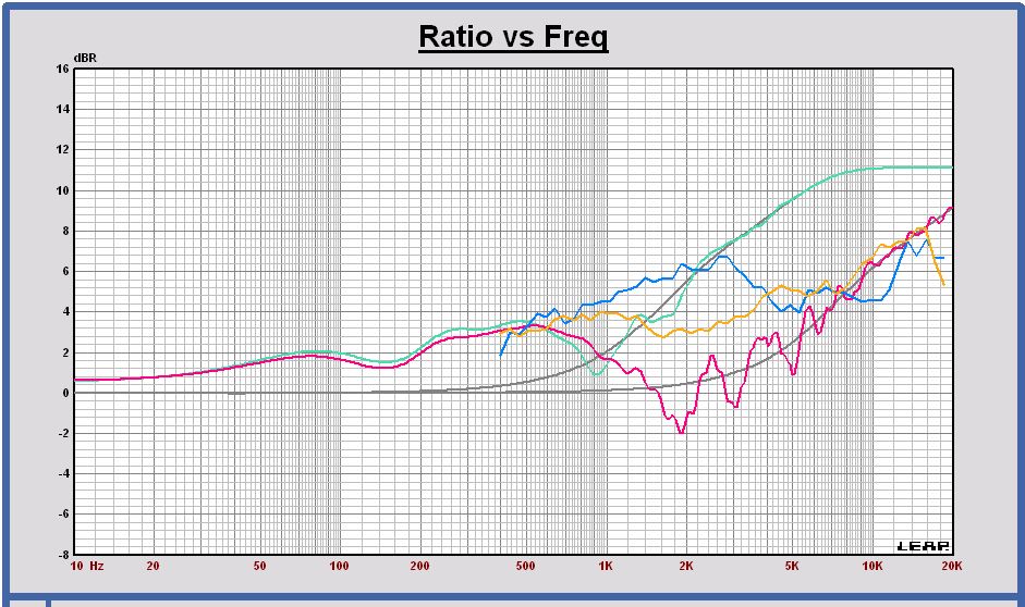

For the dome with waveguide and the CD horn, I have no Leap model and cannot simulate them in the cabinet. So I have used the previous DI responses, that are calculated with 0 – 90 degree off axis measurements. In a cabinet there will probably appear some extra diffraction ripple but less, because these drivers are more directional above 2 kHz.
In the second plot I have added dome tweeter with waveguide (in yellow) and CD tweeter with horn (in blue)
Now, making a design AE TD8M – waveguide tweeter, green to yellow curve at 2 kHz, the DI wil have a flat behavior.
Making a design AE TD8M – CD horn tweeter, green to blue curve at 2 kHz, the DI wil have a boost between 2 and 4 kHz.
Remark that this study is done in the horizontal single plane. In a hemisphere a DI peak can be expected at the crossover frequency. Also another bafflestep behavior to be expected but no spectacular difference. Later we will simulate with final X-over.
Using a ATM tweeter with the AE TD8M, such tweeter is more vertical directive than a dome tweeter without waveguide.
It can be expected that the total DI has also a DI dip between 2 and 4 kHz but not so much as the dome tweeter without waveguide.
My personal preference is the Scanspeak R2904 with Visaton WG148. I also expect acceptable results of the AMT tweeter.
The AMT with horn like the Beyma TPL150-H for example, we have to calculate also the DI of that one. This driver gets very good reviews.

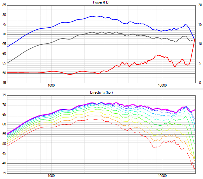

I have tried the WG148 with my Scan 6600, which showed good dispersion. However, it also showed quite some wiggles in the on-axis response, and some more and stronger dips/peaks above 10 kHz. These issues are most likely due to the WG148, as they are also observed with other tweeters in the WG148. While the WG148 may be a useful test dummy to study the suitability of a waveguide for the Tower XL, I don't think it's the best waveguide out there.
I have some R2904 on the way, which I will forward to the guys in the Open Source Waveguide for 3D Printing thread in order to make custom designed waveguide for the R2904. I have high hopes for this!

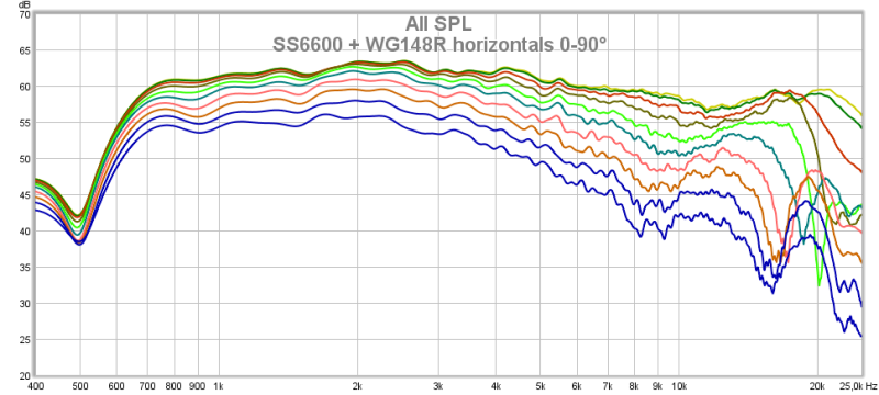

I also measured SS6600 and 7100 in WG148R. The same conditions and baffle that I used for R2904/7000 so the results are directly comparable, except SPL. It has been quite some time ago, but I still see it usable, when CNC is not available.
SS6600 shows some air leak => dip around 500Hz.
Please see here (and the follow up posts) how to fix the air leak.
