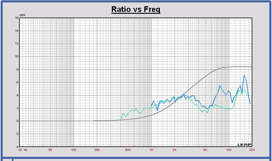

Some information that can be used for the choice CD tweeter versus dome tweeter (probably in a waveguide), I did some DI calculations.
I have calculated the single half plane DI from 0 to 90 degrees horizontal of following drivers:
- CD tweeter 18Sound XT1086 + ND1075 (green curve)
- CD tweeter Selenium D220Ti (blue curve)
- Dome tweeter Monacor TD300 in WG300 (red curve)
- AE TD8M (grey curve) Leap model
Used off axis measurements of Kimmo Saunisto for the Monacor and the 18Sound Wave guides & horns and the Selenium from a list on the DIY forum, Great Waveguide List.
I did choose the Monacor, because I already have the 0 -90 degrees measurements of this driver.
I cannot add the DI of the Morel Cat378, because I don’t have all the 0 - 90 degrees off axis responses, and the DI value will be lower then.
Comparing the DI results, it changed my mind about CD tweeters. I thought they were much more directive than a dome tweeter in a waveguide.
I think a combi AE TD8M with a CD tweeter is feasible based on these (preliminary) DI calculations.
Between 2 and 4 kHz, the transition between the AE TD8M to the tweeter will be more smooth with the waveguide.
For the CD tweeter the mean DI is more flat above 2 kHz than the waveguide.
Remark these are infinite baffle values and DI will change in an enclosure, but the same for all, to be expected, not proven yet. Probably only below 1 kHz for the wide cabinet of this project. Already mentioned this before.
Remark also that I assume that all the drivers are measured on a large baffle and not in an enclosure.
This is draft information, but maybe useful for further discussion and extra investigation.
Edit: I don't know yet which horn is used for the Selenium in the off axis measurement I used.

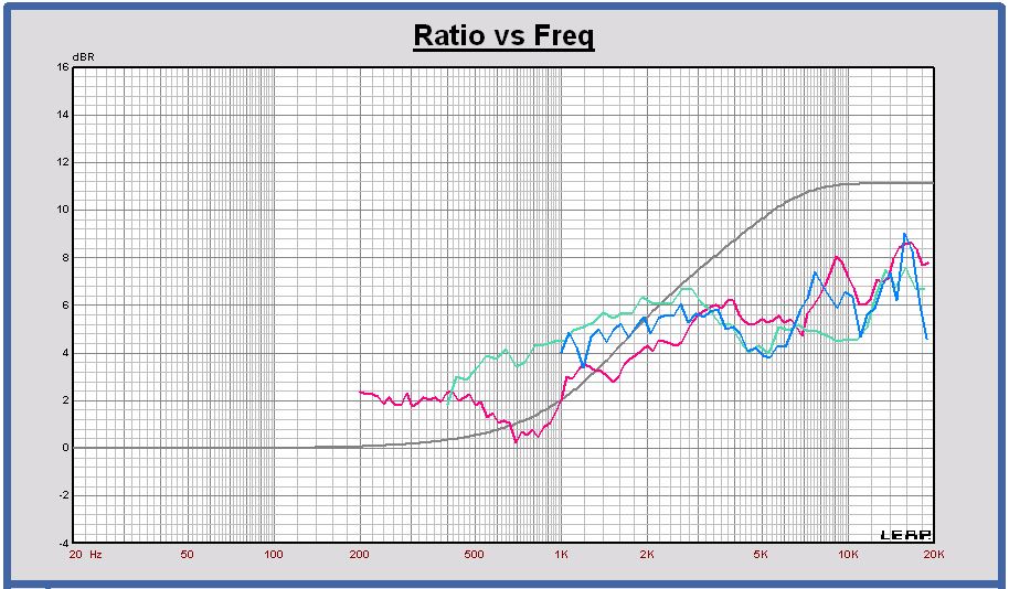

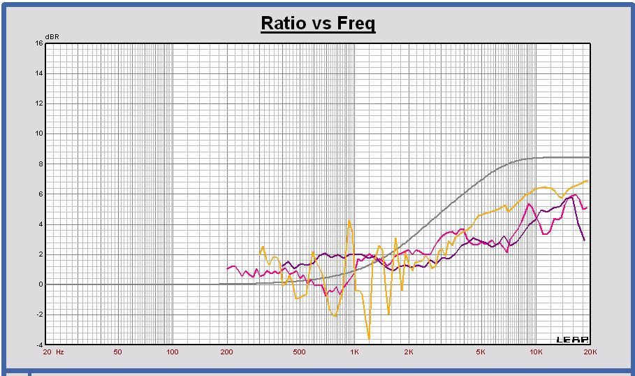

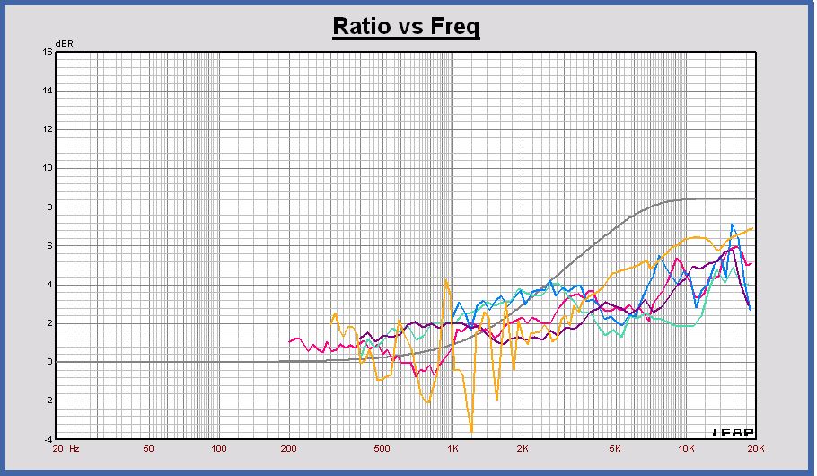

To compare more CD tweeters and waveguide tweeters with each other and the match with the TD8M, I calculated the single half plane DI from 0 to 45 degrees horizontal, because the 0 - 45 degree measurements are available for more drivers.
- AE TD 8M Leap model (grey curve)
- CD tweeter Selenium D220Di - Dayton H10RW (blue curve)
- Dome tweeter R2904 – waveguide Visaton WG148 (violet curve) – measurement Pida in enclosure.
- Dome tweeter Morel Cat378 (yellow curve)
In the 3 plots, AE TD8M vs. CD tweeters, AE TD8M vs. dome waveguide tweeters and AE TD8M versus both.
IMO, some first conclusions can be made, suppose we will make a crossover around 2 kHz.
- The CD tweeters are more directive below 4 kHz, but they show a are more flat DI up to higher frequencies.
- The dome tweeters with waveguide are less directive below 4 kHz, but they show an increasing DI behavior up to high frequencies
- The Morel Cat378 has a strong leading DI response up to 10 kHz. I think it is not so good, there will be probably some lack of high frequency definition. I think it is caused by the small horn with its typical shape.
- Looking to these comparing results can explain why CD tweeters are playing with more upper frequency dynamics. They have another power distribution between 2 and 10 kHz, more constant directivity. I can understand why some people prefer this sound more than the one of a dome tweeter.
- The acoustical center of a horn tweeter will be positioned more backwards. Maybe a problem for a passive filter. A low X-over crossing will be more recommended probably.
- I think a speaker with smaller midrange with dome tweeter will sound more uniform in a room. Less dependent of the listening place and more filling the room with music power. Just because the DI mean value can be designed lower. The Monkey Coffin with a 3 inch midrange and dome tweeter will sound different in a room than a Tower XL with 8 inch midrange and CD tweeter for example. It will be a personal choice.
It can be expected that an 8 inch midrange with CD tweeter versus a dome tweeter with waveguide will be not so much different w.r.t. room power, but they will sound different because of other DI at high frequencies.
