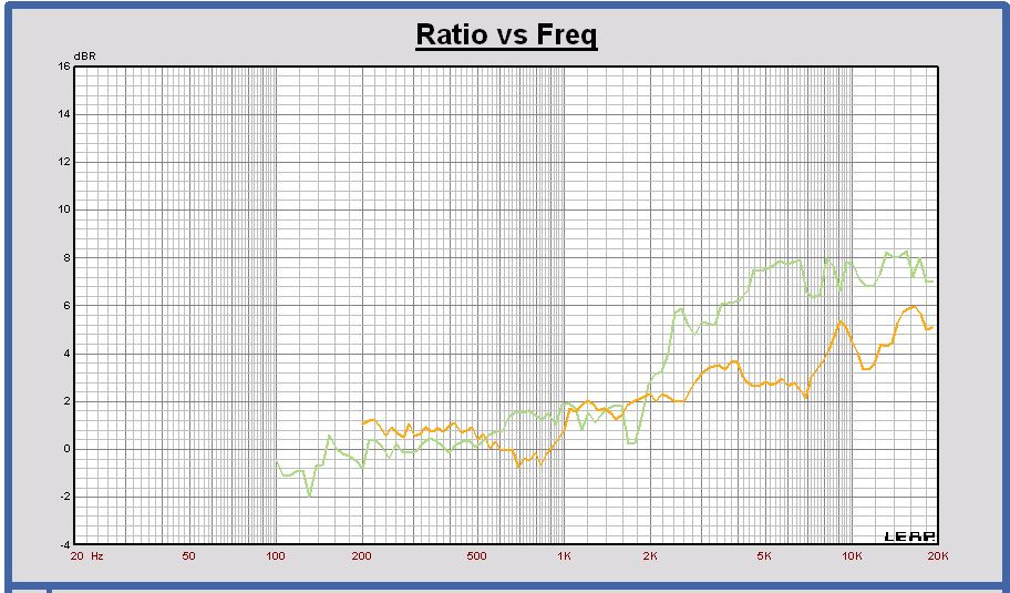

As an information, in attach the DI in the horizontal plane on infinite baffle, calculated with off axis responses of the datasheet, of AE TD8M, Morel Cat378 (blue), Bliesma T34B-4 (red) and Satori TW29BN (yellow).
You can see the impact of the waveguide of the Morel.
With these drivers the DI can be kept flat up to about 3kHz.
With a CD horn tweeter the DI will be flat up to higher frequencies, but it can be expected that the DI of a CD horn tweeter will be higher. Look to the DI of a Monacor DT300 with waveguide WG300 (brown) together with the AE TD8M (green) in the other plot. The DI with the WG300 is higher than with the Morel waveguide. Maybe already too high for the best combi with the TD8M.
If somebody has some off axis measurements of CD tweeters, tweeters with waveguide, they are welcome to calculate the DI of them and compare with each other and with midranges.
I have no experience with CD tweeters, but looking to the horn size of most CD tweeters, it looks they are more directive than a classical cone midrange, more intended to be used in combination with a horn loaded midrange too. We have to calculate that.

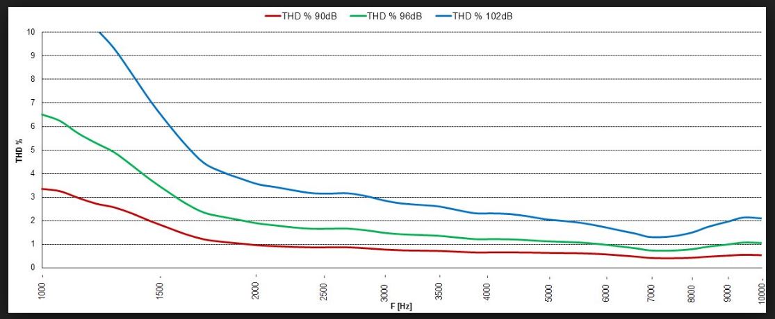

In attach also the THD of the Morel Cat 378 at different voltage levels.
Edit: the DI calculations are draft. Sometimes the measurement conditons are not exactly known.
Placed in a little baffle for example, the DI already will be different.

...a Bliesma T34 with waveguide. Do you know where to find more information about that?
Despite my limited experience with waveguides I'd expect the Bliesma is not the best choice for a waveguide. The dome diameter is rather large. Pathlength differences may therefore cause nasty dips and peaks in a waveguide at > 10 kHz or so. Why would you want to put the Bliesma in a waveguide anyway?
I think that with a waveguide like the Monacor WG300, there is a wider range of equal DI of tweeter and midrange between 1 and 2kHz.
I had better not posted that plot of the Monacor WG300. There is a bump between 1 and 2 kHz and I think it is caused by a too small measurement baffle, a kind of bafflestep what you see there.
So my expectation is that with a correct measurement of a tweeter with such waveguide the DI will be the same for tweeter and midrange between 1 and 2 kHz.

The baffle size of the DT300-WG300 measurement was 24 x 35 cm. So, forget the DI calculation of the WG300 below 2kHz in my earlier post.
I found that measurement here: www.audioexcite.com >> Monacor DT-300 + WG-300.

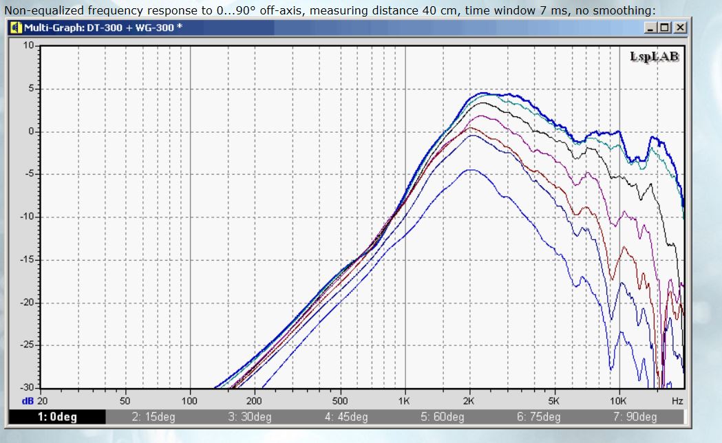

I did find better measurements of the Monacor DT300 with WG300 waveguide on this site:
Wave guides & horns.
Now I have better results for the DT300-WG300 DI also.
The off axis measurements of the Audioexite website are different below 2 kHz, probably affected by the small measurement baffle, in a way there is a mix of waveguide and baffle impact.

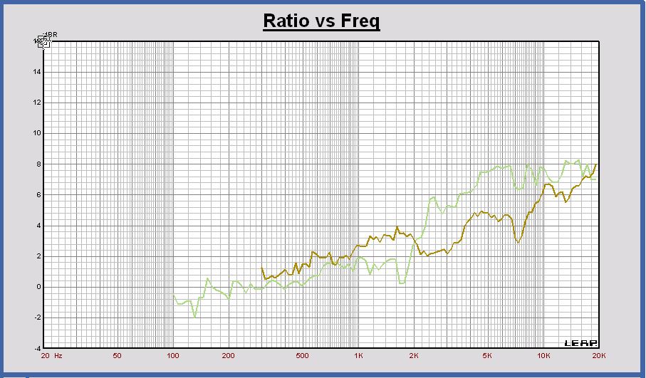

To compare in the best way with the AE TD8M I have calculated the DI with the 15, 30 and 45 degrees off axis responses also for the DT300-WG300. I have no more data of the AE TD8M.
Looking to the comparing results, the DI is more matching now for AE TD8M (green) and the DT300-WG300 (yellow).

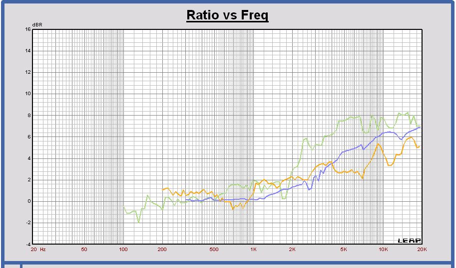

To compare also with the Morel Cat378, I have added the DI in a second plot in blue color.
Remark that I only used the 30 and 45 degrees off axis SPL for the Morel calculation, I don’t have more information. It has some impact on the DI absolute level.
The Monacor DT300 cannot be used, it has too low sensitivity above 10 kHz.
Juhazi, I agree, we have to find a waveguide with about the same dimensions as the midrange for the best results.
On the Kimmo Saunisto website, there are also other waveguide measurements, very interesting stuff. I shall calculate also the DI of some other waveguides with larger horn, to compare DI values, and see how they match with an 8 inch midrange.
As a first conclusion the Morel can be used IMO, but let’s look first to tweeters with a larger waveguide some like the Monacor WG300.

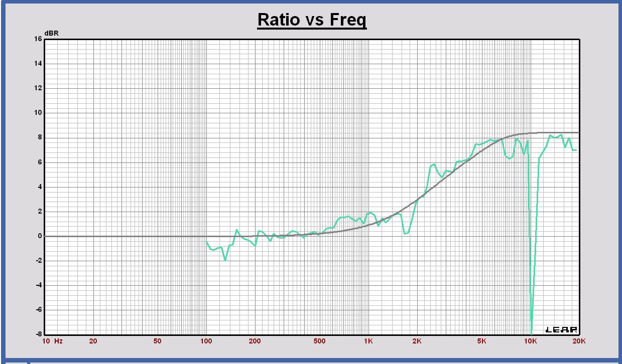

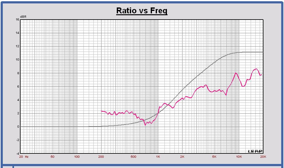

Anyway, I did some further study and looked to my AE TD8M Leap model and I did found that it matches very well with the AE off axis measurements.
In the plot the normalized off axis responses of the AE measurement (colors) versus the Leap model (grey) .
Also the DI in a horizontal plane +/- 45 degrees with the Leap model (grey) and the AE measurement (green) fits well.
So for the first speaker simulations the AE TD8M Leap model can be used.

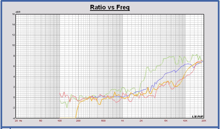

I compared now the DI of the Monacor DT300-WG300 (red) with the AE TD8M Leap model (grey) in a +/- 90 degrees horizontal plane also, using the Kimmo Saunisto measurements.
You can see that the TD8M already becomes more directive above 1.5kHz. With a X-over crossing around 1800 Hz, some rather good result can be obtained with such Monacor WG300 alike waveguide.

Remark that these are DI values on infinite baffle and not in the enclosure. The cabinet will change the mean DI value below about 1.5 kHz, but expected to be the same change for both drivers.
Also these results are based on measurements, without knowing the exact measurement conditions. We have to measure ourselves also later on, at least in the cabinet.
