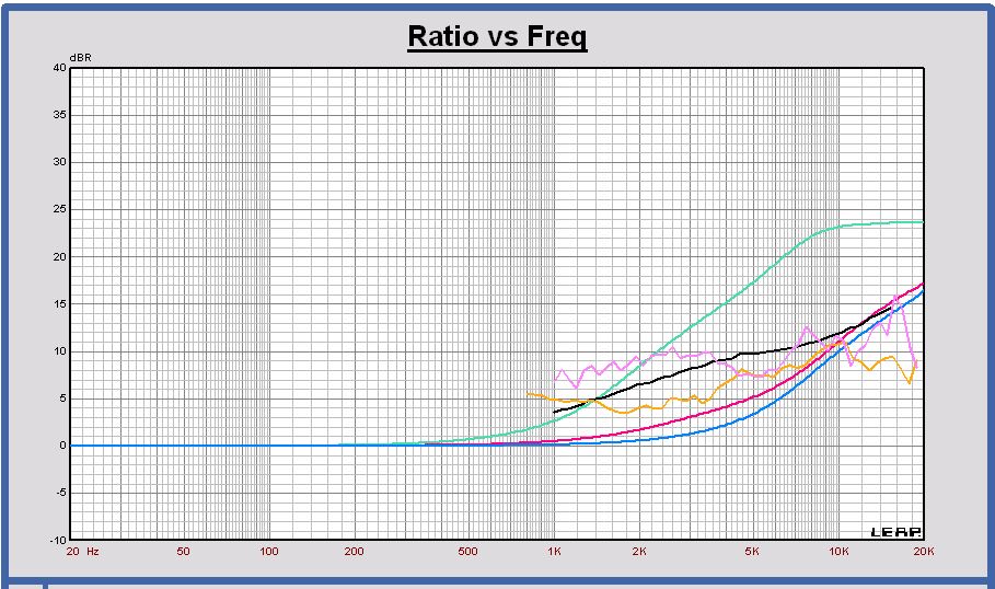

View attachment 713568I did find that Leap can also make a driver model with rectangular cone. To be used for ribbon and AMT.
So, I made single hemisphere directivity calculations, meaning horizontal and vertical responses included.
In the plot the calculated DI for the AE TD8M and some different tweeter types.
- AE TD 8M Leap model (green color)
- Dome tweeter without waveguide Satori TW29BN (blue color)
- Dome tweeter with waveguide - Scanspeak R6600 – Visaton WG148 – off axis measurement Pida in enclosure (yellow color).
- CD tweeter with horn 18Sound XT1086 + ND1075 (pink color)
- AMT without waveguide - Leap model – chosen 1inch wide and 3 inch high for this calculation (red color)
- AMT with horn - Beyma TPL-150H - DI curve datasheet (black color) – assumption made, that it is also a single hemisphere curve.
Update of conclusions for a X-over at about 2 kHz with 8 inch midrange AE TD8M:
- Dome and AMT without waveguide: DI dip above 2 kHz, less for AMT, speaker will be less directive between 2 and 4 kHz.
- Dome with waveguide: little DI dip to be expected above 2 kHz. Remark that these off axis measurements are done in enclosure, so DI at 2 kHz and lower will be less.
- CD tweeter with horn, good match, more flat DI above 2 kHz, more directive between 2 and 4 kHz than dome and AMT.
- AMT with horn, Beyma TPL-150H, better match at 2 kHz than dome with waveguide, but more directive above 2 kHz.
