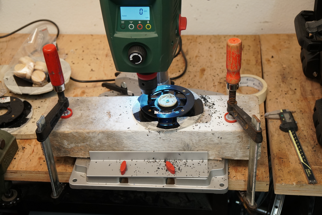

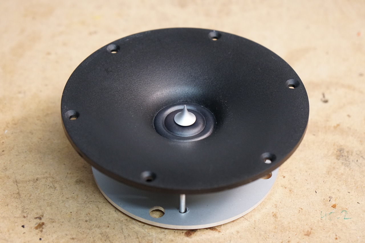

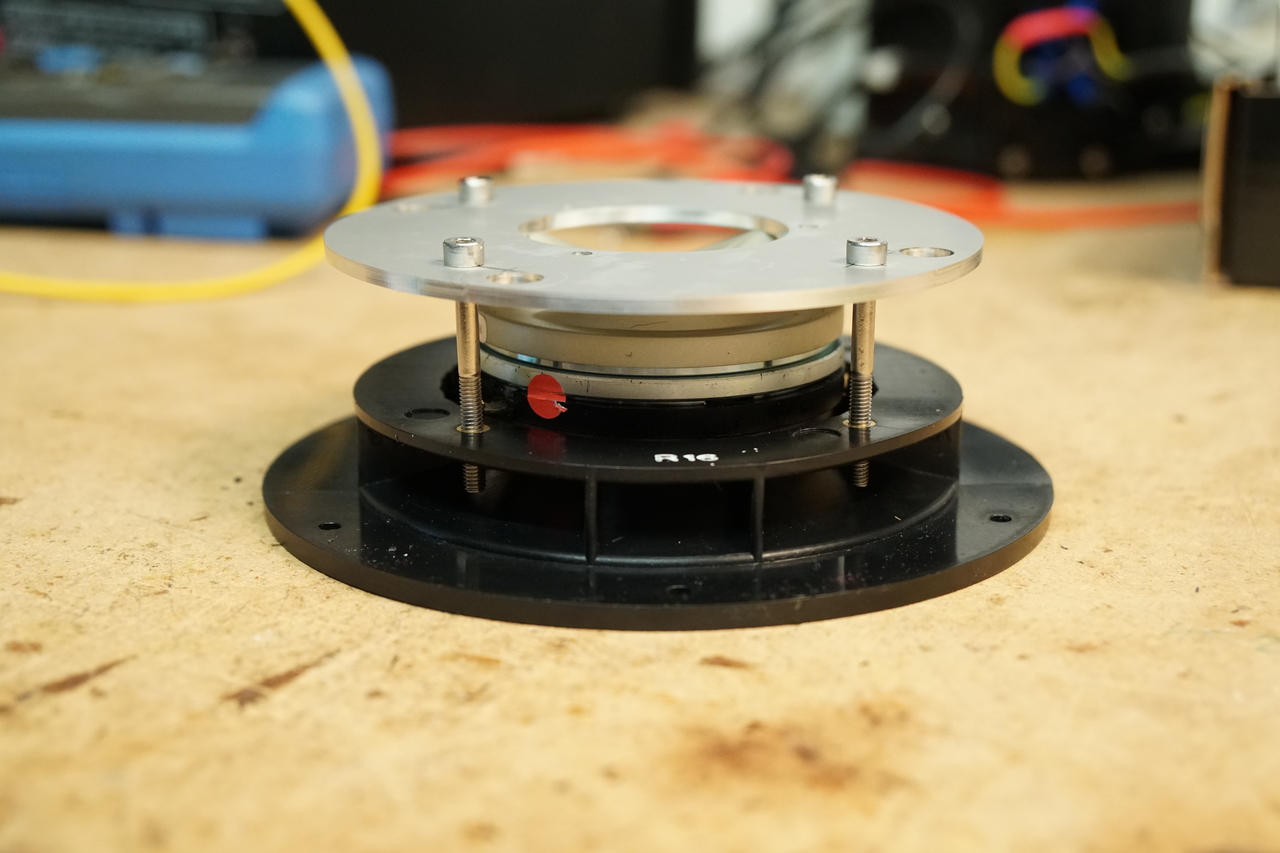

Take a look at the Heissmann link I posted earlier, as these seem to be "easy" tweeter + waveguide combinations. I also mated a WG300 to the "large" ScanSpeaks (6600, R2904, and similar) using a simple adapter plate which is easy to make. This weekend I also managed to modify a WG148 to fit on the "large" Scans. This involved some MacGyver improvisation, but the result seems to be good (see attached photos). It would be best to have some measured dispersion data from your mid drivers so that we can try to find a matching tweeter.
O nice, I like 2904 ! this shouldn't be hard, you removed the WG backplate, probably to make the WG throat to fit 2904, and removed the 2904 front face and then sandwiched the tweeter between a backplate and the WG, correct ? do you have more pics of the process ?
Well, almost... You need to modify the WG148 to fit the R2904 (or 6600 etc.).

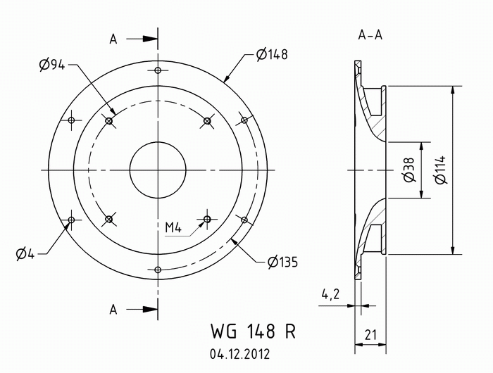

First, take a look at an the unmodified WG148 here.
The thing is that even if you take off the face plate from the R2904 (or 6600 etc.), the throat of the waveguide still needs to "dive" in to the tweeter assembly. This means that the flange of the WG cannot be flat. You need to machine the waveguide in a similar way as described by Pida here (take a look at the attachment).
However, it's a bit more complicated with the R2904 or the 6600 etc. These tweeters require a slightly larger throat diameter of 39 or 39.5 mm instead of the original 38 mm of the WG148. To this end, I machined the WG148 by removing some material from its back flange until I got about 39.2 mm diameter. Then I cut a 3mm deep ring around the throat, similar as shown in Pidas drawing. Note that this means I actually cut away all the material of the flange back plate of the WG148 as shown on the first photo of my previous post. I only left the outer ring with the mounting holes/threads. The trick is to leave the right amount of material at the throat so that this part "dives" into the tweeter and seals the WG148 to the tweeter. I attached another photo showing the backside of the throat in more detail.

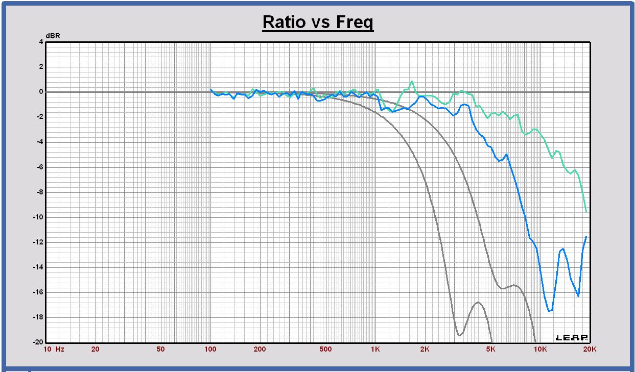

If you compare 30 and 60 deg normalized off axis response of this Seas (color) with the AE TD8M (grey), you can see that is not directional enough with its little waveguide.

Uhm, yes! Of course I messed up the first attempt of machining the WG148. There are a few mm of the throat missing, but it should be easy to reconstruct that if necessary. Or just buy another one, they are cheap.
O nice, I thought about buying one and cut it but if you already have one that is awesome, can you trace the throat profile fromt it ? like just put it on a paper and trace it as close as you can ? I can do the rest in soldworks 😀
I also got this from visaton and I can trace it from here, do you think the throat shape is close enough to real thing ? (please see the attachment)
Not sure how accurate the Visaton drawing is. What would you do after tracing the profile? Send it to a 3D printer?
yeah that is what I was thinking, tracing an 8" WG from WG148 is not difficult and I can make it fit any tweeter face and shape we want with fitting throat size, but the key here is the accuracy, I m not sure how accurate is that drawing and unless we do it with a machine it will not be exact but maybe good enough 😉.
