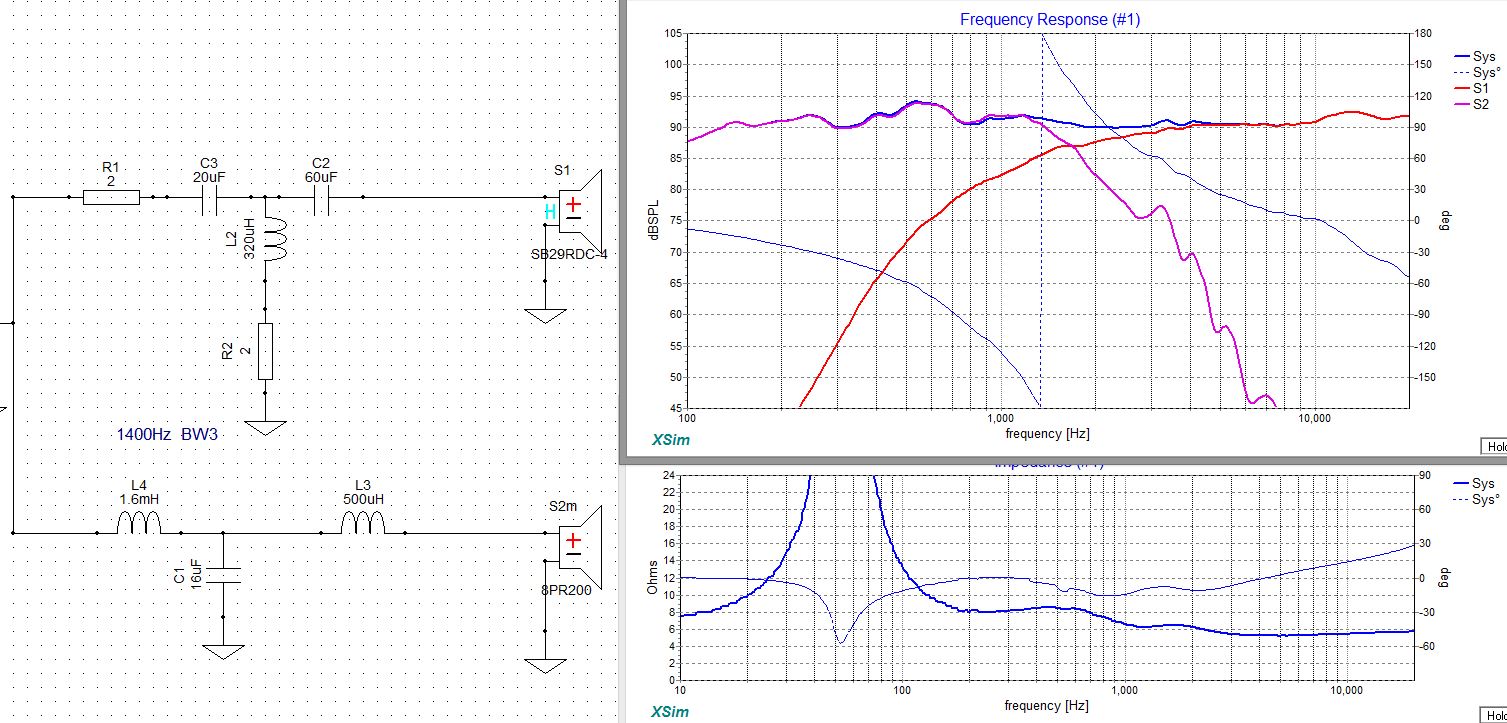

I wouldn't use the SB29RDC crossed that low even though from the freq. response and fs perspective it can handle it. The reason I wouldn't is that it has a massive spike in higher order harmonic distortion around 1.1kHz that may lead to a very fatiguing sound. See the distortion measurements at the bottom of this page.
Zmin ~ 6ohms, SPL ~90 db

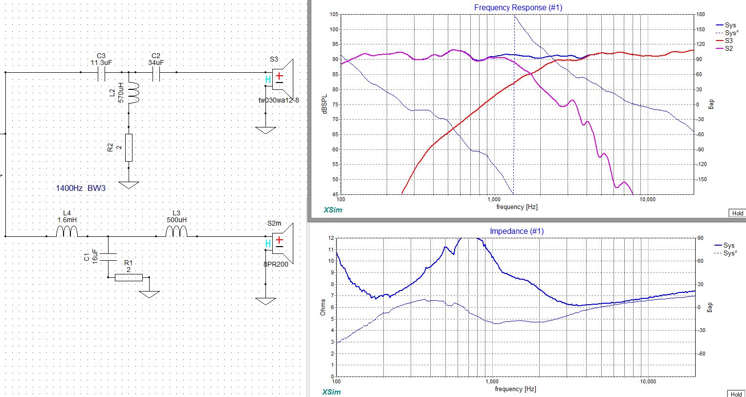

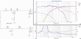

Attached quick sims using just datasheet plots of the 8" Faital 8PR200 with the SB29RDC_4 dome tweeter, and with the Wavecor TW30WA12-8 waveguide dome to provide average SPL and Impedance for discussion.
Wavecor TW30WA12-8 waveguide dome seems worth further consideration.

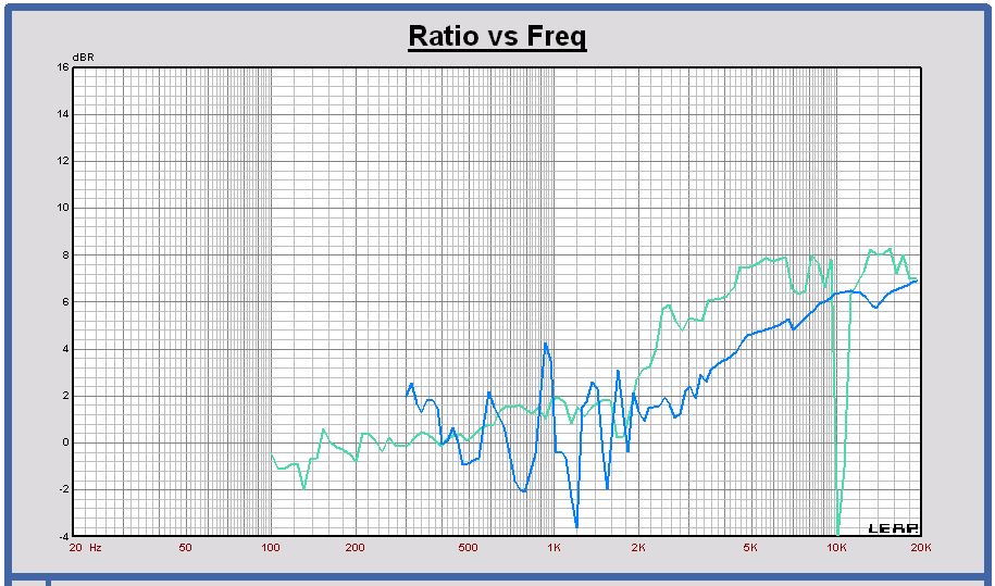

The Morel CAT 378 looks interesting. Out of the off axis responses I have calculated the DI and compared with the DI of the AE TD8M. Morel in blue, TD8M in green.
Measurements of the Morel below 2kHz are very poor with much ripple, we have to look to mean values.
The DI is about the same around 2 KHz. A crossing at 1800 Hz can be ok to make DI flat, if the tweeter excursion becomes not too high, we have to look at it later.
These are DI results on infinite baffle. Placing the drivers in the cabinet will change the DI.
Above 2 kHz there will appear probably some ripple on the tweeter DI because of diffraction, but the mean value should stay the same.
Below 1 kHz the DI will increase due to the bafflestep. It will be almost the same increase for both drivers.
The total combined DI will not be flat anymore with an expected DI dip around 1 – 2 kHz. That cannot be solved by a tweeter waveguide, only by making the bafflestep behavior more smooth, for example by making a slow curved baffle in horizontal direction. That isn’t the intention for this project.
The DI with drivers in the cabinet can be made more flat maybe, by choosing a higher crossing, around 2.2 kHz.
These are only some expectations based on preliminary off axis curves. The final cabinet measurements will give a better view on this.
Measuring the drivers before on IEC baffle would be very informative also, like mentioned already before.
