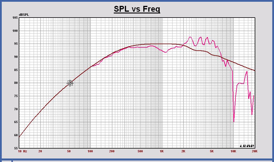

- In attach two plots of the AE TD8M and the Faital 8PR200. There are two SPL curves for each, one based on TSP parameters only and the SPL on infinite baffle. For the TD8M I had to assume some value for Le.
You can see that the Faital has a breakup starting around 500Hz. Indeed, this looks a little disturbing, because it appears in the passband.
The TD 8M is more smooth in the passband, but has a dip around 1kHz, but it is less than with the TD6M
- You are right, the datasheet curves of AE are very smoothed. And both driver SPL's on a 10 dB/div scale in the datasheet. It masks the SPL ripple.
Maybe we have to wait for the TD8M results in the prototype.

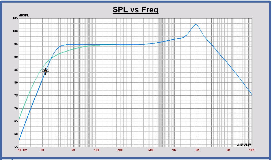

Here are two cabinet proposals for the Tower XL AE and Tower XL Faital.
I had to adapt the depth of the AE version to 62 cm, I made a mistake in previous calculations.
Port height adapted from 5 to 6 cm in both concepts to realize B4 in the Faital version with a port that is not too short. A larger port area is welcome for the AE woofer too.
For the Faitals there are three optional port lengths: extended, B4 and a kind of quasi B4 with a port length between. For a real B4, the port length has to be 13 cm, I am not sure if that is feasible. I think the quasi B4 can be adjusted with the X-over to become a real B4 SPL response, with a little sensitivity loss but with a reasonable port length.

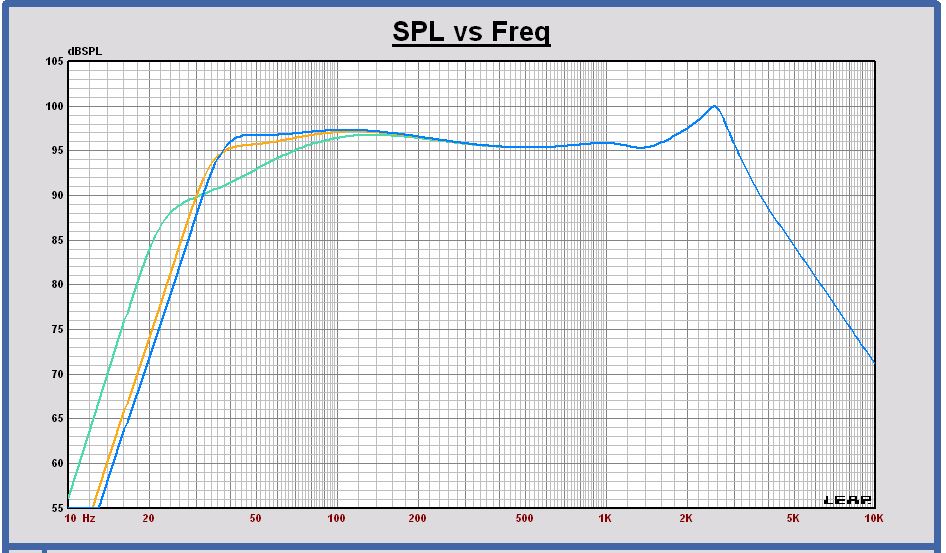

Tower XL AE
- Cabinet W x H x D = 47 x 112 x 62 cm
- Woofer AE TD 15X, Midrange AE TD 8M, Tweeter tbd
- 247 L bruto and 217 L netto for the woofer; 20 L bruto for the midrange, 5 L for the woofer and 5 L for the bracing subtracted
- Internal cabinet netto volume for midrange is 15 L
- Port length long: FB = 20 Hz, F3 = 35 Hz, F6 = 24 Hz, F10 = 19 Hz
- Port length short: FB = 28 Hz, F3 = 28 Hz, F6 = 25 Hz, F10 = 22 Hz
- Data for BR simulation: netto volume = 43.2 cm x 57.1 cm x 88 cm or 217 L; port long = 57.9 cm; port short = 24.0 cm; port area = 236 cm2

SPL plots in attach for AE and Faital. Extended in green, B4 in blue and quasi B4 in yellow.

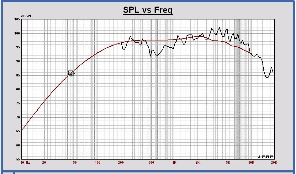

I did a quick simulation of the Supravox 165GMF. SPL datasheet versus SPL calculated with TSP. You see the dip below 1 kHz.
I actually meant the 165-2000, not 165GMF. I just looked it up at Supravox and saw the 165-2000 also has the dip at 1 kHz in the anechoic (?) measurement. The 1/3 octave SPL chart does not show the dip. I wonder if the dip is due to a measurement artifact at Supravox. However, I also realised the 165-2000 is rated at 4 Ohm. Not sure if padding would work out to a 8 Ohm rating and still enough SPL.

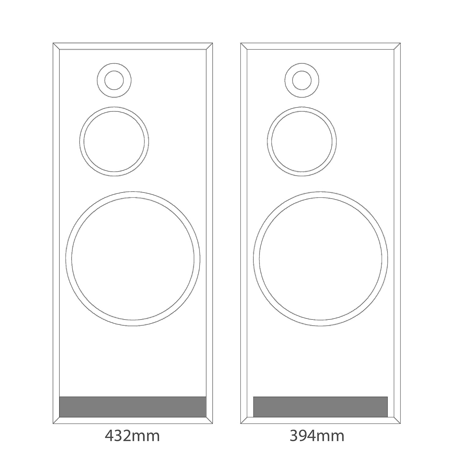

Paul I have some questions about the drawings.
-in your drawing there s a 394x60mm port cutout at the bottom of the baffle, it might be a little difficult to cut that, what if we cut 60mm from bottom of the baffle (make the baffle 60mm shorter) ? so the port would be 432x19mm, this make it easier to build since this is just a straight cut compare to cutting a rectangular inside of the baffle. how much does it effect the port length ?
please see the attached pic.
-the front baffle would be 25mm (1inch) thick instead of 30mm here in US, it does not make much different but we can make the dept 5mm shorter if it is critical.
-how important is the 20mm radius ? :D just asking to see if I can ditch it since I m not a big fan of round edges :D i know this is for baffle diffraction, just asking.

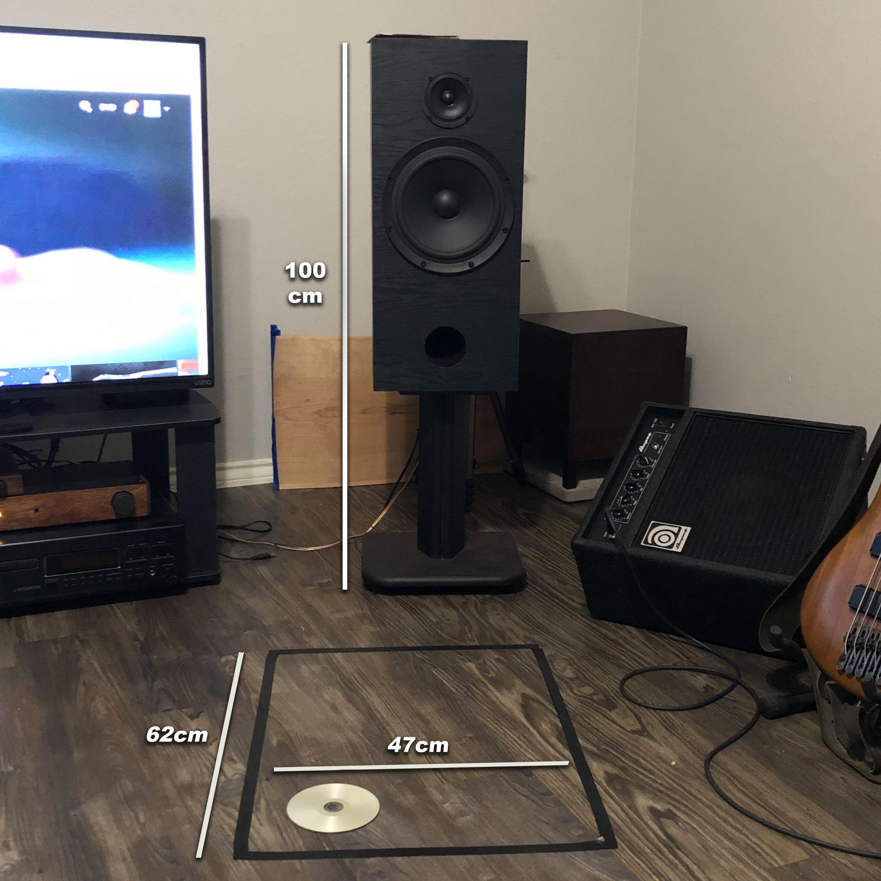

EDIT: BTW I had the foot print of XL marked on my floor just to see how big it is compare to my current setup. my current speaker is 27cm wide and 1 meter high (w stand), so it would be 20-30cm taller than my current setup (including the stand) :eek:, it is bigger than a mini fridge alright :D

Perhaps not hugely important, all things considered, but if you make the drivers flush on a 25mm baffle, the thickness left for the screws will be ca 13mm for the woofer (or maybe less for the TD15x?).
Port size is not that critical IMO, the design should be reasonably flexible and have little impact on the end result. It depends on your wants and needs.
Aatto:
- if you make the port 5,5 cm high instead of 6 cm, the port area will be the same. Then all FB and port length values doesn’t change in my simulation.
The port area will be then (43.2 x 5.5) cm2 = 238 cm2. The cabinet volume will increase a little with 1,2 L, no problem at all.
- Making the front baffle 25 mm is not enough for TD15X, like Kaffimann is mentioning also. There is only 9.25 mm left for the screws with this driver, dimensions of TD15 in attach. The driver weigth is also 27 lbs.
- The 20 mm rounding improves diffraction behavior yes, but for a 8 inch midrange and a tweeter with waveguide it is not much. You can leave it out.
Yes, this speaker is a big one. I also have plans to make a new one in the future. I think these dimensions will be the maximum for me.:)
