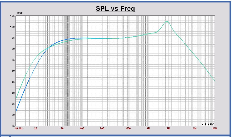

You mean this one would be better, for example TD15X in 225 L tuned at 19 Hz (green curve) , to go more extreme in volume increase.
F3 = 37 Hz, F6 = 24 Hz, F10 = 18 Hz.

You mean the comments of Kaffiman on the 15X in post #283.
As far as I can see 150L is ok. Tuning it higher will give it more a B4 behavior.

I have only looked to SPL and groupsdelay.
Now I understand Kaffimann's point better (I think), TD15X has different TSP parameters compared witht the Faitals and needs more volume for the same SPL curve shape at low frequencies.

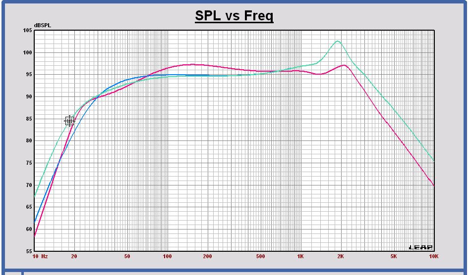

AE TD15X in 225 L / FB 19 Hz (green) and 150 L / FB 24 Hz (blue), Faital in 150 L / FB 24 Hz (red)
Now you got it Paul.
More specific: Focus on VAS and FS in this case. With these exact drivers (all of them) you *could* have near flat response to fs with a B4 alignment in a closer (not exact) to VAS enclosure.
The Faital drivers will not go so low, and in turn does not require much volume to do so even if you force them. The AE driver demands volume to perform, it is probably a better driver, but it comes with a different set of compromises.

Edit: some comparing responses.
I get what you and Kaffimann mean now, I ll look into cabinet sizes tonight (based on wood lumber sizes, WAF ... )
Thanks Paul.

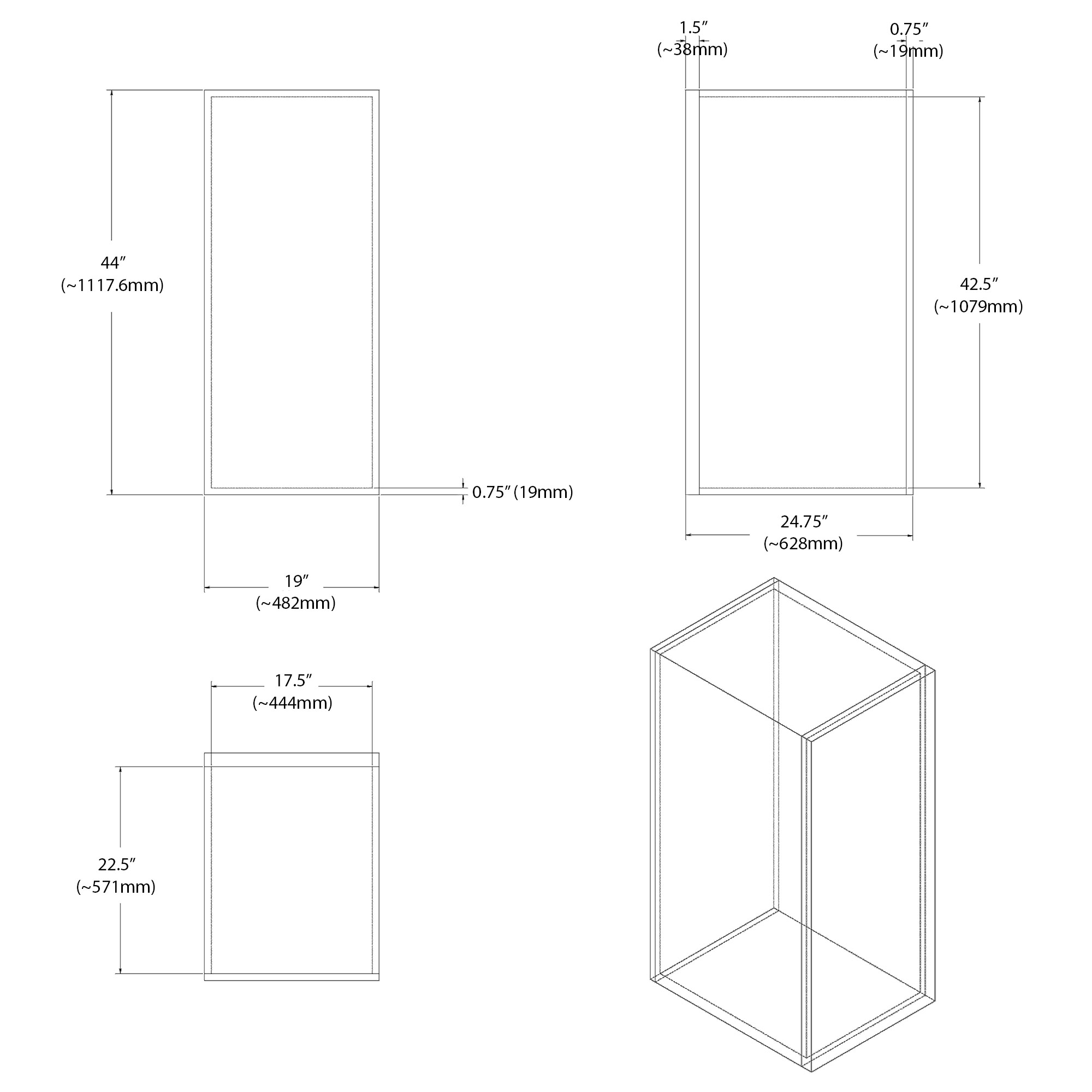

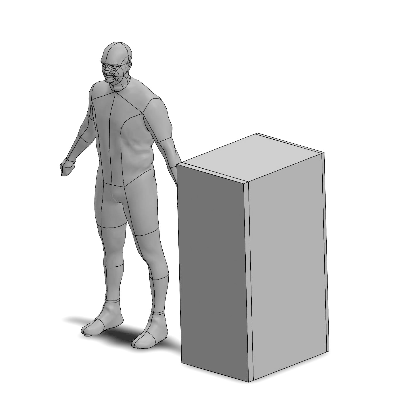

Ok this is around 270L. inner dimensions : 42.5"x17.5"x22.5" (1079x444x571mm), after mid chamber and the bracing,... it will be around 220-230L (inner dimensions :1117x444x571mm)! it is gigantic !

It is a start, first: think fridge to get your head around the format, then: think castle towers with fortifications (maybe your spouse can be convinced to be Queen or Princess? Hidden dream or fetish? Find out what buttons you can push to get thy will done). Maybe get some red velvet and gold trimmings for decoration? Thrones are mandatory.
Does the different volumes needed for the two woofers matter as long as the baffle dimensions stay the same or very close?
Mordikai,
The same baffle size and making the cabinet only deeper for more volume, will have less effect on the SPL response for one particular woofer.
Anyway two optional woofers do need different X-over.
But I only try to make the global difference between the concepts minimal. Otherwise we are making two speakers in one project. Therefore I mentioned also to find an 8 inch midrange as an alternative for the AE TD8M.
