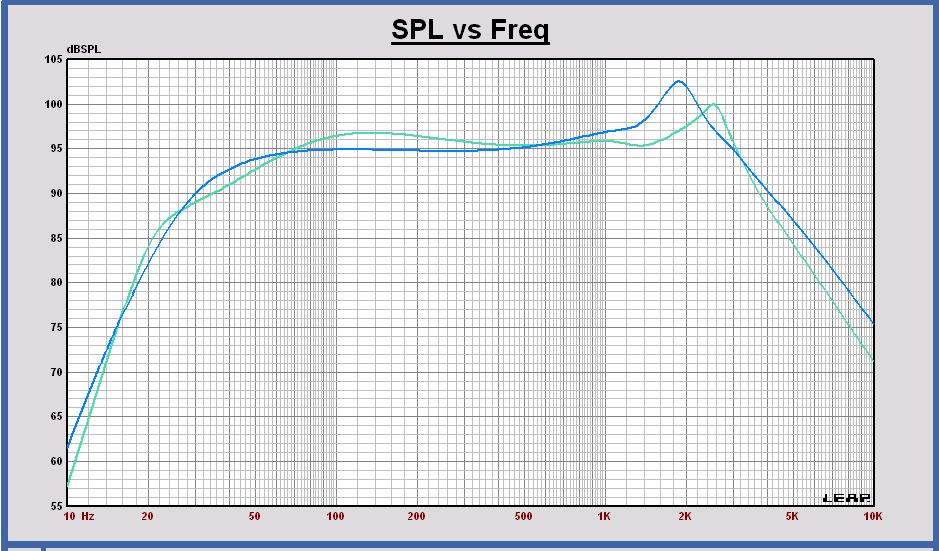

I have done a simulation with the AE TD15X-8 in a Tower XL cabinet with 150 L available for the woofer excl. port. That means a cabinet with dimensions of W x H x D = 46 x 110 x 50cm.
A port of 44 cm total length and 195 cm2 port area.
That looks very good! With a driver with such parameters, we can make one proposal for all, no options for the port anymore (I think so).
AE TD 15X-8 in VB = 150 L and FB = 24.6 Hz, F3 = 35.3 Hz, F6 = 27.7 Hz, F10 = 22.5 Hz

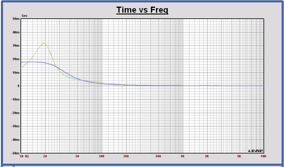

See also the SPL and groupdelay plot, AE TD15-8 in blue and Faital Pro 15FH520 in green to compare.
SPL Plot
Groupdelay plot

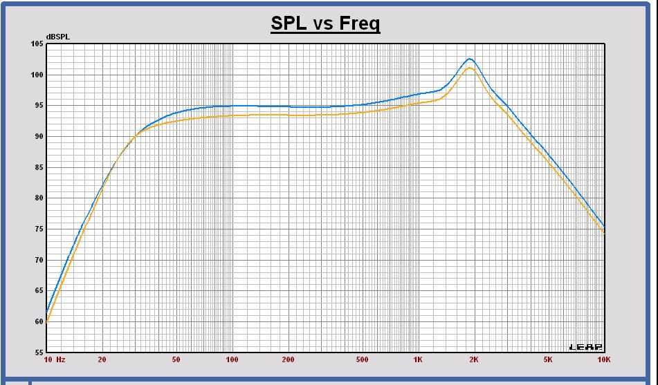

The AE TD15X is the best choice IMO. It has the highest sensitivity.
The AE TD15H goes lower but has less sensitivity.

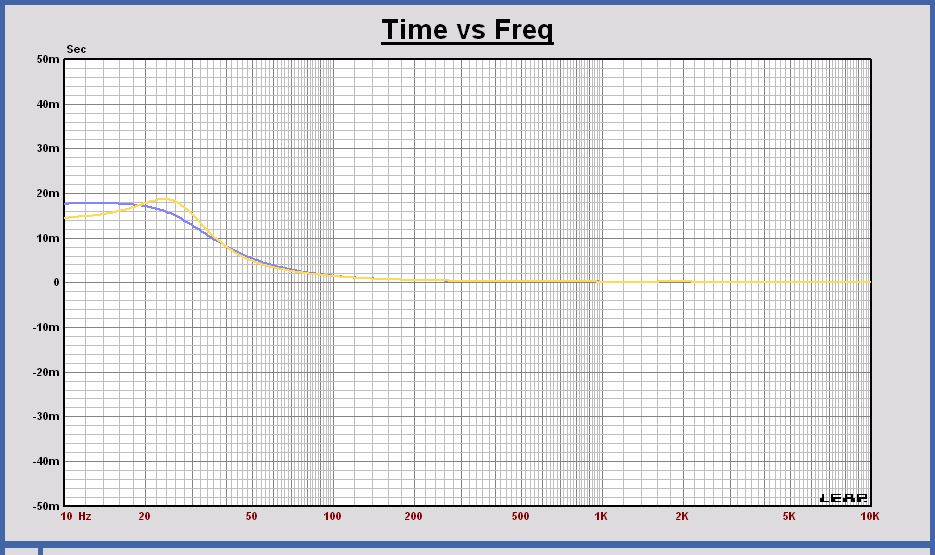

It is easy to understand, the 15H has more Mms than the 15X and both drivers have the same compliance. So, they have the same absolute SPL at low frequencies, but not for higher frequencies, then the 15X goes louder. Looking relative the 15H goes deeper.
You have to choose what you prefer, lowest F3 or highest sensitivity.
AE TD 15X-8 in VB = 150 L and FB = 24.2 Hz , F3 = 35.3 Hz, F6 = 27.7 Hz, F10 = 22.5 Hz – 96.1 dB half space
AE TD 15H-8 in VB = 150 L and FB = 24.2 Hz, F3 = 31.3 Hz, F6 = 25.5 Hz, F10 = 21.4 Hz – 94.6 dB half space
SPL AE TD15X (blue) and AE TD15H (yellow)
GD AE TD15X (blue) and AE TD15H (yellow)

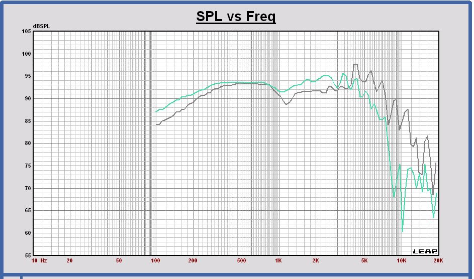

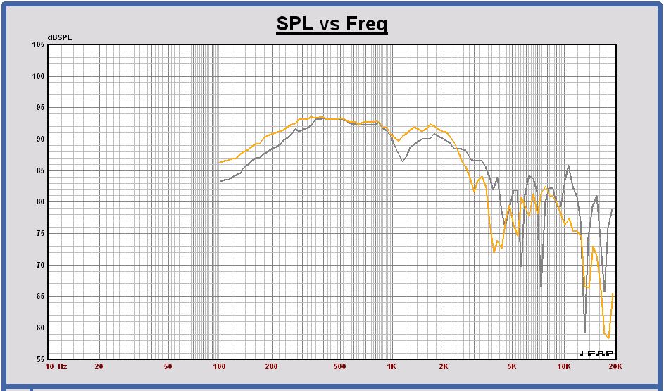

For the TD8M vs. the TD6M, let me do first a DI investigation in Leap based on the off axis measurements of AE. I am a little afraid the DI of the TD8M becomes too high around 1500 Hz and maybe I can see something in simulation. Now we only know from John that it sounds well. I have the results soon.
Brett,
Also some comments from my side on your remarks:
- the midrange enclosure can be about 15 L netto in this cabinet, the driver has a Vas of 13 L. I think that is enough, and a closed box filled with sheep wool if I may choose it.
- a rectangular port seems to have some advantages, Kaffimann can tell you.
It is more solid also than a round PVC tube.
- I will not discuss the golden ratio, but asymmetric driver positions show large improvements in more uniform off axis responses and smoother DI. I haven't implemented it that way in earlier projects, but now simulations show a lot of improvement. Also ATC does it in their speakers.
Hi Aatto,

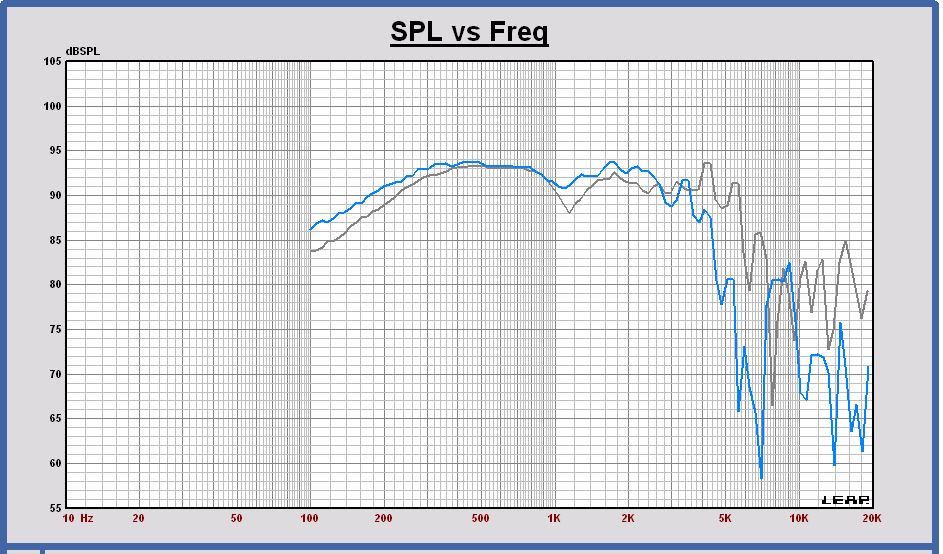

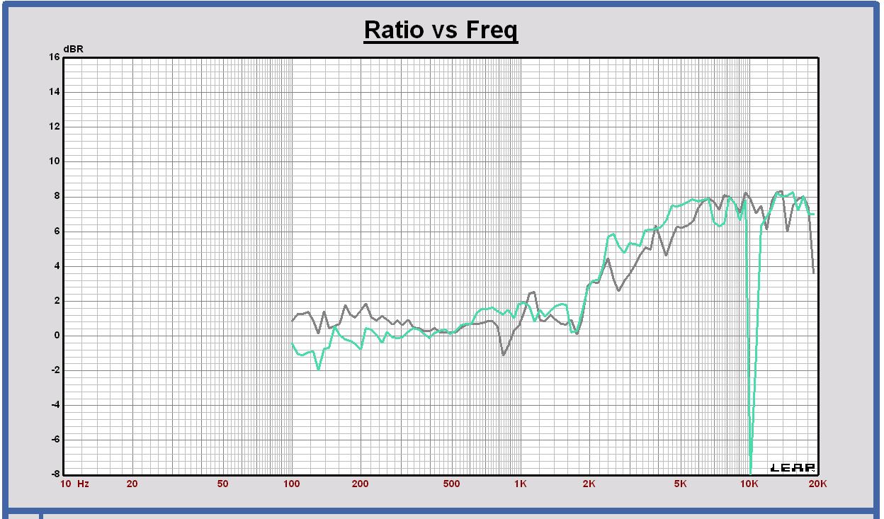

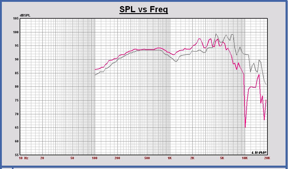

It looks good for the AE TD8M compared with the AE TD6M.
The SPL curves on and off axis are more linear and smooth for the TD8M.
The calculated DI of both drivers is almost equal up to 2.5 kHz. Above 2.5 kHz, the DI of the TD8M is a little higher.
That both DI curves are almost equal, proves that the TD8M has some smooth cone breakup.
Remark this is a calculated DI in a single horizontal plane of only +/- 52.5 degrees. But it gives a good indication already.
Based on these results, best choice is the TD8M!
Some plots in attach. SPL at 0, 15, 30 and 45 degrees and the calculated DI, both drivers compared. The TD8M curves in color in all plots.

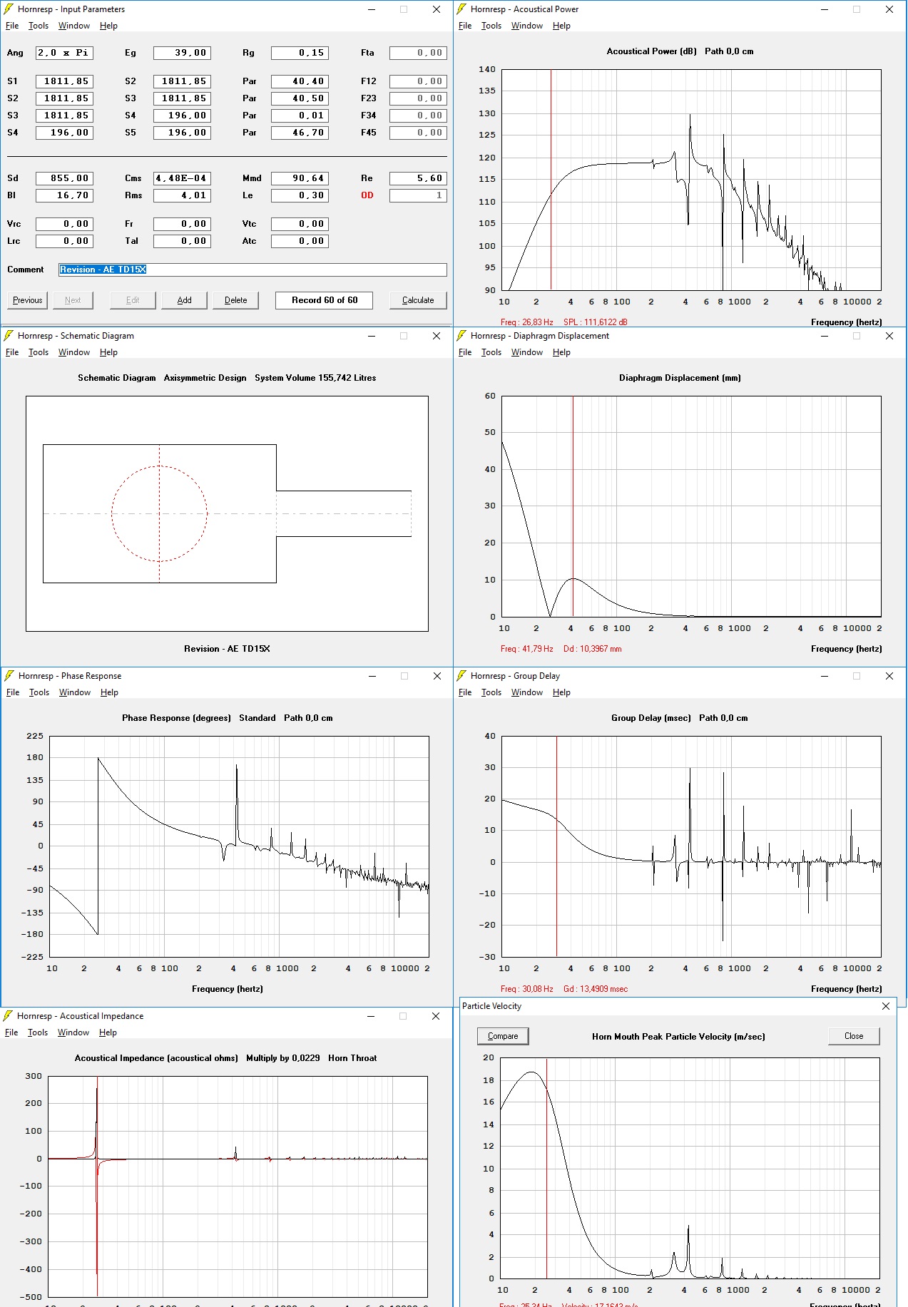

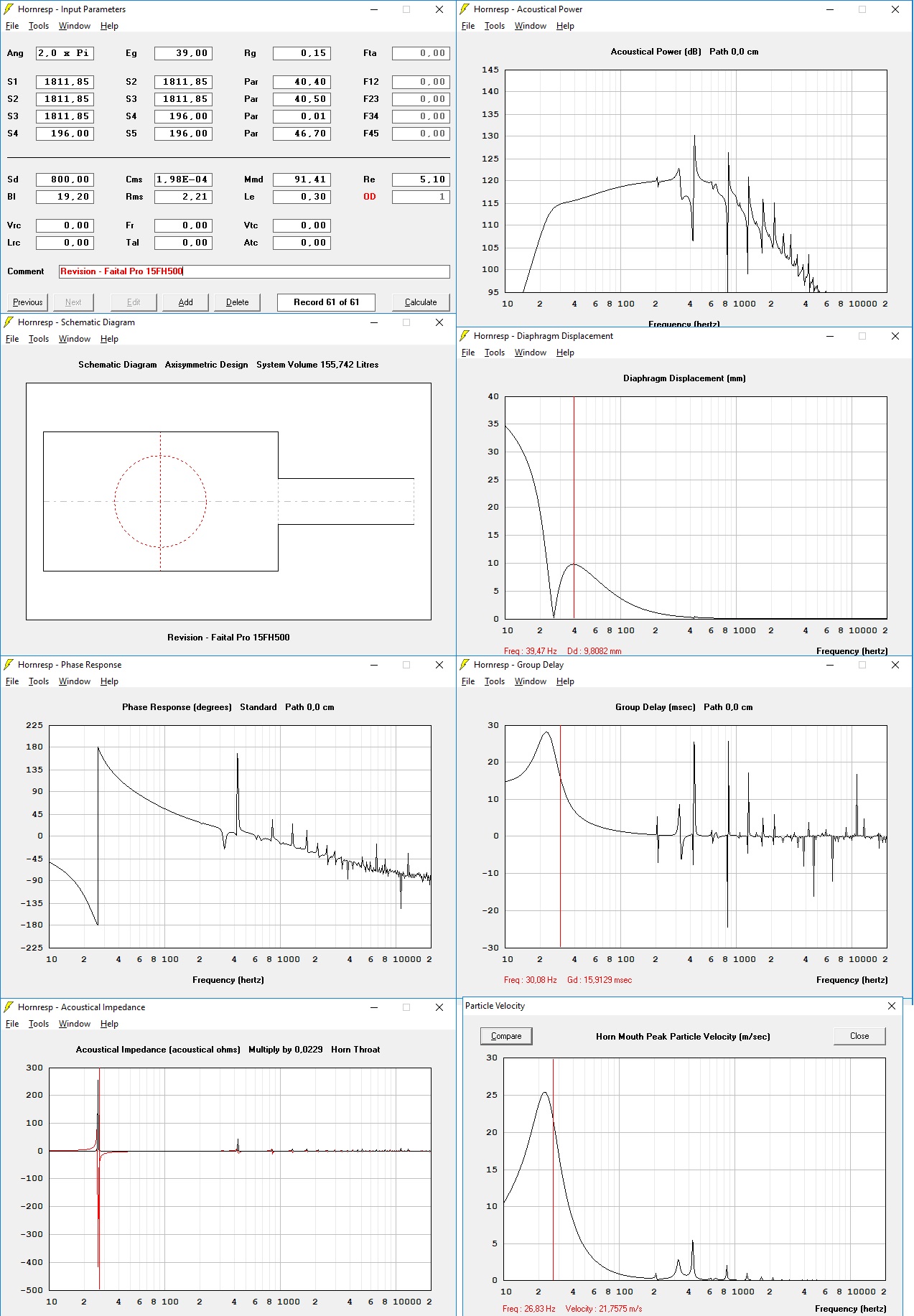

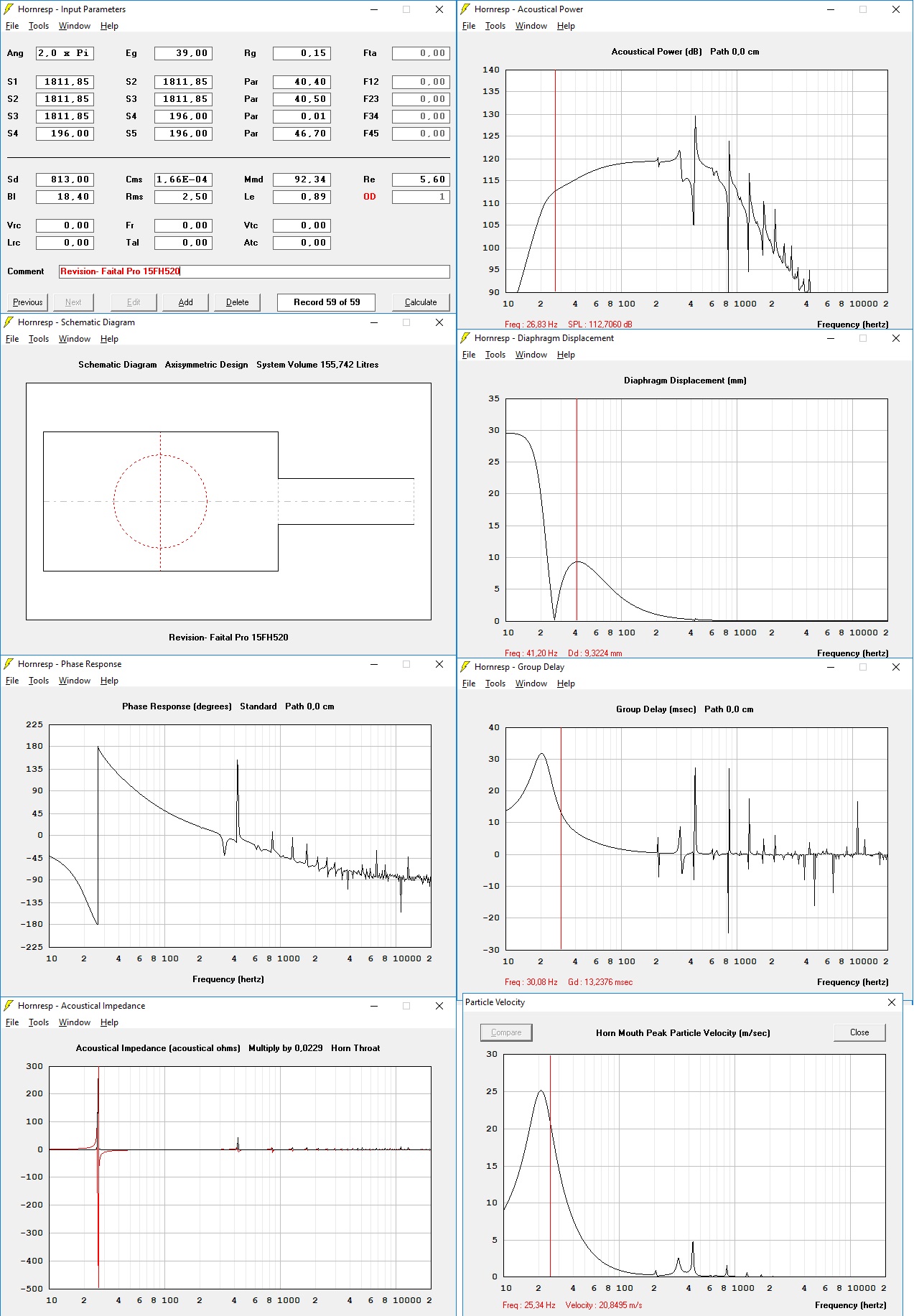

Here you go. The voltage is equal for all, just for comparison everything is the same except the drivers. Both the FH520 and the FH500 are slightly over their xmax at this voltage by ca 0.5mm, while the TD15X is well within it's comfort zone, but uses more travel than the other drivers.
If you want to force feed the design this much power (in pure sine sweep it is a problem, music should be fine with even more power than this), the Faital drivers should have a HP filter. The TD15x has lower group delay under 30hz, but also lower output because of parameters and loading/resistance in relation to box and port.
My personal choice would still be the 15FH500 because of the smooth predictable response, better response under 30hz than the 15FH520, and (in my case) much lower price than TD15X.

Kaffimann,
Thanks, I will look later in detail, other jobs to do now.
But already this point. Also in my simulations I see that the Faitals have a group delay peak around 20 Hz, and the AE TD15X doesn't have. You also see in the SPL shape. A group delay peak means a more resonant tuning, I think we have to avoid it if possible. IMO the reason is the lower fs, larger Vas and maybe also the lower Qts of the AE. The Vas/Vb ratio is different for both applications. I will do that investigation where it comes from.
Edit: I think it is the fb/fs ratio which is higher for the AE system. In a way there is more damping of the driver at the fB frequency.
