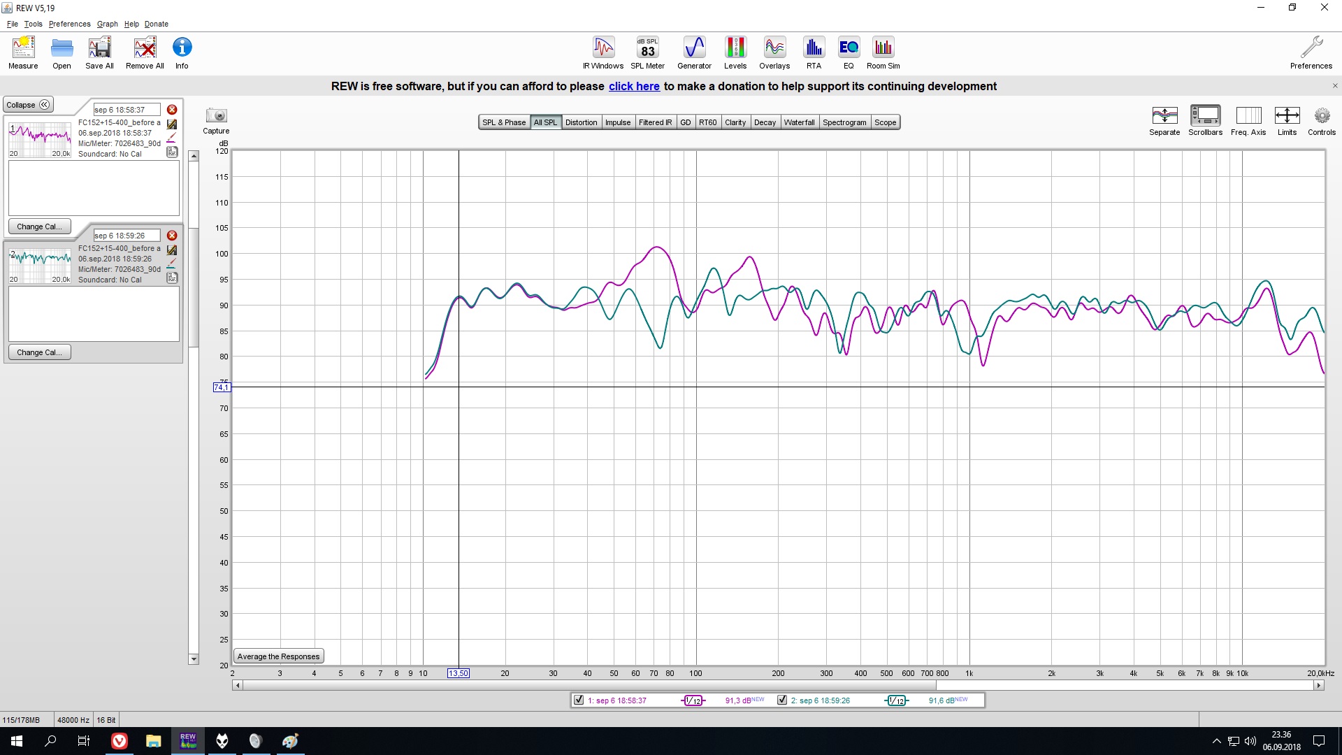

This is what it measures like using only 5 bands of EQ and no xo, both left and right channels in-room.
701993d1536300169-budget-40-10k-hz-100db-planning-fc152-15-400_no_xo-just_eq-jpg
THD + N is measured at 1.5%/ca 13.5hz, which is the highest number before the spl rolls off.
