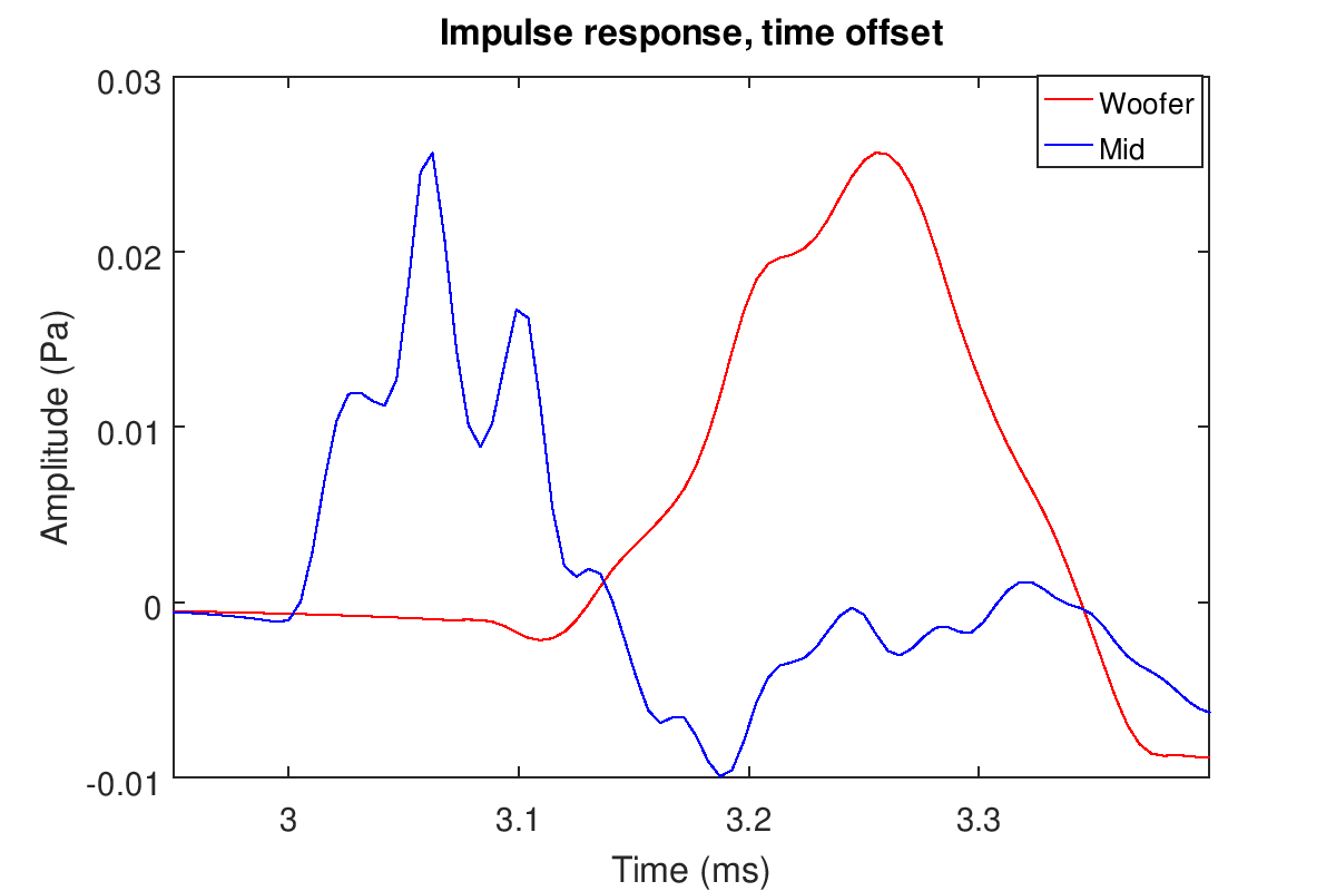

Ok, I am working to get the basic acoustic measurements done. Here's the time offset between the mid and woofer. The delay of the woofer relative to the mid is about 0.115 ms, so the acoustic center of the woofer is about 39 mm behind the mid. This is negligible compared to the wavelength of the intended x-over frequency, so there's nothing to worry about.

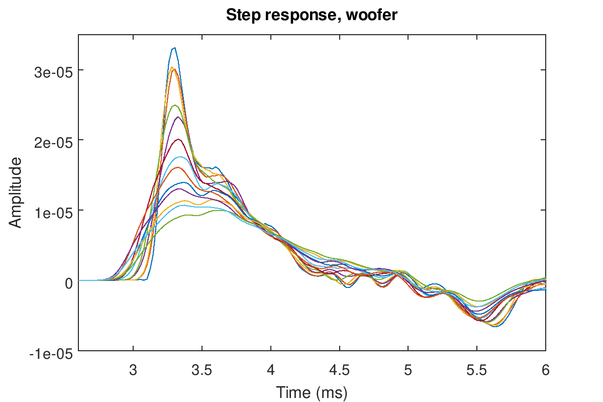

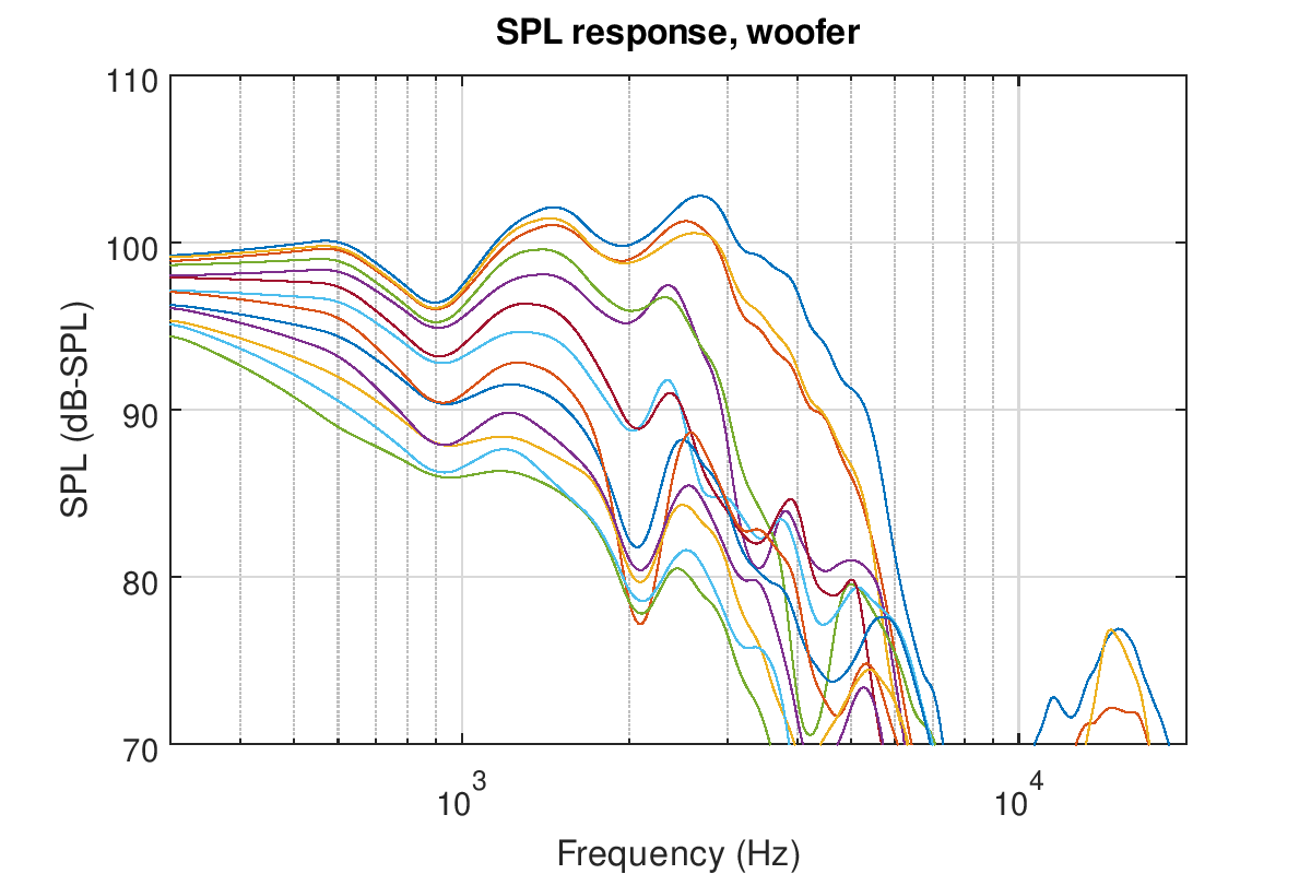

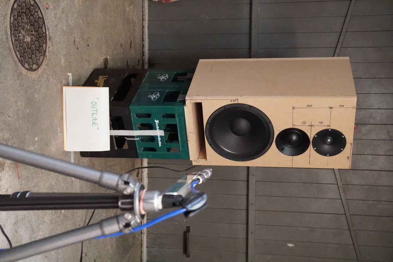

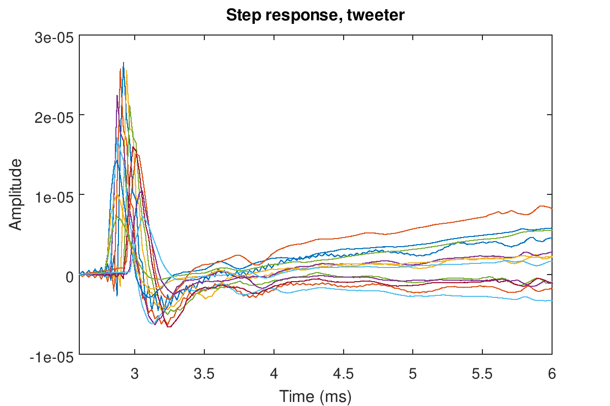

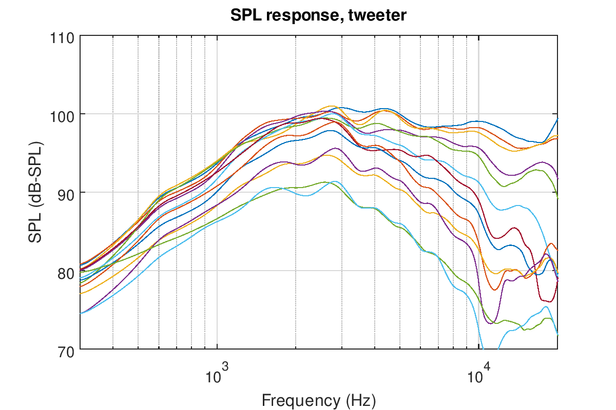

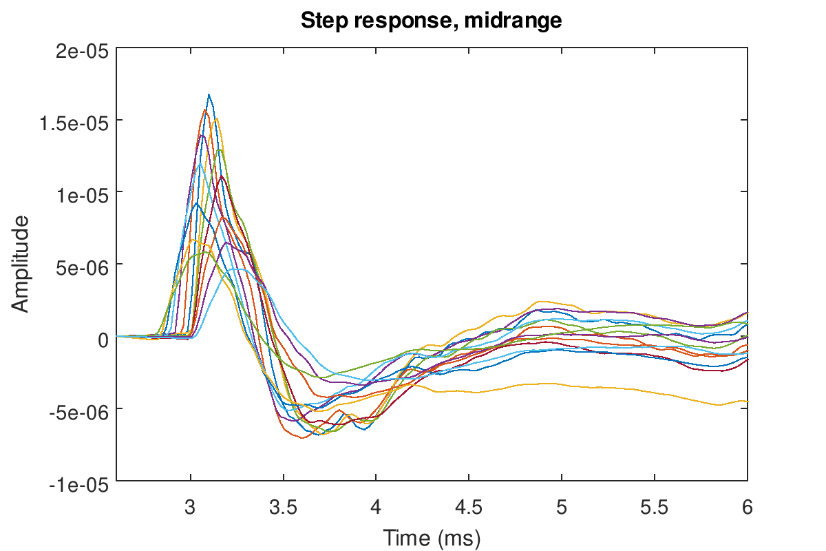

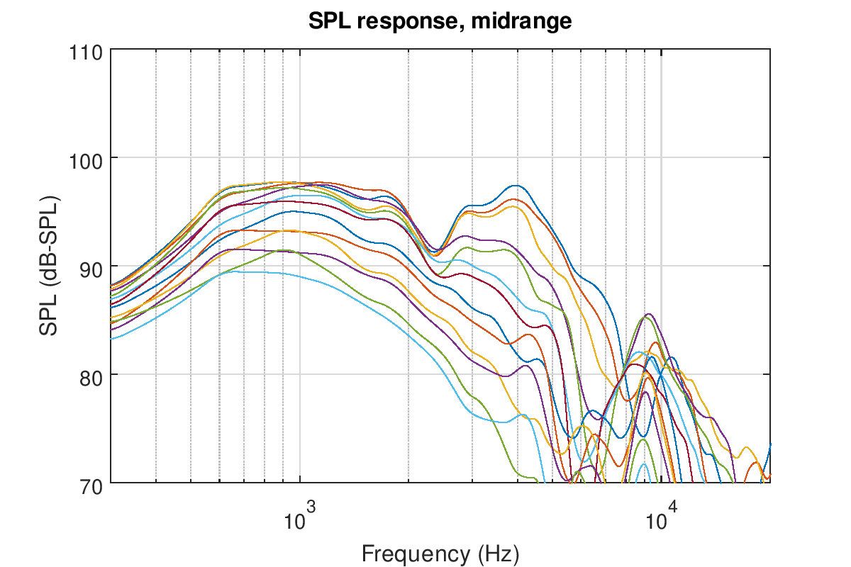

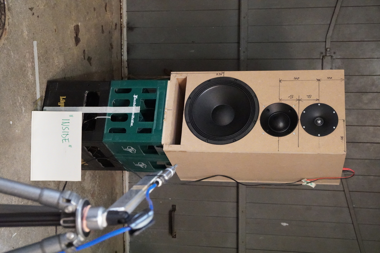

Here are the acoustic measurements of the drivers in the Monkey Coffin prototype box (20181219). I measured the drivers with the microphone 1m away from the baffle and on the height of the drivers (the anechoic part is therefore a little bit different for the different drivers). All measurements were done on-axis and horizontal off-axis at 0°/15°/30°/45°/60°/75°/90° "inside" and "outside" (see attached photos to explain the meaning of "inside" and "outside").
I calculated the anechoic SPL response and applied 1/4 octave smoothing to help the clarity of the plots. The raw impulse response data (TMD/ASCII files) and the processed SPL response data (FRD/ASCII) files are attached.
Edit: the "wall" you see in the photos is the garage door. While it does not look like it on the photos, it is more than 1m away from the drivers, and it does no harm to the anechoic part of the impulse response (which is limited by the echoes from the floor and the ceiling). I confirmed this by opening the door and repeating some of the measurements.

I just realised the SPL curves in my previous post were offset by +3 dB. I recently made some changes to the calibration code in MATAA, and it looks like I had a factor 1.414 too many. I fixed this now and replaced the ZIP archive with the correct data. Please delete the old file and use the new one.

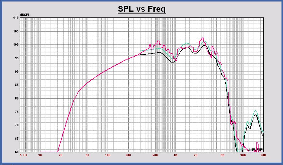

I am working at the frd curves on axis.
The following questions now:
1. how sure are you that the absolute SPL level you measure now is accurate? +/- 1 dB, +/- 0.5 dB?
2. how accurate is the distance from the front baffle? 1.00m exact?
Because in my trials for an accurate splicing both with woofer and midrange, it looks like your measurement is about 1.0 to 1.5 dB higher than the accurate absolute SPL level.
I use driver models based on your impedance measurements, I did post them earlier.
Remark that measuring at 1.00m or at 1.10 m is 0.83 dB SPL difference.
Therefore my questions 🙂
The data processing in the software is now accurate. I confirmed this by playing a sine sweep from 110 to 140 Hz in the nearfield of the Monkey Coffin woofer and used the RMS of the resulting microphone output signal as a reference (1.305 Pa(RMS) = 96.29 dB-SPL). Then I used the software to do an impulse response measurement (still nearfield), computed the SPL response from this, and took the average SPL level in the 110...140 Hz range: 96.28 dB-SPL. This confirms the calibration / normalisation of the FFT in the software is now correct.
However, there are some other factors that may introduce some uncertainties:
- I made a small mistake when I calibrated the gain of the amplifier. The voltage level at the speaker terminal is about 0.2...0.3 dB lower than what it should be.
- The microphone sensitivity is specified at 31.9 mV/Pa @ 22.1°C and 21% rel. humidity. I assumed this sensitivity is the same in my cold workshop, but it might in fact be a bit different.
- The microphone was exactly 100cm from the baffle. The acoustic centers of the drivers are a bit further away. The "depth" of the Volt VM752 is 28mm (baffle to where the voice coil meets the dome). If we assume this as the acoustic center for the Volt, the woofer acoustic center is 67 mm behind the baffle. That would be about 0.6 dB less.

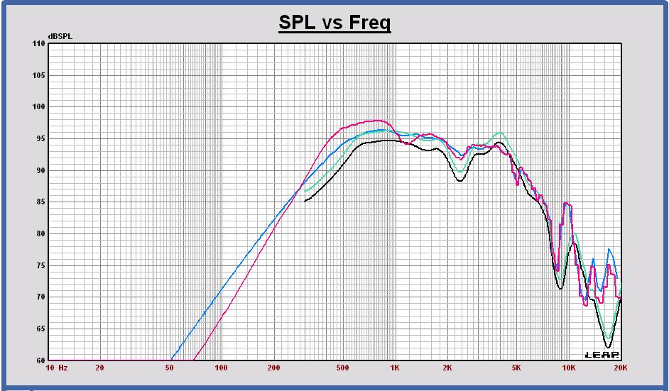

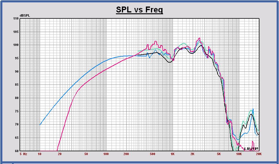

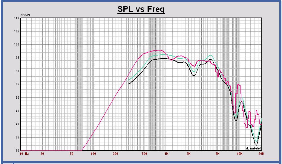

Look what my problem is for splicing curves. In attach woofer and midrange.
- the simulation in red
- measurement in black
- measurement + 1.5 dB in green
You can see there is a better fit with 1.5 dB more.
If I add also the driver on infinite baffle curve in the other plots in blue, it looks like we have to add 1.5 dB to the measurement.
It is important to do the splice with correct levels, otherwise there can be a difference of 1.5 dB between low and high frequencies.
Other remark, the Leap bafflestep boost level is always about 1 dB higher than a mls measurement with FFT window around 5 ms long.
Measurements in anechoic room with longer FFT window are fitting well on the Leap simulations. I think the reason is the short FFT window used in non anechoic rooms. In a way sound waves around the cabinet are not measured long enough. This is a thought now, I have to confirm this with some measurements in an anechoic room and playing with the FFT window length.
I don't understand completely the difference of the midrange measurement versus the simulation below 1 kHz. That is a big difference...
No problem to not use the simulation results, but we have to understand and be sure the measurement is correct. For sure there are some SPL smoothng effects caused by the 6 ms FFT window.
What do you think? 🙂

Concerning microphone sensitivity, it is very dependent on temperature.
This year, with my Clio setup I measured up to 2 dB difference at 27 degrees versus 20 degrees. 2dB more at the lower temperature...
There is an B&K article about this, I look for it.
Edit: At the start of every SPL measurement that I do, I first measure a calibrated driver.
That helps a lot to overcome the microphone sensitivity variation.
Is this stuff not too complex to post here?... please tell me then...
Faital 12PR320 in monkey cab Leap vs. measurement vs. driver inf baffle.JPG150.1 KB · Views: 273
Volt VM752 in monkey cab Leap vs. measurment vs. driver inf baffle.JPG149.3 KB · Views: 269

Matthias,
Is it possibe to post the midrange measurement 0 deg with a much longer FFT window. That means inclusive reflections.
For a driver with a steep fall off to low frequencies, the SPL curve will become better at low frequencies. Reflections are averaged.
Let me start by saying that I am blown away by how well the measured and modelled curves match up! The only difference is the 1.5 dB offset you mentioned, which I can easily believe given my comments above, and the uncertainty related to the sensitivity change of the microphone with temperature (I have sent an email to Earthworks asking about this). Since the offset seems consistent for both the woofer and the mid, I'd say it's ok to just move both curves up by 1.5 dB for x-over modelling.

Matthias,
Sure, I can do that. Tell me which gating time and octave-smoothing you want. Or you can just take the impulse response (TMD file in the ZIP archive) and have a play with that until you get what works best for you.
