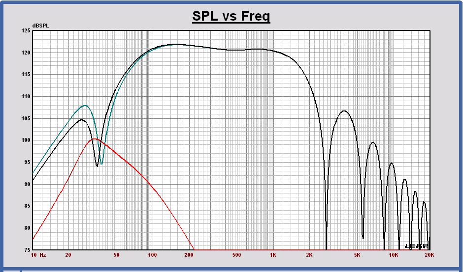

If measuring the driver nearfield, there is still a port SPL component that is added also. At 30 cm the nearfield SPL level of the port is about 15 dB attenuated. Making the SPL sum of the driver nearfied response and the port nearfield response - 15dB, results in a SPL with a lower dip.
In the plot, the nearfield of the driver (green), the nearfield of the port - 15 dB (red) and the sum of both (black). The dip decreases from 37.2 Hz to 34.5 Hz.
Indeed, the phase shift caused by the voice coil inductance also has some impact on the dip. The impedance dip is at 37.9 Hz and the SPL dip at 37.2 Hz.
So totally, the impedance dip is 37.9 Hz and the measured driver nearfield dip with the port close is 34.5 Hz.
In my simulation the port is tuned at 37 Hz. So, it cannot be measured exactly by the SPL dip neither by the impedance dip, if the port is positioned close to the driver and there is some phase shift caused by the voice coil inductance. You have to measure the excursion dip 🙂.
I wouldn't call 30 cm "nearfield". For nearfield conditions, the microphone distance must be much less than the cone diameter.
Of course, but you misunderstand me. At 30 cm distance the SPL of the port is 15 dB lower than the nearfield SPL of the port, and I use the -15 dB SPL to add with the nearfield response of the driver.
Anyway there is some influence.

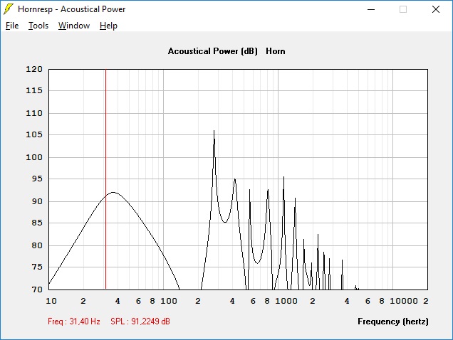

Could you show your Hornresp setup with the corner section? With a bit of luck I might be able to implement it myself.
I am trying to understand what a given change in port length does to the tuning in terms of SPL response curve and group delay. With some model predictions at hand I could define a few port lengths to try in real life by measurement and listening with my ears.
It is only a basic calculation, port length + material thickness + bend path length increase. For these low frequencies a bend will not change a whole lot of performance parameters, so they are for the most part ignored, but this is also why I suggested adding 1cm distance to the back wall, so any negative properties would be offset completely. Here is a picture i found in this post (there are lots of examples around in the various threads) that shows basic calculation of path length (the middle black line) +/- a little bit using common sense.
So in general you just imagine a line in the middle of the port and bend and use that for length. But add too much distance to the back wall and the bend is no longer part of the port, just like you suggested.
Well, yes, and no. The cross section of the port is larger at the entry to the bend than at the main part of the port. The cross section even increases along the bend and then reduces to the main port section. This will give a different behaviour than a port with constant cross section.
Yup. But there is something in between "no bend at all" the "full bend" as it is now. Since I may end up in this in-between-situation I was wondering if the bend geometry is part of the model. It guess the geometry of the port entry (the bend) is not in the model.
1. Yes, but for a port this slim, there are some negative properties of not having a slightly wider transition this is why I wrote: "For these low frequencies a bend will not change a whole lot of performance parameters, so they are for the most part ignored, but this is also why I suggested adding 1cm distance to the back wall, so any negative properties would be offset completely."
2. The geometry is for the most part ignored, but again, for a port this slim there are some downsides to having a too narrow gap at the bend. The path length is accounted for and there is a slightly wider distance to back wall for compensation. If the box was deeper it would be better for a port this size, I think a smaller port is better for this box to lower the group delay peak further down the frequency range, the box is good, just not optimal. This is part of the compromise, -3db should be around 40hz with the box you built, and which is closer to the design goal.

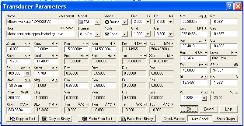

Hi Matthias,
I did some more trials to fit the simulated impedance in the best way on your basreflex impedance measurement. I only get good fitting results if I increase the fs of the driver to 46 Hz. Otherwise the frequency tops are not at the right place.
If possible, can you do the free air impedance measurement again one time.
For me it is interesting to check the accuraccy of my simulation model, also to obtain the correct low frequency SPL.
In attach the current driver model used for simulation.
