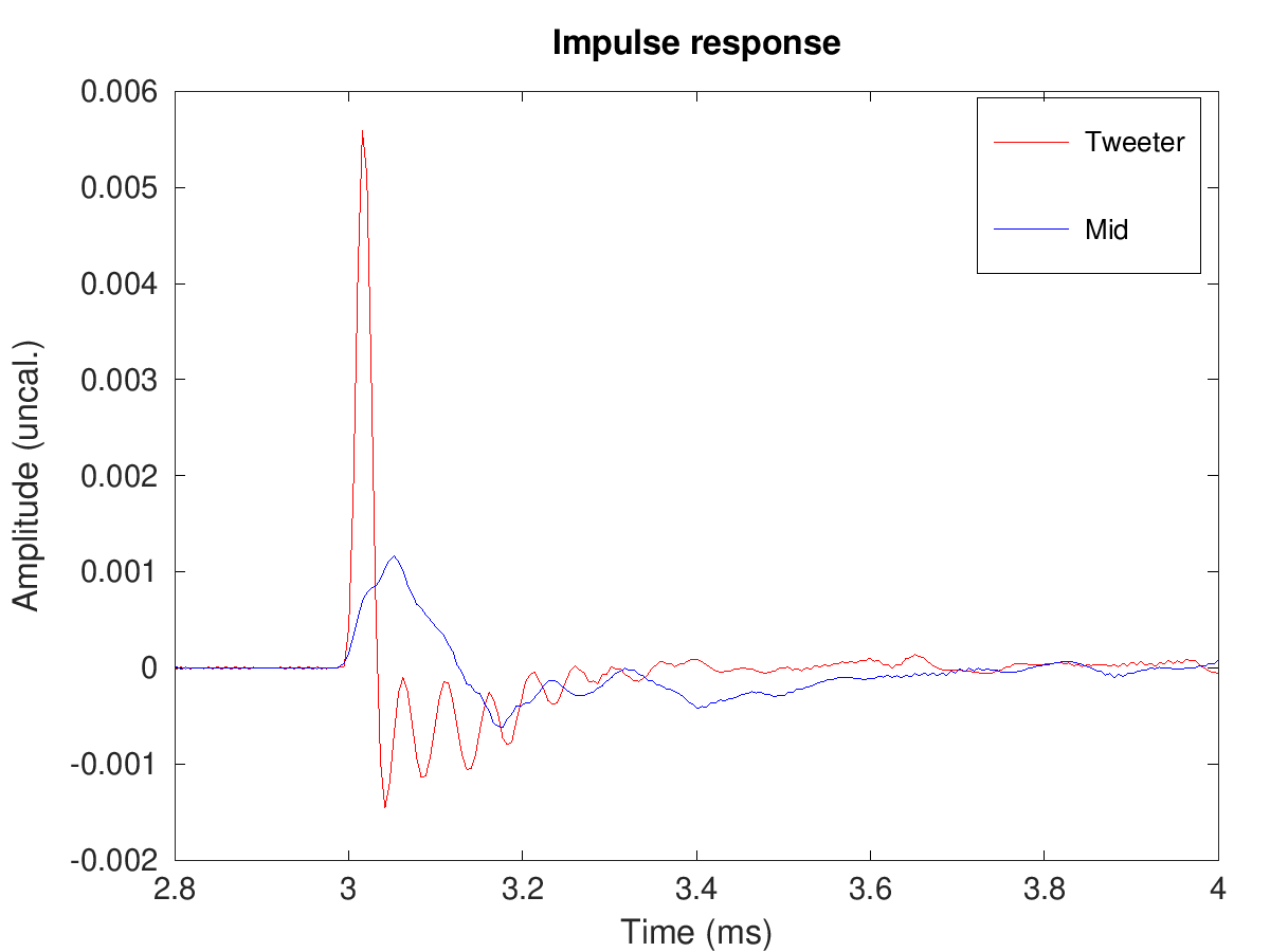

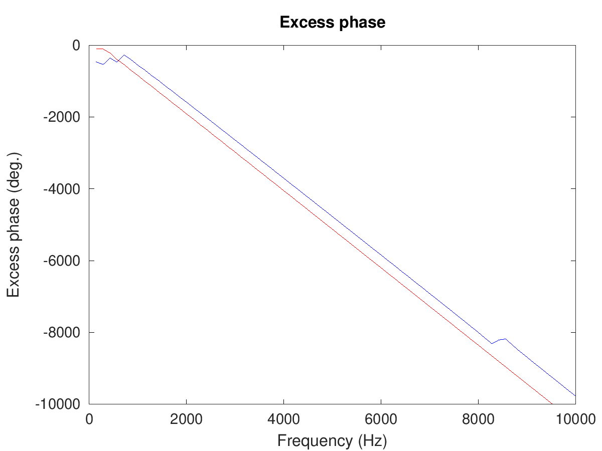

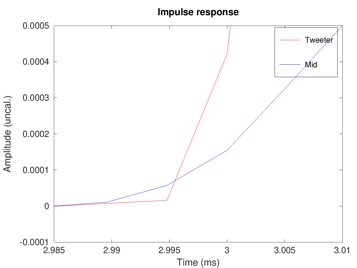

I have now added the loopback compensation (or "dual channel setup") to my setup, which completely removed the inconsistencies of the timing in the impulse response measurement. With this, I measured the impulse response of the tweeter and the mid, with the microphone exactly 1m away from the baffle and at the height of the vertical center of the tweeter and the mid. The data are shown in the attachments, and the tweeter impulse arrives at the microphone 0.029 ms later than the mid impulse (determined from the excess phase slope).
This corresponds to an offset of the acoustic centres of about 10mm. That's not too bad. Is it good enough, or should we try to further optimize that by moving the mid backwards? Sounds like a complicated baffle or a custom waveguide assembly for the VM752, and I am not sure we'd gain a lot from this.
The peak-max or the peak-center of the mid is indeed later than the tweeter. This is simply because the impulse response of the mid is wider than that of the tweeter, which reflects the fact that the mid does lower frequencies than the tweeter. What counts is the BEGINNING of the peaks (i.e., when they arrive at the microphone). The attached zoom-in shows that the mid impulse arrives BEFORE the tweeter.

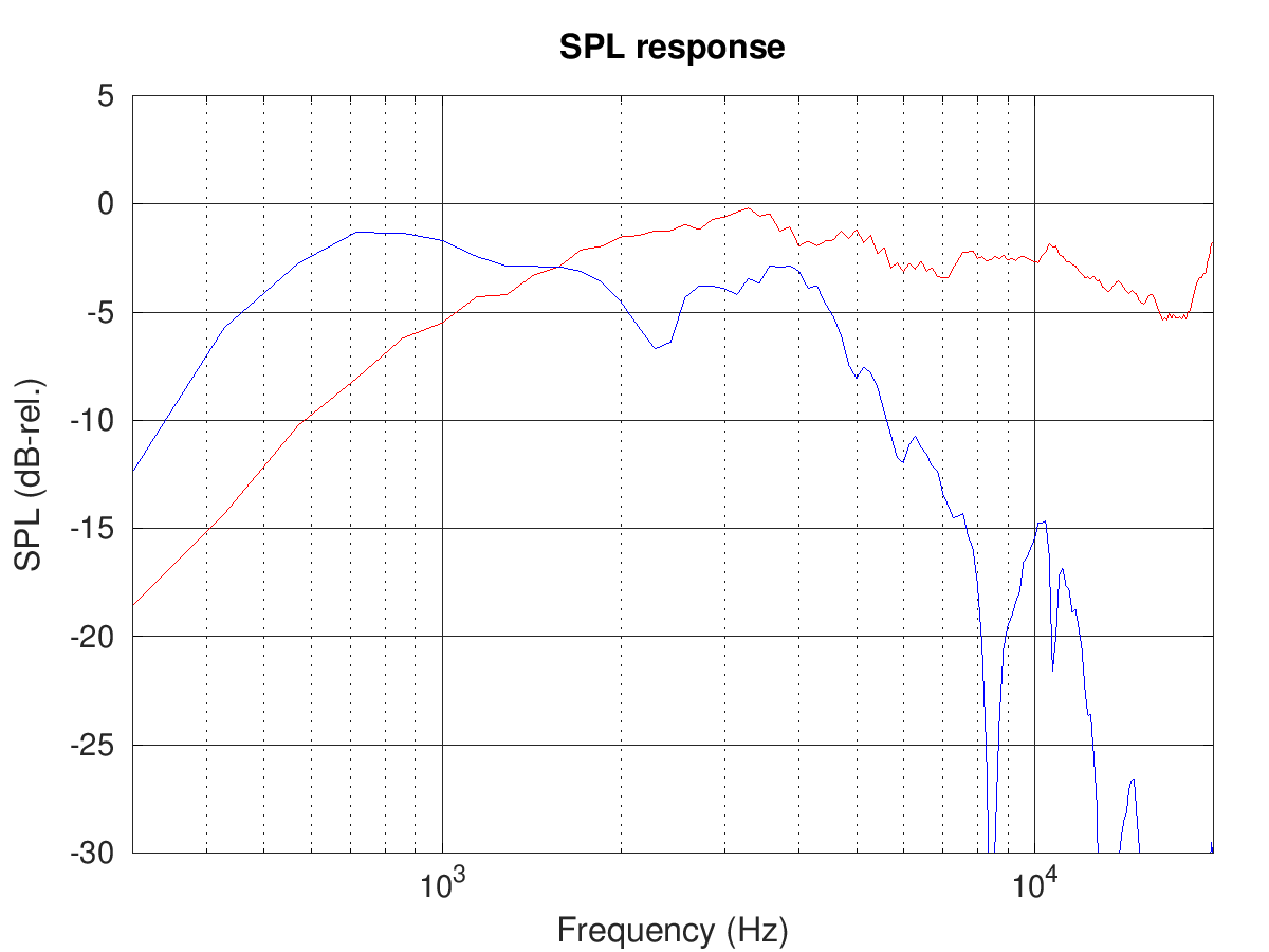

My baffle is 30cm wide with rounding radius 4cm, speaker in midline. Your test baffle looks narrower, and the dip is at same F left/right - doesn't match with baffle effect!
My guess is that the Volt's steep waveguide-like edges make it disperse like a 6" woofer. That dip is in factory datasheet too.
You are right. Assuming the SPL chart in the factory datasheet was measured on an IEC or similar "large" baffle, the dip at 2.2 kHz cannot be related to the baffle. The dip does get less off-axis, so I don't think it's a mechanical resonance within the dome/suspension. 2.2 kHz corresponds to a wavelength of 15.6 cm, which is about twice the dome diameter (7.8 cm). Is this a reflection/suck-out within the waveguide?
It is ok now. Btw, what is the sample frequency of your measurement system?
Funny that Volt's waveguide diameter is 158mm, matches quite well with 2,2kHz wavelength 156mm! Cone diameter looks irrelevant. And because the profile is so deep without rounding, this efffct gets so bad.
The 2" Volt has diameter 109mm and dip at 3,2kHz (107mm) but for some reason there is lots of smoothing in the datasheet measurement...

Sampling frequency was 192 kHz for these measurements (to get the best possible time resolution).
If the tweeter is 10 mm too far behind in the on-axis measurement, it will be perfectly aligned if the microphone (or my ears) are positioned about 7° upwards from the on-axis position. Sounds like a reasonable scenario in my intended listening room.

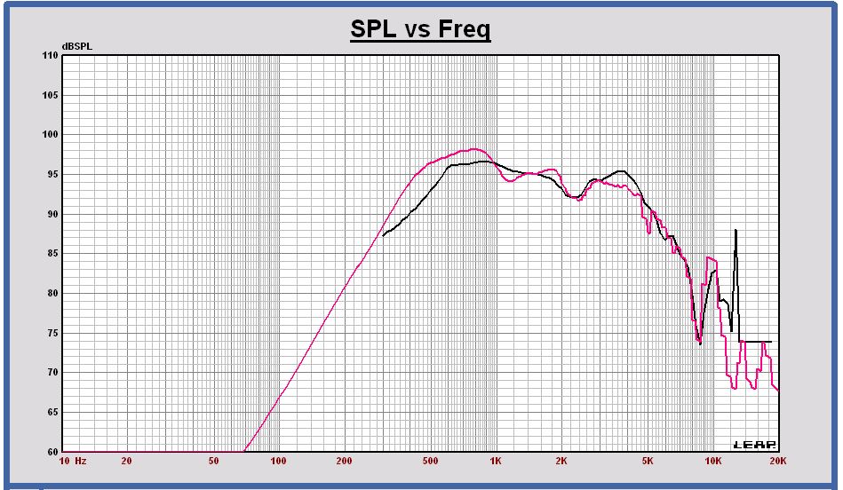

Just for a first idea I compared the Volt measurement with the simulations till now.
In the plot the red curve is the simulation and the black one the measurement (shifted +15 dB).
What concerns me at this moment is the response difference below 1 kHz.
There can be different reasons:
- Short FFT window with some smoothing and low frequency fall off as a consequence
- The driver has different parameters
- Leap bafflestep boost too optimistic
IMO it is best to measure each driver on its own axis at 1m from front baffle.
In simulation I see that for the Volt the SPL difference is already 2 dB at 20 kHz, measuring on its own axis vs. the axis between midrange and tweeter.
With corresponding phase shift already at 20 kHz.
The goal is to have correct responses at listening distance, being 3 m and more. So the best way of measuring the drivers is each driver on its own axis at 1 m. I do it like that for my own designs.
Hi Paul -- please don't expect accurate SPL for those measurements. I didn't care too much about optimal time gating, and they are not calibrated in terms of absolute levels and microphone frequency response. I just made sure the timing is right to determine the offset of the acoustic centres. I will make proper SPL measurements soon, and I'll provide the data files so you don't need to digitize stuff from the diagrams.
Matthias, yes I understood that way. I just gave this information as an input for your final measurments .

Hi Eelco,
I have made a driver model in Leap based on the datasheet SPL and TSP. Simulation in cabinet is done using a cabinet model also in Leap.
Later on I will adapt the driver model conform measurements of the Volt driver Matthias is using now.
I still have some doubts about the bafflestep simulation in Leap with some enclosure models.
I checked all with my own speaker, Leap simulations versus anechoic room measurements and they did match very well.

That makes sense. I have not checked, but most likely the Volt factory datasheet uses the IEC Baffle. It looks as if the simulation show a diffraction issue at approx 1.1 kHz, the 2.2kHz issue being a driver artefact.
Furthermore, the low-end roll off looks underdamped in comparison with the measurement Matthias made. Strange.

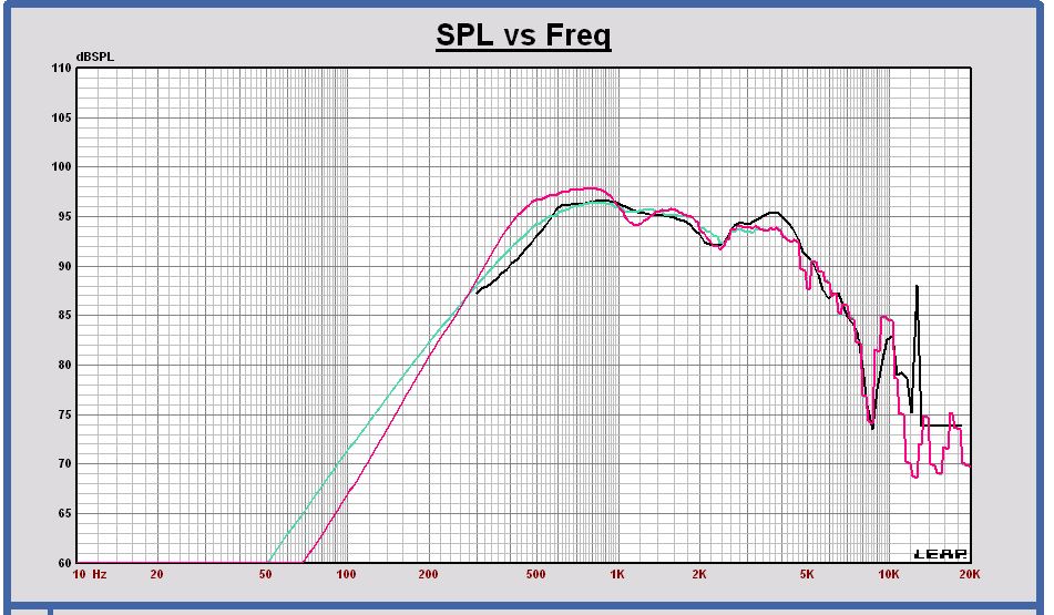

Eelco:
I have added the infinite baffle model of the Volt driver in green color (red = simulation in cabinet, black is measurement in cabinet)
Based on that, the 1.1kHz dip is a diffraction dip that Leap simulates, which is not visible in the measurement. It is possibke that it is smoothed a little due to a too short FFT window.
I think the underdamped low frequency measurement result is due to a short FFT window or driver different parameters.
I think we better wait for Matthias' final measurements to have a better view on this.
