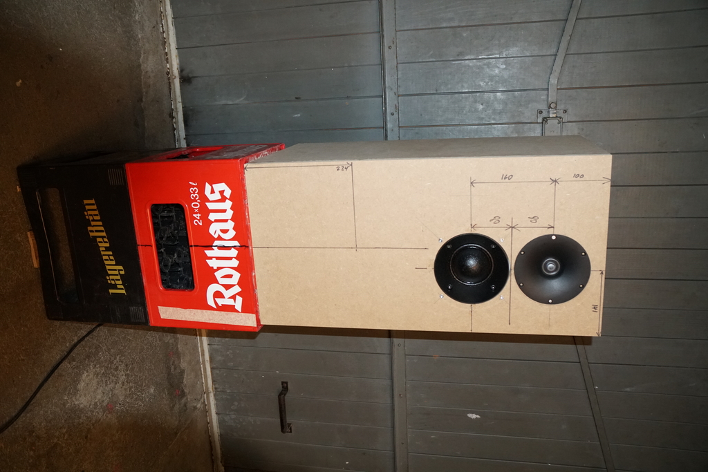

I have now measured the offset of the acoustic centres of the tweeter and the mid. As it turned out, my test setup is not great when it comes to the consistency of the time delay of the recorded test signals. It was therefore not possible to compare the relative time delays of the impulse responses of the tweeter and the mid.
The way out was to measure the tweeter and mid simultaneously in a single measurement in order to avoid the uncontrollable time delays between two separate tweeter/mid measurements. The procedure was as follows:
- Tweeter and mid were both mounted flush on the Monkey Coffin prototype baffle as shown on the photo.
- The "depth" of the tweeter (Scan R2904 in WG148) is 20mm (horizontal distance between baffle plane and the point where the voice coil meets the "dome"). The "depth" of the mid (Volt VM752) is 28mm.
- The microphone was mounted exactly 100cm away from the baffle, at the height of the center between the tweeter and the mid (horizontal line between tweeter and mid as seen on the photo). The distances between the microphone and the tweeter or mid are therefore the same.

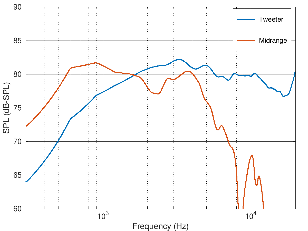

- The SPL responses of the tweeter and mid were measured separately to deterine the frequency band where both drivers have "flat" response (the "overlap frequency band").
- The tweeter and midrange were connected in parallel, with the tweeter reversed relative to the mid.

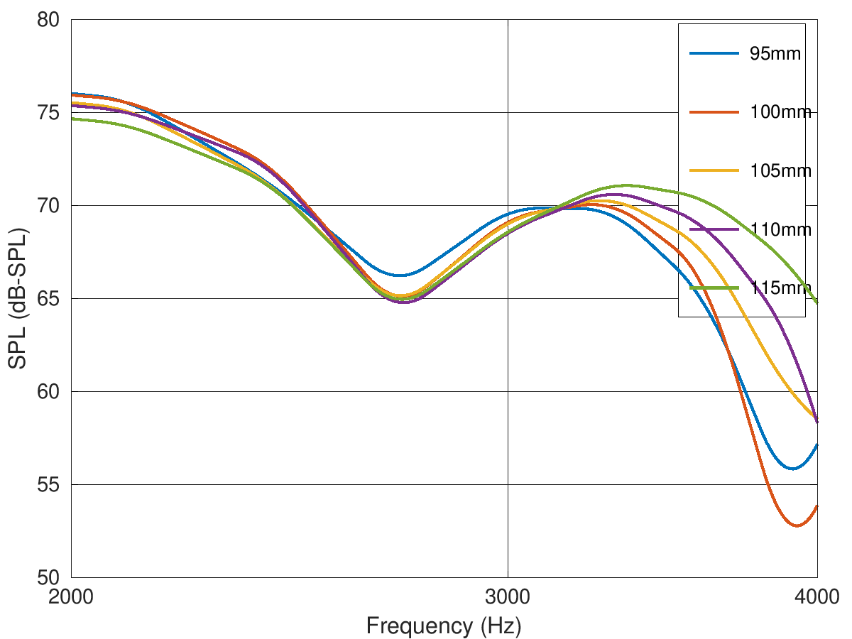

- The anechoic response of the tweeter + mid was measured repeatedly, with the microphone at different heights.

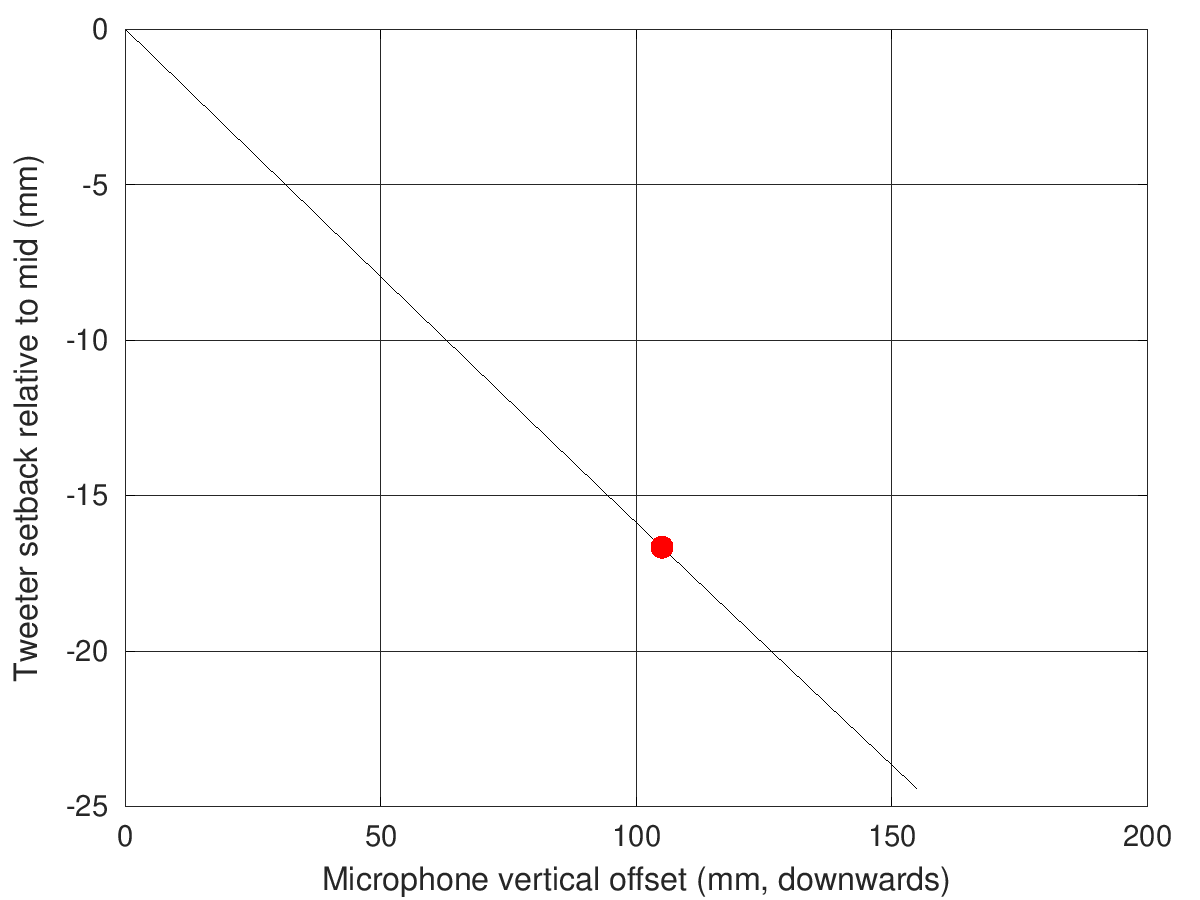

Moving the microphone vertically results in different microphone/tweeter and microphone/mid distances. Once the acoustic centres of the tweeter and the mid are perfectly aligned at a given microphone position, the reversed polarity of the tweeter and the mid results in a a dip of the SPL response in the "overlap frequency band". Then it's just a matter of Pythagoras to work out the difference between the mic/tweeter and mic/mid distances at this microphone position in order to determine the offset of the acoustic centres of the tweeter and the mid.

- The "overlap frequency band" is about 2-4 kHz.
- The strongest cancellation in this frequency band occurs with the microphone about 100-110mm below the center of the tweeter and mid.
- The tweeter would need to mg ove backwards by about 16 mm to achieve perfect time alignment.
16 mm is about 10% of the wavelength of the planned x-over frequency (2-2.5 kHz), so the current WG148/R2904/VM752 set up is not terribly bad. Is this good enough, or should we try to improve this further (with a deeper waveguide)?

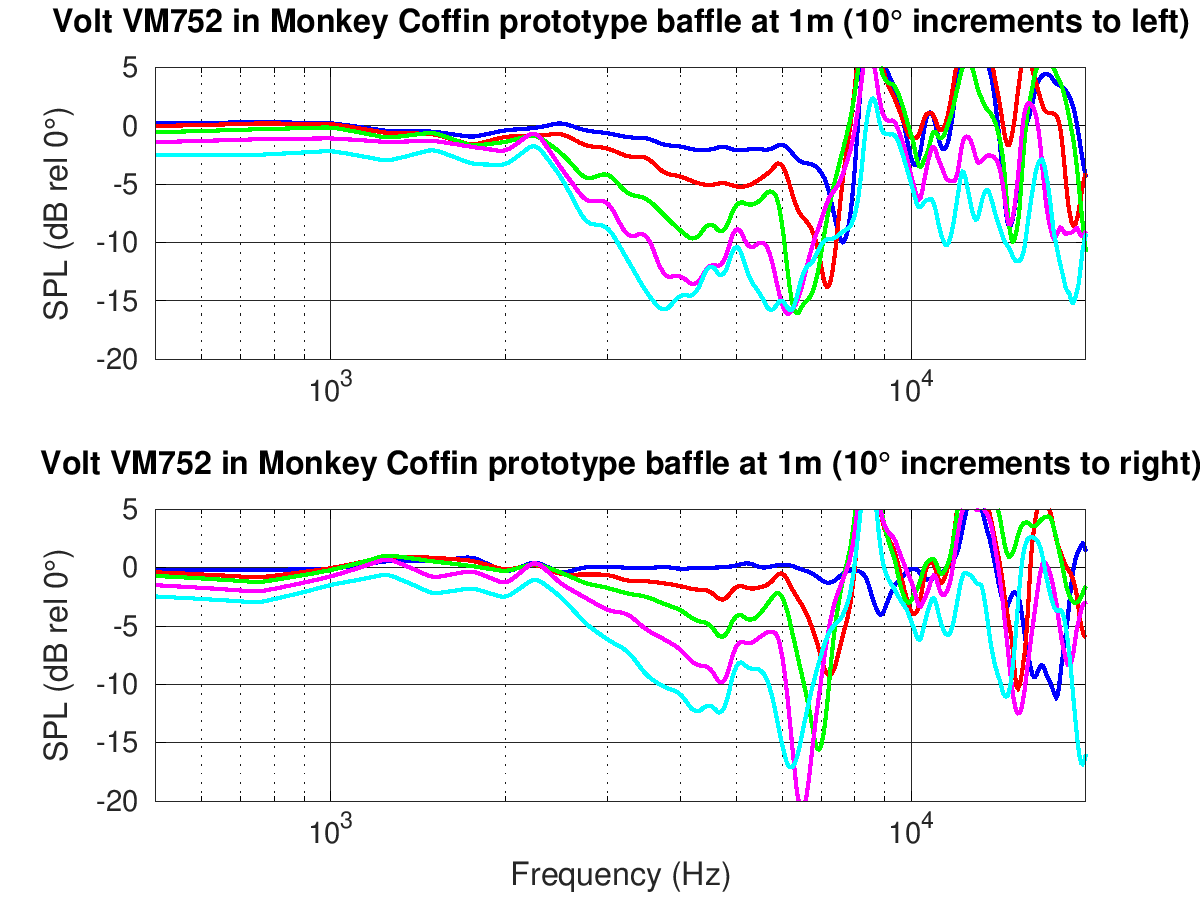

Midrange response looks quite difficult, but the dip at 2,2khz gets compensated off-axis.

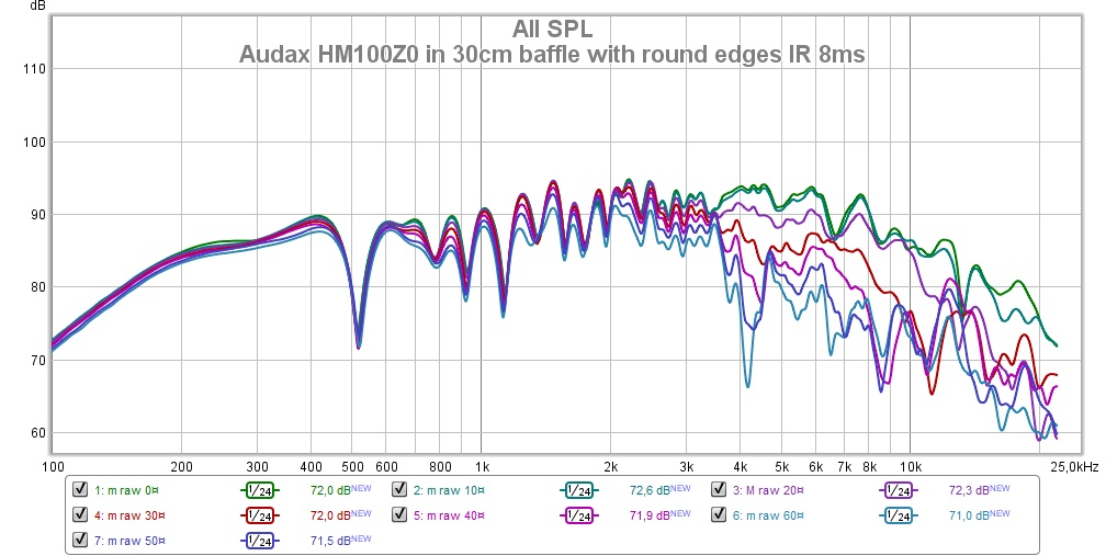

This is a shallow cone 4" Audax HM100Z for comparison, 0-60¤. Same phenomenom at 3,4kHz.
this measurement was here earlier
Baffle edge diffraction.
Baffle edge diffraction?
My baffle is 30cm wide with rounding radius 4cm, speaker in midline. Your test baffle looks narrower, and the dip is at same F left/right - doesn't match with baffle effect!
My guess is that the Volt's steep waveguide-like edges make it disperse like a 6" woofer. That dip is in factory datasheet too.
