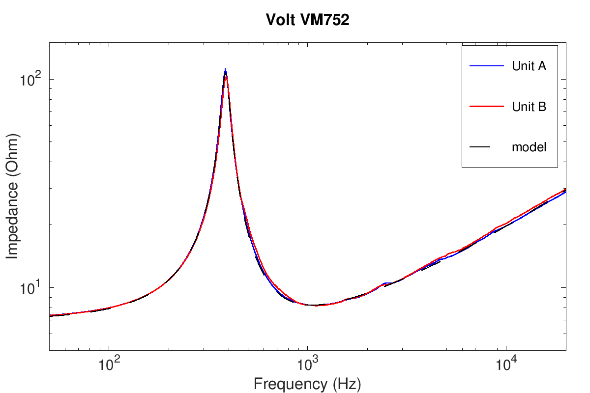

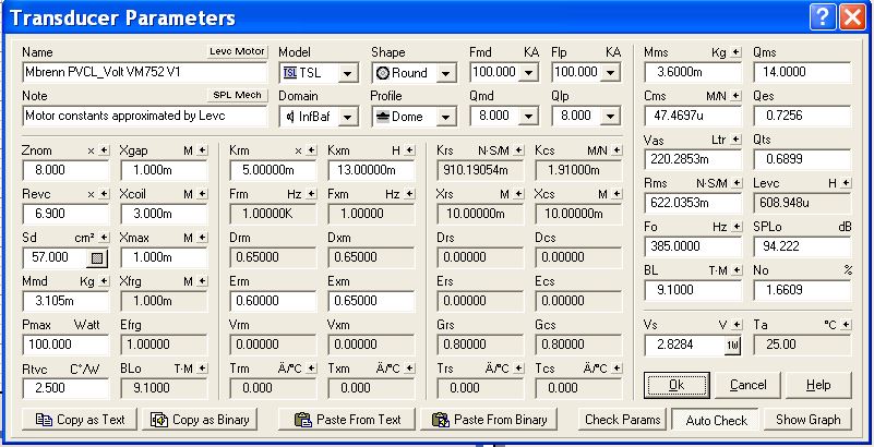

After 24h break in for the Volt VM752 mids I took some impedance curves. Results are attached, very similar for both drivers. My TSP parameters I get from the impedance curve(s): f0 = 386 Hz / Qes = 0.75 / Qms = 10.7 / Re = 6.9 Ohm (from DVM).
The factory datasheet values are f0 = 400 Hz / Qes = 0.81 / Qms = 9.53 / Re = 6.3 Ohm
Using my TSP and the datasheet Vas value, I get an efficiency of 93.5 dB/1m/2.83 V. With the factory data, I get 94.1 dB/1m/2.83V.
Paul: can you use the impedance curves / TSP for a revised model of the Volt?
Everyone: Let me know what you think.
Very similar results for the two drivers, excellent.
See the Leap model in attach, if I do a perfect impedance map on your measurement.
W.r.t. to the datasheet, I had to decrease BL and fs a little, and increase Qms.
Sensitivity at 1W, 1m is 94.22dB vs. 94.8 dB in the datasheet.
Maximum sensitivity at 2.83 Vrms, 1m is 95.45 dB vs 96.05 dB in the data sheet.
Very good results, I will use this model now for further design.

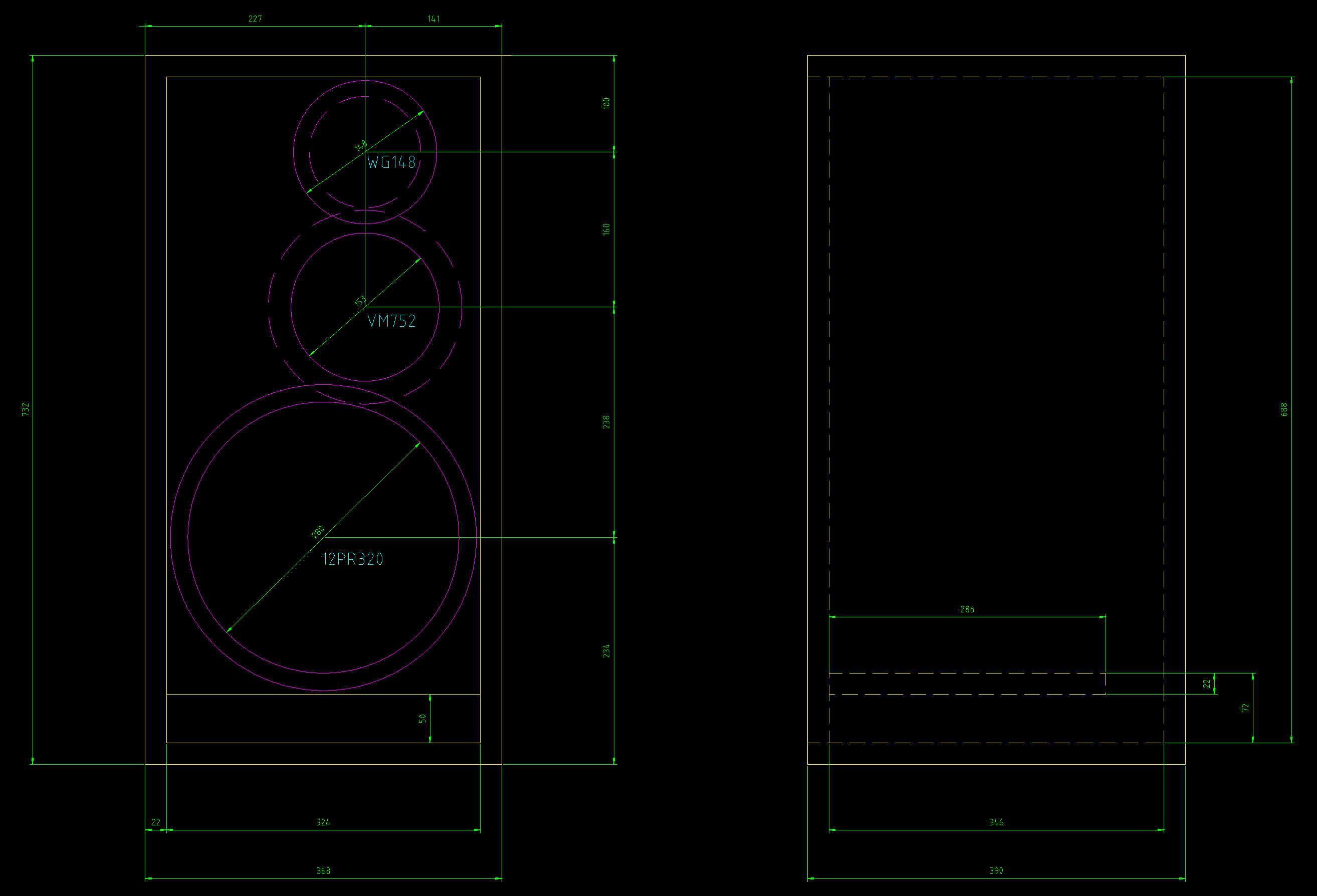

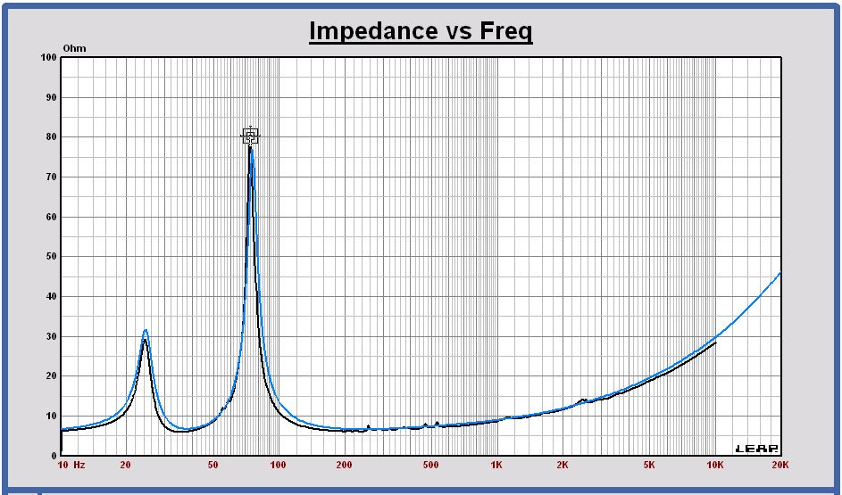

Ok, I built the Coffin just like you suggested and put all the drivers in. No damping material at all for the moment. Here's the impedance curve (plot and data file).
Tuning frequency is about 34.5 Hz (a bit lower than what we aimed for?). Should we try a shorter port? I guess the "corner" at the bottom/rear of the speaker is acting as part of the port as it is now, so the port is effectively quite a bit longer than one might think.
Impedance minimum is 5.9 Ohm (between the two main peaks). Almost within the "8 Ohm" rating (6.4 Ohm = 80% of 8 Ohm would be the generally accepted limit for for an "8 Ohm" rating). This will improve further once we add the x-over.
There are some wiggles at 55 Hz, 58 Hz, 257 Hz, 354 Hz, 375 Hz, 390 Hz, 468 Hz, 531 Hz and higher up, which might point at some internal resonances in the box. We'll have to take a look at those.
Edit: added an updated drawing of the Monkey Coffin box to show the dimensions.

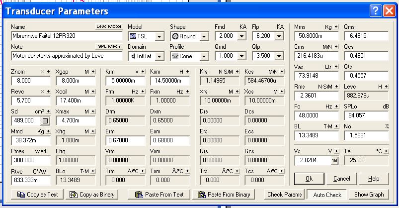

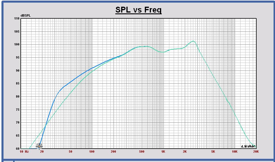

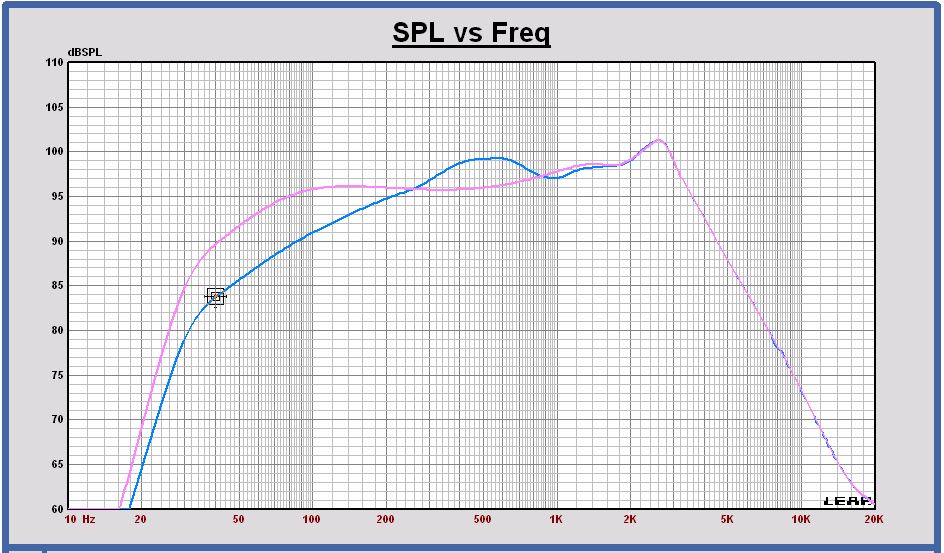

After some trials, I realized a reasonable good fitting of the basreflex system in Leap on the measured impedance. But I had to increase fs of the driver to 48 Hz. Otherwise it is not possible to become the wanted impedance. Qes and Vas get other values too, conform this higher fs (see attach).
The parameters I use in the Leap basreflex model are:
- Cabinet volume excl. port Vb = 69 L
- Filling cabinet: no
- Port length: 39 cm
- Filling port: no
- Tuning frequency fB = 37 Hz
- Fs = 48 Hz

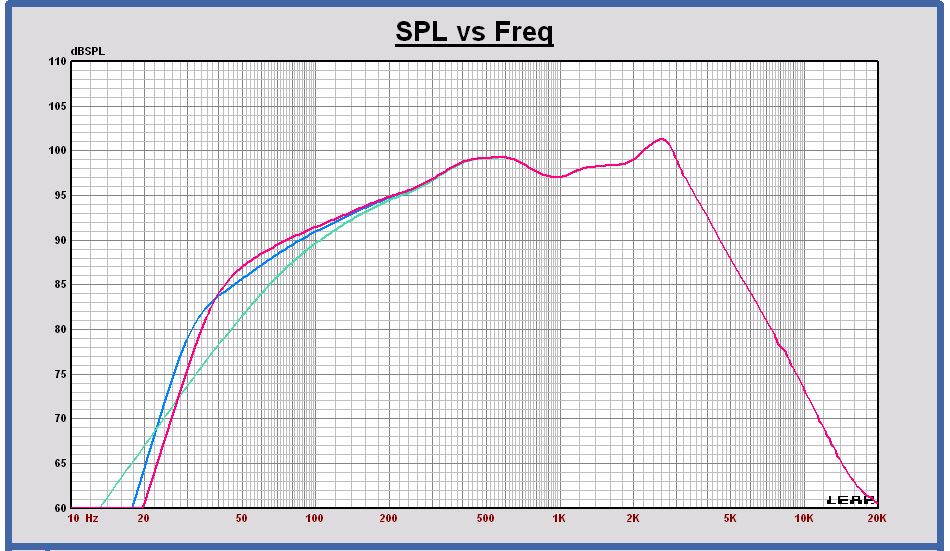

In first plot, impedance measured (black) versus simulated (blue).
In second plot, SPL in cabinet infinite baffle (pink) versus in cabinet free space (blue).
SPL is conform the impedance fitting on the impedance measurement.
In third plot, SPL in cabinet with SPL correction added above 400 Hz (out of datasheet SPL). This curve is to be expected as full space response in an anechoic room.
With this free space SPL response a speaker can be designed with a 90 dB sensitivity free space 1m 2.83V, with F3 = 57.6 Hz and F6 = 40.9 Hz.
As a conclusion now, it is possible that the basreflex system model in Leap isn’t exactly correct, but the combination driver – cabinet settings is correct. As the impedance response of the model is conform the measurement, the SPL will be also and both can be used to compare with the SPL measurements and for further X-over design.
Maybe checking fs in free air again?
The reason I do this kind of work now in the Leap simulation is to create low frequency SPL responses as accurate as possible that can be spliced with "in cabinet" SPL measurements around 400 - 600 Hz to become good free space SPL responses for X-over design.
I have very good experience with this way of working for closed box systems. Basreflex is more complex, but it must be possible too.

There's a limit to how much one can conform to the originally desired impedance, while at the same time taking into account all the other limits of the design. I would like to say: Whatever we get now is "good enough", especially considering it is also "close enough" on all other pre decided design limitations. No need for further optimization in regards to FS/impedance IMO, maybe except higher tuning freq but that is up to each builder to decide.

Paul, this port tuning should be very similar to closed box in some ways. I expect some (audible but lower) output to just under 30hz.
WYSIWYG
Hi Kaffimann,
Still some difference versus closed box (green) for this basreflex setting (blue). But remark, for this driver in this cabinet with a closed box, Qtc is around 0.55.
This basreflex is more damped than a B4. In second plot B4 response added (red) with tuning frequency = 43 Hz (port length 26 cm)
Yes, it is a personal choice of the builder which one to use. My personal choice is the actual setting. 🙂
I messed around a bit with AJ horn. I found that adding a little bit of damping to the bass reflex port decreases the size of the impedance peaks, whereby the lower peak is affected more. While there is no damping material in the actual build, I guess there is a bit of damping due to high air flow and turbulence, especially at low frequencies. I don't think the model tools account for turbulent losses, which would explain why the model tools don't provide an accurate fit to the observed impedance curve.
If I don't change fs of the driver from 43.1 to 48 Hz, the frequency of the lower peak doesn't fit correct or has a lower Q factor while the upper peak fits. So I am wondering after a long period of burning in your driver, if the fs isn't increased again? It really looks like that in my simulation. Or temperature in your measurement room is not the same?
For sure the model tools will give deviations, I believe that, but the difference I see in Leap with fs = 43 Hz is too large.
Edit: It isn't a problem if a good fitting cannot be realized with fs = 43 Hz. If an impedance fit is realized with fs = 48 Hz, a correct SPL is obtained. That one can be used for further design, together with the measured impedance.
