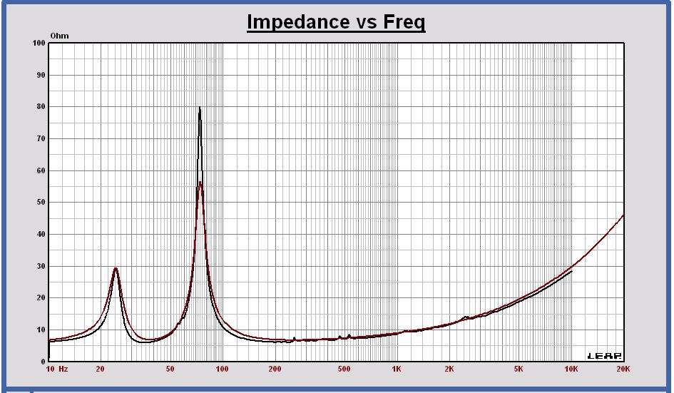

I did some more trials to fit the simulated impedance in the best way on your basreflex impedance measurement. I only get good fitting results if I increase the fs of the driver to 46 Hz. Otherwise the frequency tops are not at the right place.
If possible, can you do the free air impedance measurement again one time.
For me it is interesting to check the accuraccy of my simulation model, also to obtain the correct low frequency SPL.
In attach the current driver model used for simulation.
The driver is mounted in the box, with the rear wall on. I might take the driver out at some later stage and repeat the free-air measurement. However, I am pretty sure your assumption of a higher fs for your model is indeed correct. The impedance measurements of the box were done in my cold workshop, and we have already learned that the fs of the cold driver is quite a bit higher at these low temperatures (up to 48 Hz).

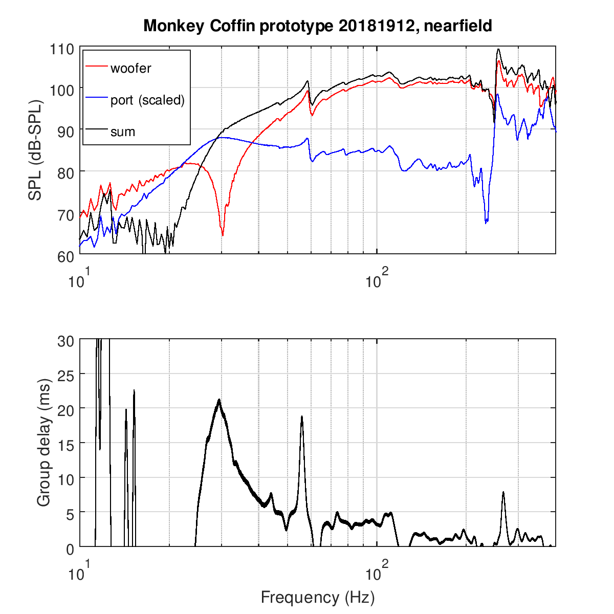

The microphone finally arrived! It's an Earthworks M23, so I guess I don't have to worry about old microphones with fishy specs anymore.
I made a few nearfield measurements of the woofer and the port with my current prototype box (see drawing in post 346, I call it the 20181219 prototype from now on).
The measurements and data processing were as follows:
  • Measure impulse response in the nearfield of the woofer or the port.
  • Apply gating time of 1 second to obtain full low-frequency response down to 1 Hz
  • Scale the port impulse response by the ratio Sp/Sd, where Sp is the port area and Sd is the effective cone area of the woofer
  • Calculate summed response by adding the impulse responses of the woofer and the port (scaled).
  • Determine the nearfield SPL response curves of the woofer, port and summed response.
  • Apply smoothing (1/6th octave) to the summed response and calculate group delay from this.
The results are shown in the attachment. Please ignore the artefacts at about 58 Hz, 120 Hz and 260 Hz (room modes).
Port tuning frequency is 30 Hz, much lower than the 40 Hz I get from modelling the 20181219 prototype box with AJ Horn. Group delay is 7 ms at 40 Hz, and peaks at the port tuning frequency, where the summed SPL curve kinks. I guess I'd like to make the port tuning frequency a bit higher to increase the SPL between 30 to 50 Hz, and to get a smoother kink in the SPL curve (and hence even less group delay).
What do you think?
P.S.: These measurements were done in my cold workshop, so the woofer suspension is a bit stiffer than at normal room temperatures (see earlier posts). To test the effect of this, I repeated the measurements after warming the surround of the woofer with a heat gun. The acoustic results were almost the same, so no reason to worry about this too much.

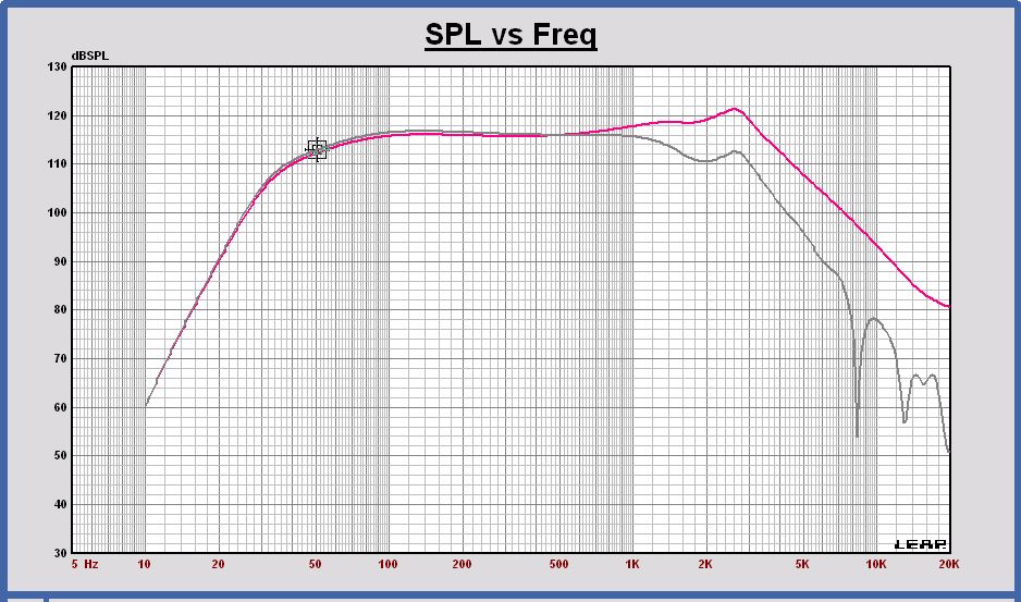

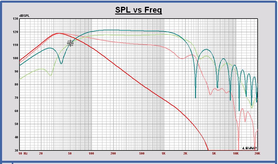

Matthias,
For sure you have crosstalk between your port and driver measurements.
The SPL fall off of a port is 12dB per octave above the tuning frequency fB.
In your port measurement it is much less because of driver crosstalk.
Look in attach to the nearfield responses in Leap.
In dark color are the calculated driver and port responses, standard done by Leap. They are correct.
In light color, if I place the microphone close to port and driver and measure SPL. These measurements in Leap become close to your measurements.
Remark the nearfield driver SPL dip below 30 Hz also, instead of the 38 Hz which is correct.
You cannot measure this in a good way, because of the SPL crosstalk.

Matthias,
Oh, man, you told me about this already a few days ago, and now I still do this stupid mistake. Oh well.
I tried reducing the crosstalk by sticking the microphone into the port. This helps, but the slope is still less than 12 dB/octave. Also, I can't avoid the crosstalk from the port to the woofer anyway.

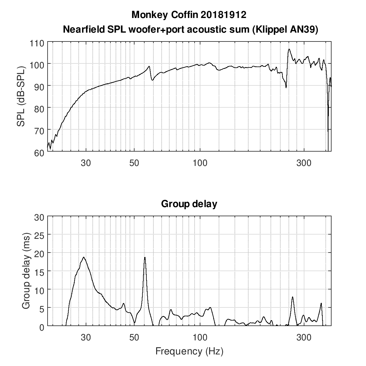

I tried the nearfield setup as described in the Klippel application note AN39 (page 2): put the microphone somewhere between the woofer and the port and move it around until you get a suck-out at a very low frequency below the port tuning. That's where the woofer and port output are out of phase by 180°, so the acoustic sum at this position is theoretically what we're looking for. What do you guys think about this method?

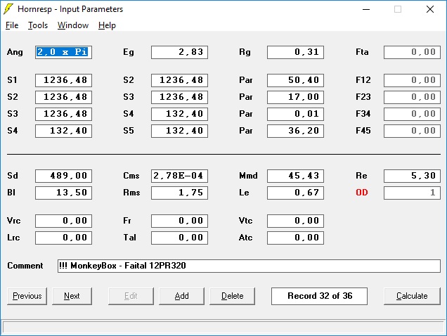

Your measurements seem compareable to the hornresp sim.
Can you show your Hornresp setup for the Monkey Coffin? I'd like to have a play with it.

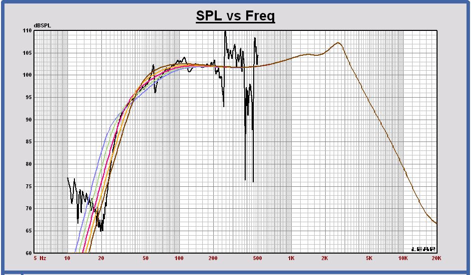

In my simulation the port is tuned at 37 Hz ... it cannot be measured exactly by the SPL dip neither by the impedance dip, if the port is positioned close to the driver and there is some phase shift caused by the voice coil inductance. You have to measure the excursion dip 🙂.
I just did that. The excursion dip is between 34 and 35 Hz. Pretty much consistent with the tuning frequency of 34.5 Hz suggested by the impedance curve in post 346.
The excursion dip is actually pretty easy to measure. Hook up the test amp to a sine generator and mount a little stick or similar very close to the dust cap. Turn up the drive voltage until you hear the dust cap buzzing on the stick, change the frequency until the buzzing stops, and turn up the volume to bring the buzzing back at this lower excursion frequency. Repeat this until you found the frequency of the excursion minimum.
Very good idea Matthias to measure the excursion that way. I think this is the most accurate method to measure the tuning frequency, but it shows that the impedance dip can also be used in this case. The phase shift caused by the voice coil inductance at fB is minimal for this woofer.
In Leap the minimum impedance value is 38 Hz. It is caused by a different impedance shape of the port peak. In the plot the black curve is the measurement. For some reason I don't understand, the Q factor of the measured port is higher than the model in Leap.
I think the fit is accurate enough to make a low frequency SPL curve.

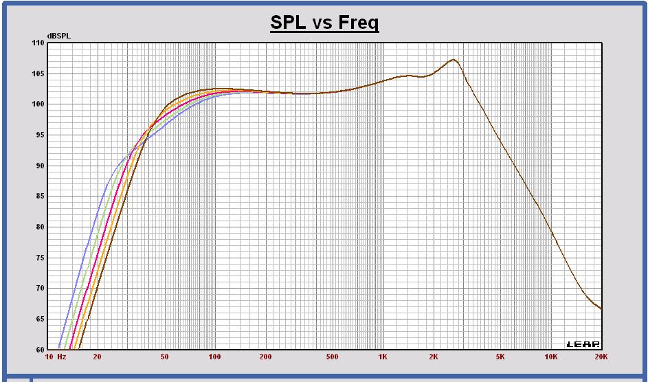

I also looked to the SPL for different tuning frequencies.
For the red curve, fB = 38 Hz. The other tuning frequencies are 30, 34, 42 and 46 Hz.
fB = 46 Hz is very close to a B4 basreflex alignment.
The red SPL curve matches the best with the current (measured) impedance response.
Edit: the SPL curves are infinite baffle responses, woofer placed in basreflex.

... And the sim that looks to be the closest is with a smaller port (132 mm2), but even that does not drop so fast... Could it be temperature related? Cold air is denser, no?

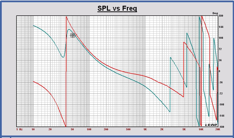

For some understanding, in attach the phase of the port and driver nearfield SPL response, driver in green.
To measure the nearfield sum, you have to move the microphone until the SPL dip below the tuning frequency disappears at very low frequencies. Futher moving in the port direction, the SPL will increase at very low frequencies. But you have to stop already moving at the point where the SPL is minimum at very low frequencies, for example at 10 Hz in this case. That is the point to measure the sum and this SPL is equal to the scaled infinite baffle response up to a few hundred Hz.
I did it in Leap. In the plot you see the nearfield sum vs. the scaled farfield sum in Leap, nearfield in grey.
Maybe give it a trial, it should be very nice if this should work in practice.
That's exactly how I understand the Klippel AN39 note, and that's how I did the measurement. Results are attached (plot and data file). Again, ignore the artefacts caused by room modes.

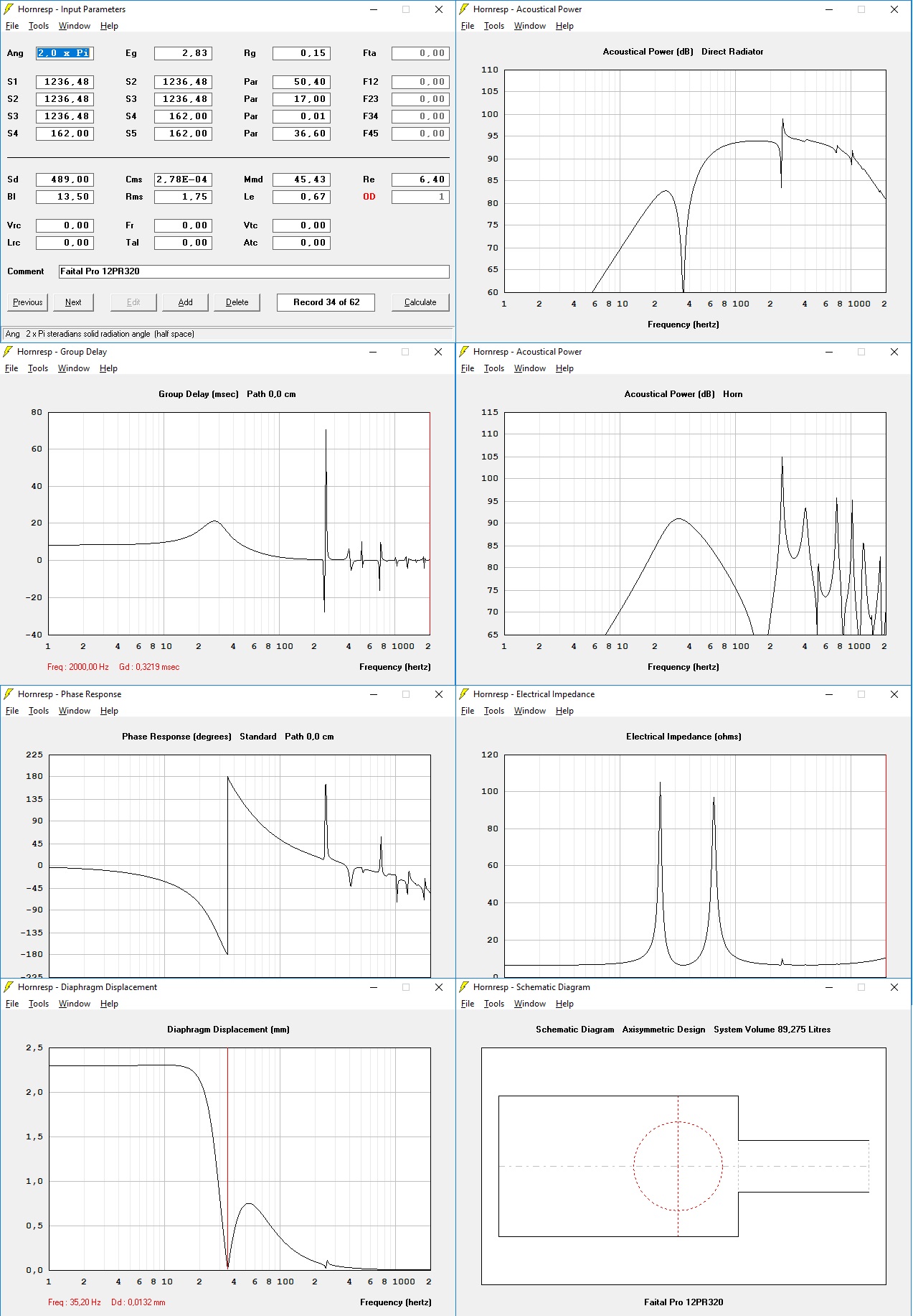

I played around with Hornresp. Yes, the GD peak shifts to higher frequencies if a higher tuning frequency is used. But the peak is not as high in my case. It really depends on how sharp the kink is.

Forget about my earlier attempt at summing the woofer and port nearfield responses. The crossover between the two measurements just screws up everything. I hope the Klippel method gives more useful results.
Looking in the plot you can see the best fit is on the 38 Hz tuning (red), that is the one which matches the best with the measured impedance.
I see a SPL dip at 20 Hz in the nearfield measurement, microphone a very very little bit lower 🙂.
I find this an excellent comparison result! And a good method to measure low frequency response and check with simulation.
Edit: Based on these results, I think I can use the low frequency Leap simulation for final SPL curves.

Here you see what I get from the sim if I enter the exact numbers of your prototype, with 162 mm2 port.
Edit:
Tuning freq is mid 30hz range, it is just that the port output the way its built will be useful a bit lower than usual. IE below acoustic impedance peak.
