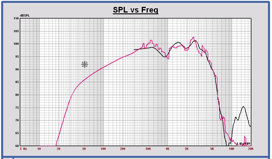

Take a FFT window of 30 ms for example. Just to see if there is a low frequency SPL improvement.
In attach the simulation (red) vs. the measurement + 1.5 dB (black) for midrange and woofer.
But where to splice, especially for the midrange. It looks like there is a lot of smoothing due to the 6 ms FFT window. But not sure of that...
Indeed the simulation fits well, just that bafflestep issue, I have to solve that.

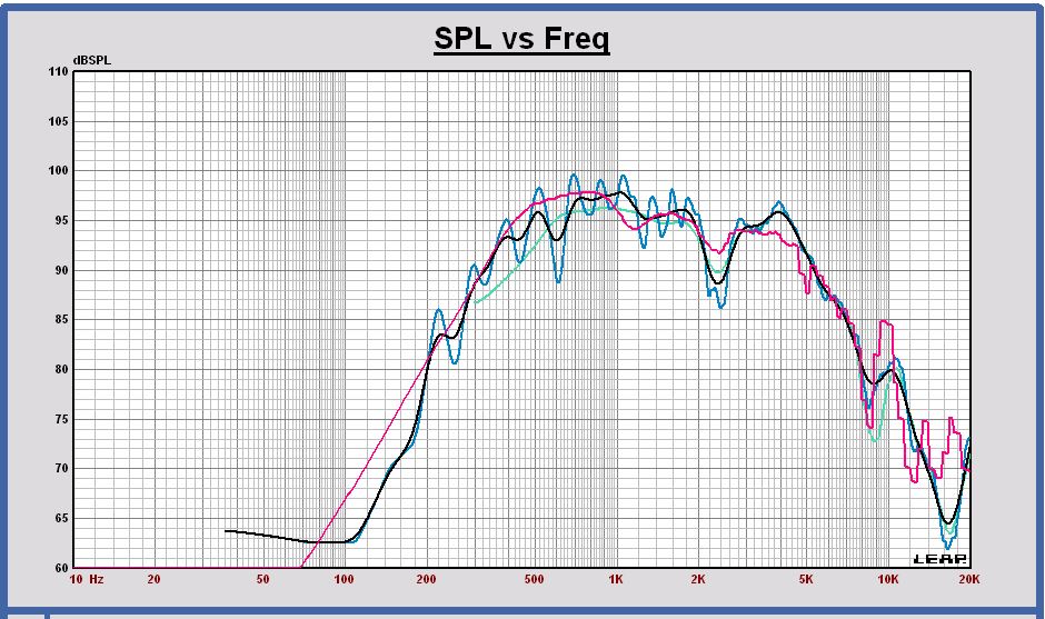

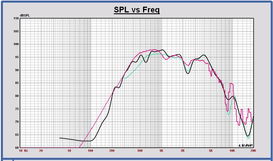

Yes, the time gating smears out the information at the low end. Here's a ZIP with SPL curves from a 30 ms gate time, with different smoothing.
Much better! We come closer and closer to the simulation.
Look in the plot, simulation in red, 6ms gate time in green and 30ms gate time and extra smoothed in black. I have applied two times 1/4 octave extra smoothing in Leap.
All the different smoothing versions you posted have exactly the same SPL, strange...In the second plot I have added it in blue.
You see a SPL dip at 600 Hz which is not in the simulation. Maybe caused by the concave woofer cone very close to the midrange, which is not in the simulation.
I think all can be further improved maybe by a even longer FFT window. Till now I cannot read the impulse response in Leap. I'll look for that later.
If you will do now Matthias with the longest gate time with best SPL results. And no smoothing, I can do that in Leap for the best result.

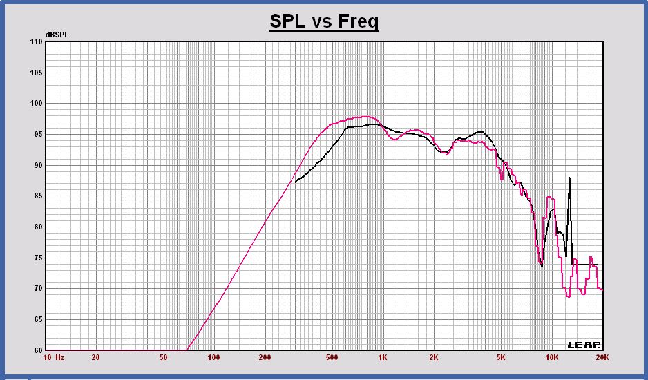

Ok, I exported the FRDs without any smoothing and taking the full length of the data in the TMD files (100 ms), for the tweeter, midrange and woofer.
Becoming ok now. I have only applied a 1/12 octave smoothing now.
I hope reflections are averaged out, it looks like.
Splicing can be done at 240 Hz if we are sure of this SPL response? I think it is...

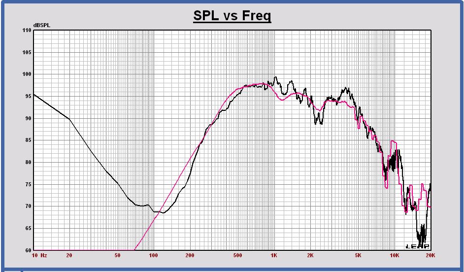

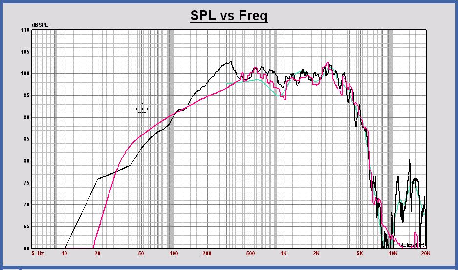

Same for woofer.
Simulation in red, FFT 100ms 1/12 octave smoothed in black, FFT 6ms smoothed in green.
To be sure of this way of processing we should be able to do a cross check with an anechoic measurement. This is the first time I try it this way, I have always used outdoor measurements for my own projects.
I am wondering if we don't add some random noise to the measurement, because reflections are not averaged perfectly.
But the fit on the simulation looks good, maybe the added noise is minimal.
What do you think?
Looking to the curves, for the woofer we can do splicing at 400 Hz.
Strange is the peak at 300 Hz, I don't understand exactly...
Same remark for the phase, no info above 1 kHz.

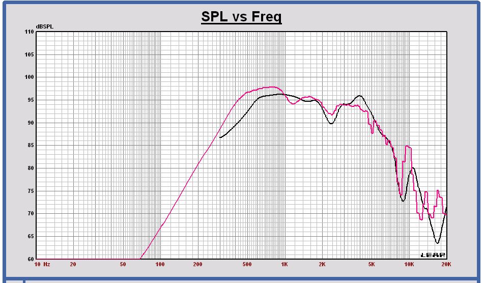

  • Faital 12PR320 in Monkey simulation vs FFT 100ms 12oct smoothed vs. FFT 6ms .JPG

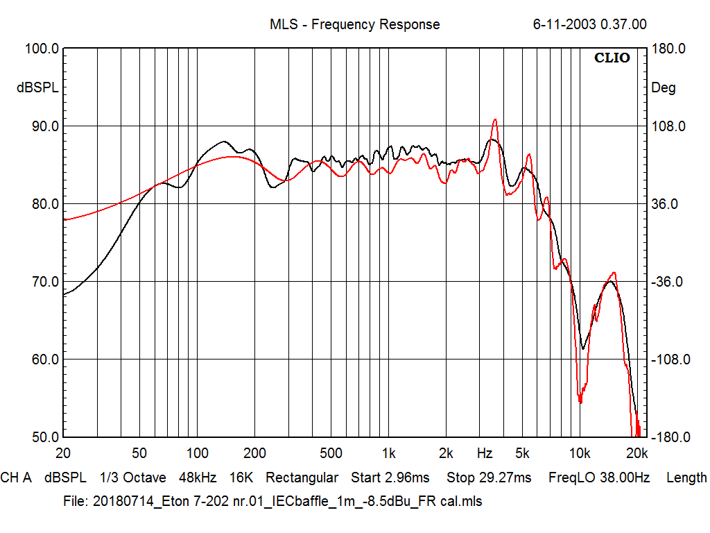

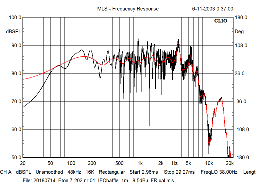

Look to what I see in the Clio system with an other SPL measurement.
In the first plot FFT 8ms without reflections and FFT 30 ms with reflections
In the second plot FFT 8 ms without reflections and FFT 30 ms with reflections and 1/3 octave smoothed.
You can see a SPL increase around 1 kHz in a wide band.
By adding random noise I mean the mean averaged value of the reflections during the gate time which is not zero.
And I see the same kind of SPL differences appearing in your measurements with longer gate time and smoothed.

Thinking about this longer. By increasing the gate time, the measurement becomes more and more a half plane measurement.
That can explain the SPL increase. But the ground reflections will affect also the SPL shape probably??

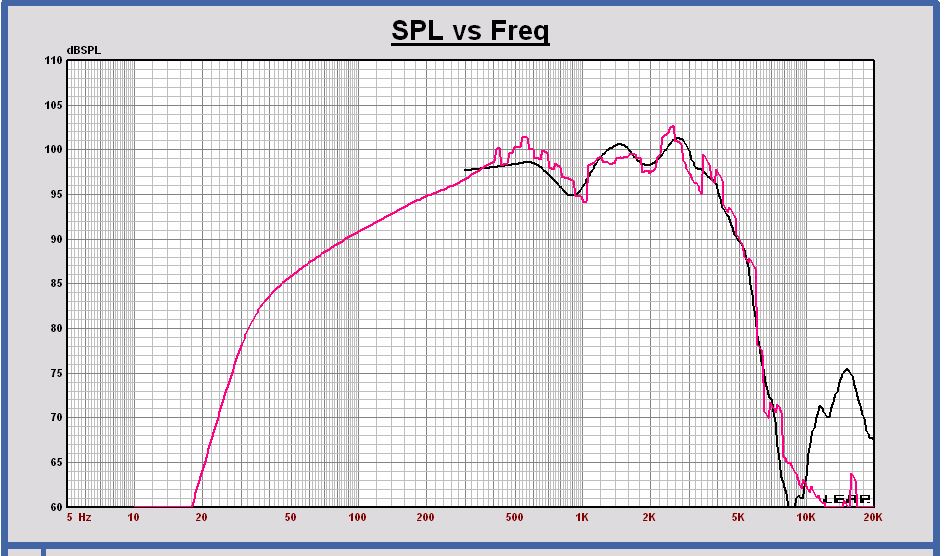

Matthias,
The problem I have is how to splice data and in a correct way. For this project I like to be sure of all that it is correct within 1 dB.
Look to the woofer and midrange plots, simulation in red and measurement +1.5 dB in black.
For the woofer a splice frequency at 350 Hz is ok I think.
But what about the midrange? That is my problem now.

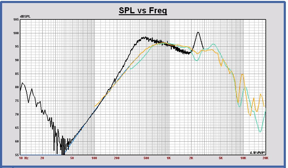

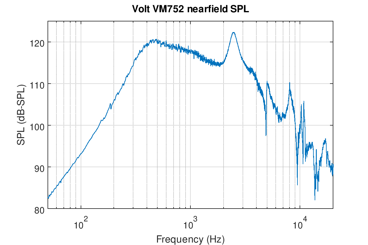

I guess an nearfield measurement of the midrange might be useful. Theory says that nearfield SPL curves work up to fMax = 5475/a, where a is the cone radius in cm. If this is correct, we'll get useful nearfield data up to about 1.5 kHz for the VM752. The waveguide might interfere with this a bit, but... I'll give it a try.
Edit: Done! Nearfield measurement of the VM752 is attached.
Here the nearfield measurement (scaled) in black, the infinte baffle response of datasheet in yellow (equal to Leap infinite baffle model) and the measurement in Monkey box in green.
I don't understand this, dome radiation looks complex...
Yes, a good test can be to simulate a 3 inch dome on the Monkey Box baffle with other bafflestep simulation software and apply on the current infinite baffle response (not the nearfield). And compare with measurement and Leap simulation.
attachment.php
This 5db+ peak at 2.5Khz ( present in the nearfield measurement ) disappears to differing degrees with other forms of measurements.
In fact it turns into a notch with most other measurements, which is interesting unto itself.
Does anyone else think that the peaks attenuation is controlled by the dimensions of the cavity built into that concave horn?
Smoothing out the horn cavity with modelling clay would be one way to find out.
I did use Jef Bagby baffle edge diffraction calculator for the Volt midrange in the Monkey Box baffle and compared with the Leap simulation.
Little difference but very comparable.
Edit: maybe we should splice data for the midrange at 1kHz for now?
And assuming the measurement with gate time of 6 ms has some smoothing effects below 1 kHz?
