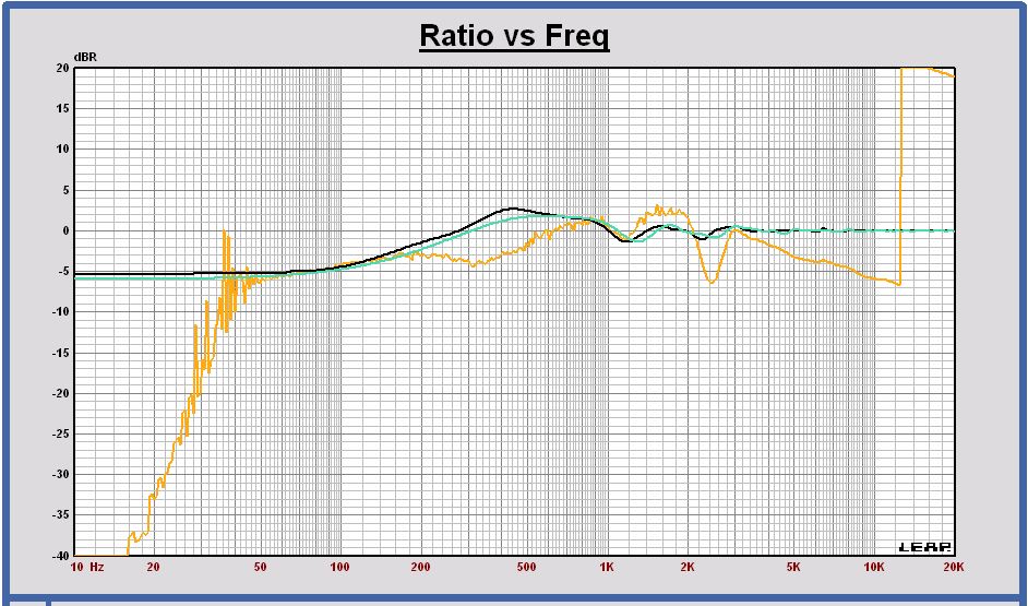

I have calculated the bafflesteps with three SPL curves and the Bagby one:
- nearfield measured (black)
- infinite baffle Leap, model based on measured TSP (no frequency response correction applied at high frequencies) (pink)
- in cabinet Leap, model based on measured TSP (no frequency response correction applied at high frequencies) (blue)
The nearfield response scaled to be equal to the Leap infinite baffle response for low frequencies.
The bafflesteps:
- yellow = transfer SPL Leap in cabinet over SPL nearfield
- black = transfer SPL Leap in cabinet over Leap SPL infinite baffle
- green = Jeff Bagby

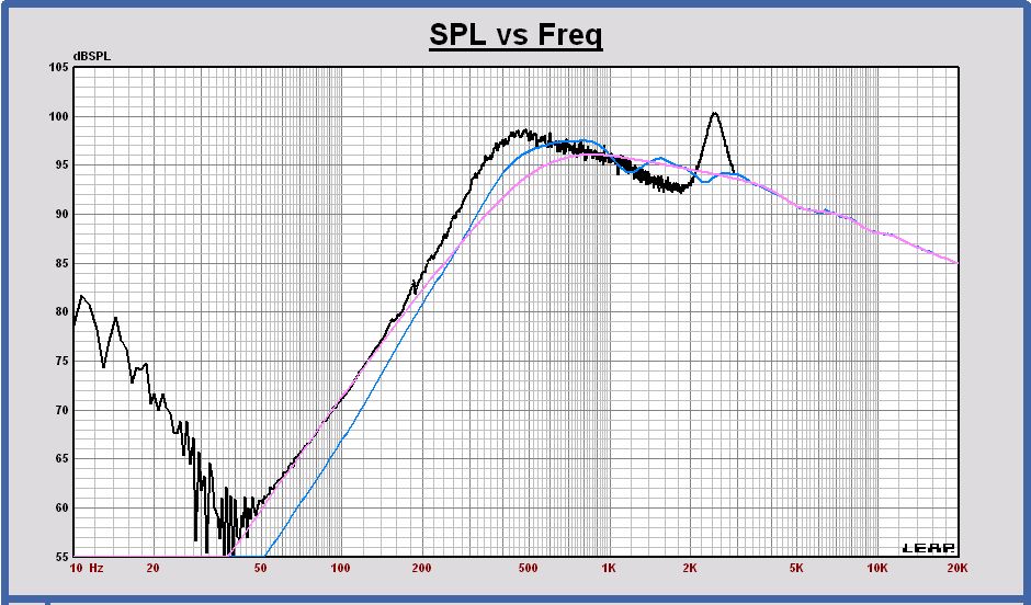

Ok, the yellow curve does not do the same thing as the "theory" curves. Either the theories are incomplete, or the dome/horn does indeed behave differently than conventional cones.
Theory: as far as I can tell, the baffle diffraction calculators assume "perfect" dispersion (spherical sound emission) to estimate how much sound hits the baffle edges. Is this really the case?
Dome/horn: as mentioned before, the nearfield 2.4 kHz peak is interesting, as this is a dip in the far field. I made a quick nearfield test with the microphone off-center (approximately in front of the dome surround), and the peak was almost gone. So yes, funny things do happen in the dome/horn system. Maybe such things also happen at around 400-500 Hz, and are confusing our view on the splicing. However, the wavelengths involved would be quite a bit larger than the horn, so I find it hard to believe that.
Splicing at 1 kHz might be the way to go (as suggested by Paul). However, I am not very experienced with splicing + modeling, so I leave it up to Paul and others to decide on a workable approach. Let me know if there's anything I could do in terms of measurements.
I agree that at lower frequencies the horn *should* be relatively ineffective. So pushing the splice to where the far field measurement cutoff is, is the way to go. You want to preserve the measured far field phase as low as possible.

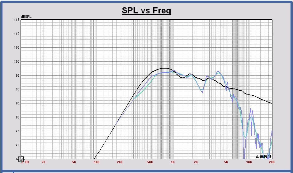

For the midrange I have done a SPL data splice of the Leap simulation and the measured curve.
Following steps:
- applied a minimum phase transform on the measured SPL
- compensated excess delay of measured phase to fit on minimum phase; compared both; minimum phase can be used.
- SPL data splice at 980 Hz
- minimum phase transform on data spliced curve to smooth little phase discontinuity at splice frequency.

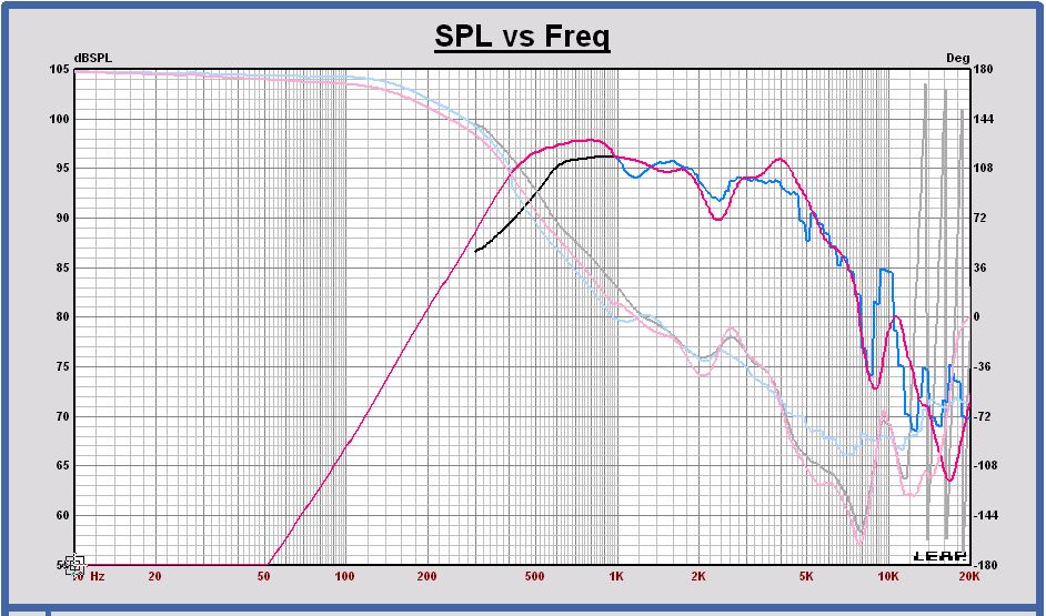

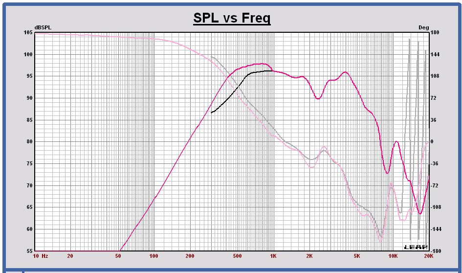

In first plot amplitude and phase of data spliced curve (red) and the measurement, excess delay compensated (black)
In the second plot with simulated curve added (blue) to see the way of splicing.
I don’t feel so good with the SPL difference of measurement and simulation below 1 kHz. The data spiced curve is conform the bafflestep simulation of Leap and Bagby. IMO we have to confirm this in some way. Outdoor measurement with longer FFT gate time? I hardly can believe the measurement is so much wrong.

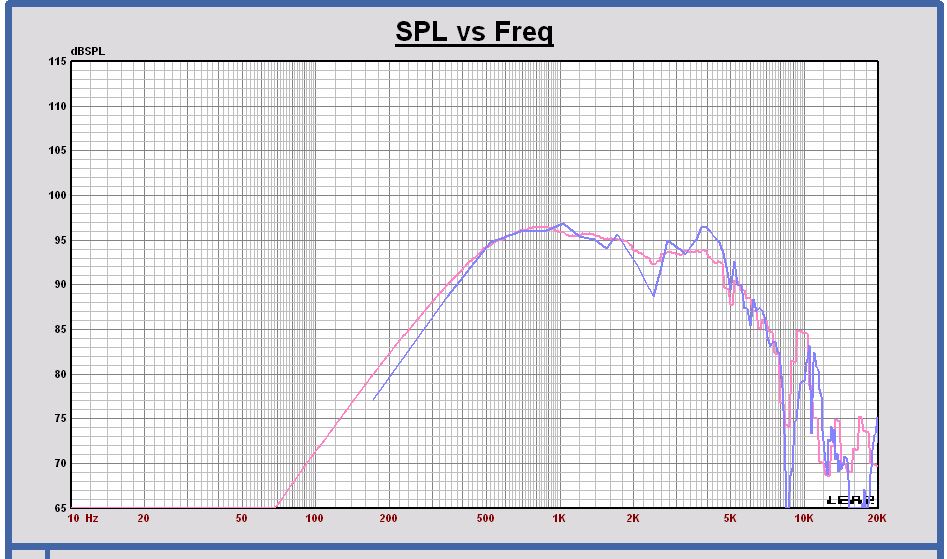

Comparing now in the plot, the in cabinet measurement (FFT with Leap) (blue) with the Volt infinite baffle model, based on measured TSP (pink).
I think this measurement is correct. The cone models used for bafflestep simulations are more directional around 500 to 1000 Hz. The 3 inch midrange dispersion is wider than the driver models. I am almost sure of that, Augerpro also mentioned this.
