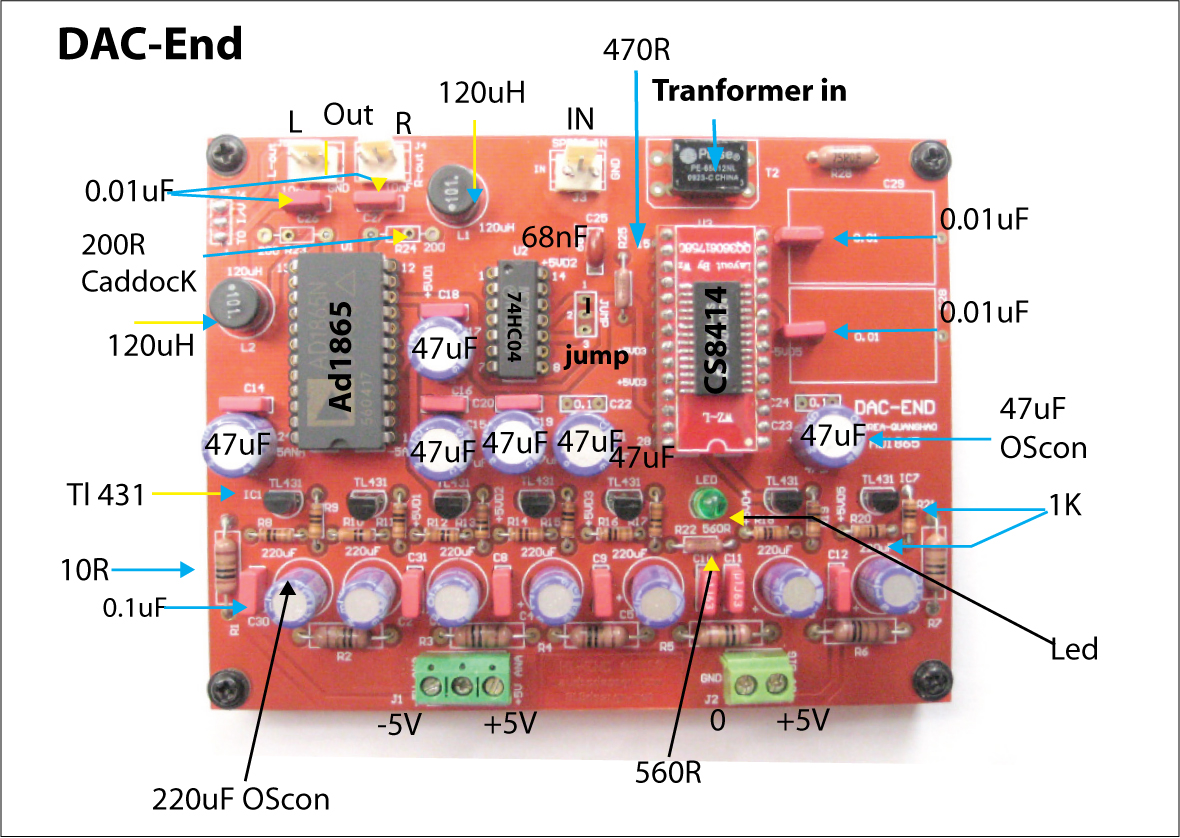

Got board today, thanks for this quick GB.
One observation on DAC PCB: There is no GND groundplane
Maybe it is not needed with DAC such AD1865
Anyway it matches Andrea Ciuffoli DAC prototype
To go on.
May i haved looked at A. Ciuffoli schematic before !!!
I don't understand few things :
- Why CS8414 pin 24 (M1) is connected to CS8414/AGND and not DGND
- Why using specific regulator (TL431) for CS8414 pin 18 which is M2
as M0 to M4 is to select CS8414 mode.
- Usually LC schematic is used for digital PS for proper decoupling, here there is no L used, is there any specific reason ?
Is there any specific tweak behind schematic used ?

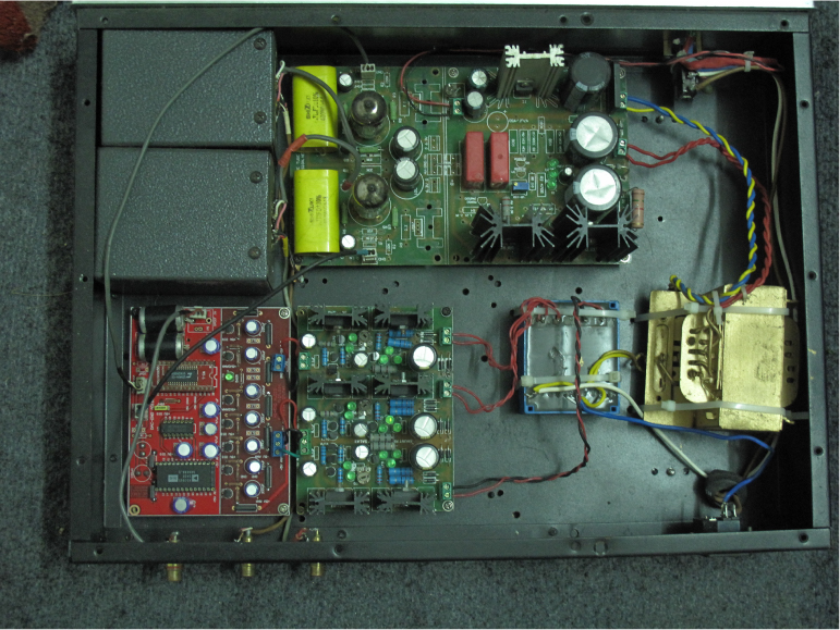

Hi Quang Hao,
you wrote that you´d use 6c45 as Valve.
But this is a mono-triode-Valve and the e182cc
has got double triodes.....what did you change in
circuit?
Also Andrea wrote that D3A could be used...well
this is a pentode.....how to implement this one?
Greetings Ulf
No! i dont change Cricuit of Andrea, I can by E182cc, D3a! I have 2 6c45, I used them!
You can see!

There is 3 small area behind the CS8414, the AD1865 and the 74Hcxx but not "wide enough" to form a large groundplane.
May be one complete layer could have been used to form the ground plane but may be difficult to route. But I haven't tried so i don't know if possible
It is on the top layer!
You can use L for R 10Ohm!
thank
How critical are the Sanyo Os-Con caps? Can't we just use something decent like Panasonic FC's?
in the Board DAC-end you do not use other Cap, only Sanyo Os-con! you can ask Andrea!
In the Salas shunt you can use other Cap! with one If you like!
You could, but I would say NO because Oscon is unique (special) cap and is the best for digital signal decoupling. On the analog though you could use something else like Elna Silmic for example.
Oscon SP is best for this purpose then SH.
Oscon SP around 220uF is easy to get from eBay while I cannot find the 47uF SP 16V
