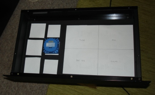

Power transformers - idea
In my project I will use the following 6 caged PCB potted transformers (easy to find, compact and doesn't look messy):
1) 30VA PCB toroid 240pri 9+9sec parallel connected to 2) 9+9 parallel to get 240VAC for HT. (PRI-SEC-SEC-PRI)
3) 30VA (same as 1) PCB toroid 240pri 9+9sec parallel for DC HEATER
4) 10VA PCB toroid 240pri 9+9sec parallel to SALAS DIGITAL
5) 10VA PCB toroid 240pri 9+9sec parallel to SALAS ANALOG +5
6) 10VA PCB toroid 240pri 9+9sec parallel to SALAS ANALOG -5

re 1) have you tried this before, i know a lot of people dont recomment it stating various issues.
also is 10va enough for the salas shunts? there are pretty inefficient. salas recommends 30va if i remember correctly.
As long as you respect the transformer voltages it is ok. There is a loss though by pumping back to the second transformer. If you use lower voltages on the second is bad, the transformer saturates, gets hot etc. But in this case I use identical transformer.
I'll let you know; tomorrow I try to load the transformers.

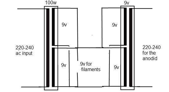

In any case use a 220:9+9 100w for the filaments and to drive a 9+9:220 50w to get also the 220V ac of anodic voltage is ok

Step 12: connect the first 9V secondary to the secondary of the second transformer as per the picture published by Audiodesign so you step up the voltage for the tube anodes.

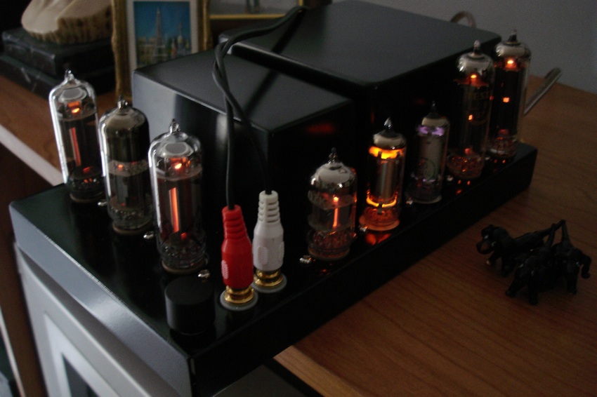

Example below of one I made for 280V, over 1400 turns!! For this little ding ding dong dong baby Single Ended 3W ampli, Lovely detailed sound
