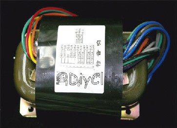

This 100VA Transformer can be suitable for the power stage (Tubes + Heater)
R80-36 primary (0-110) x 2 /SCN: scondary (260-230-0-230-260)(200mA), 2.5-0-2.5(3A), 3.15-0-3.15) X 2(3A)
Easy to get 8.15V for heater Series 2.5+2.5+(3.15parallel) :)
Available from diyclub.biz
DIYCLUB

Transformers
secondary 0-250V(50mA) X 2, it is Ok
0-7.5V(1A) X 2 it is not ok ( filament is min 3A)
you can fin other!
thank
I think I will go for this:
For Anode and Heaters:
For Salas Analog +5V -5V rails:
10VA PCB potted toroidal primary(0-120)x2 / SCN (0-9V 500mA) x2
For Salas Digital +5 rail:
R-Core and Toroidal transformers are similar: low leakage, low chances of noise. No EI transformers here for me.
