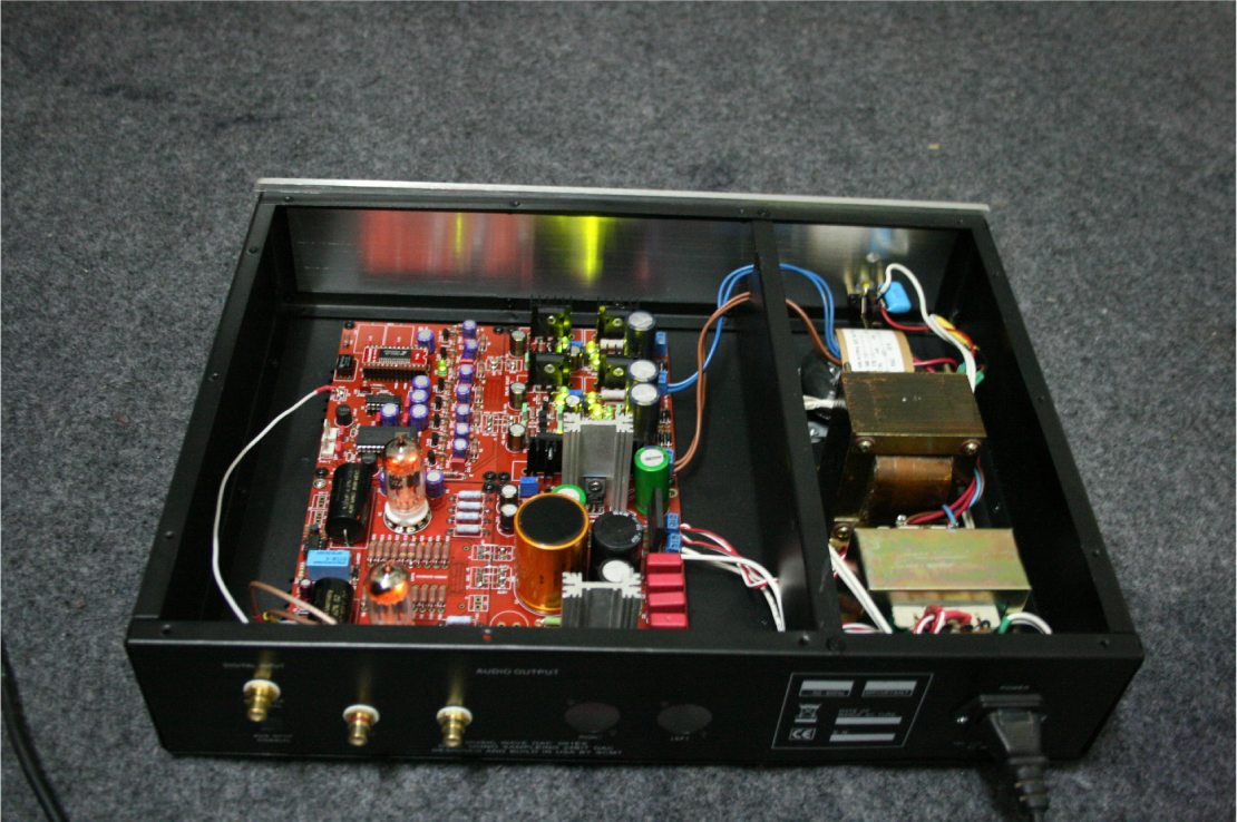

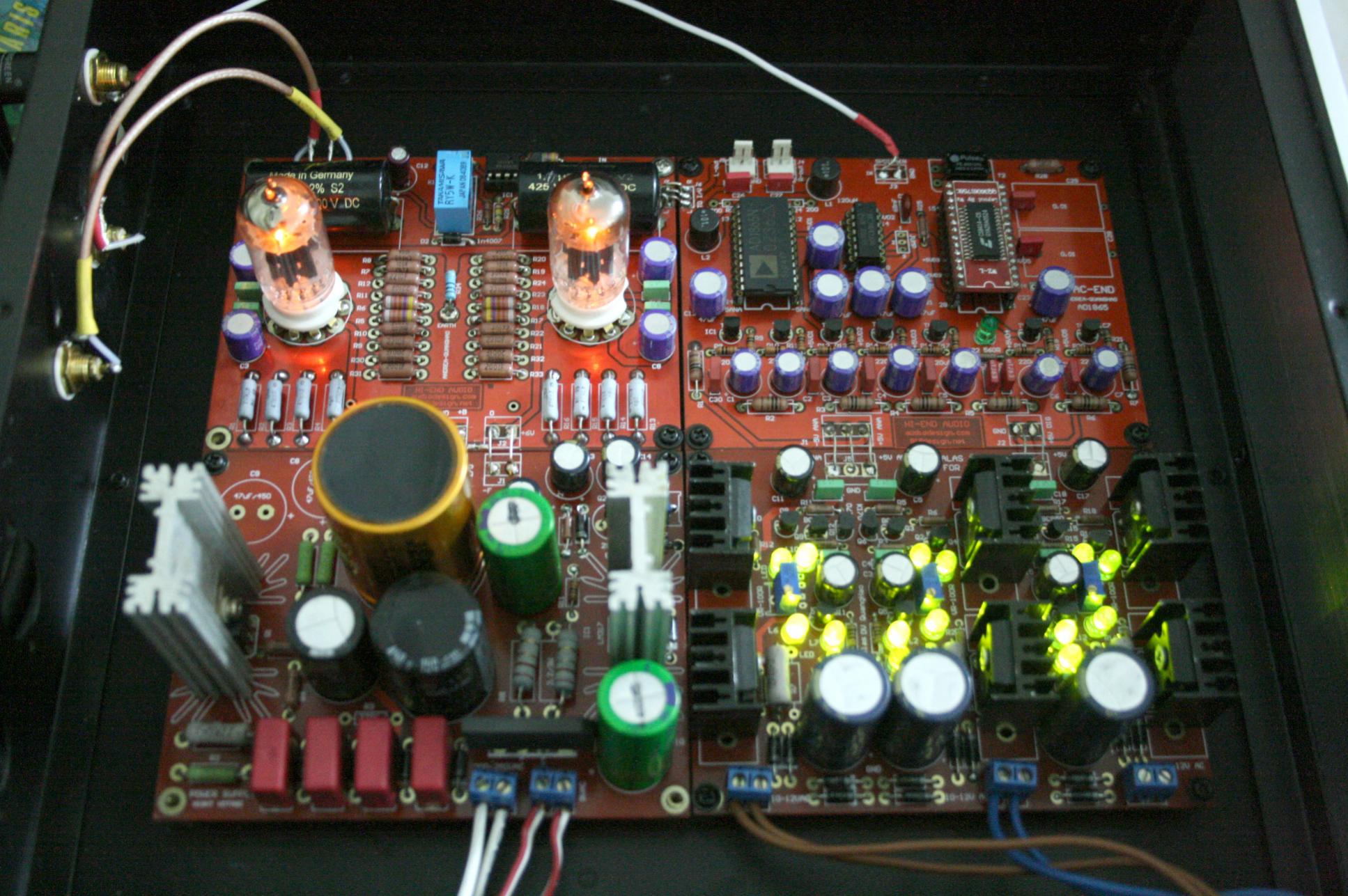

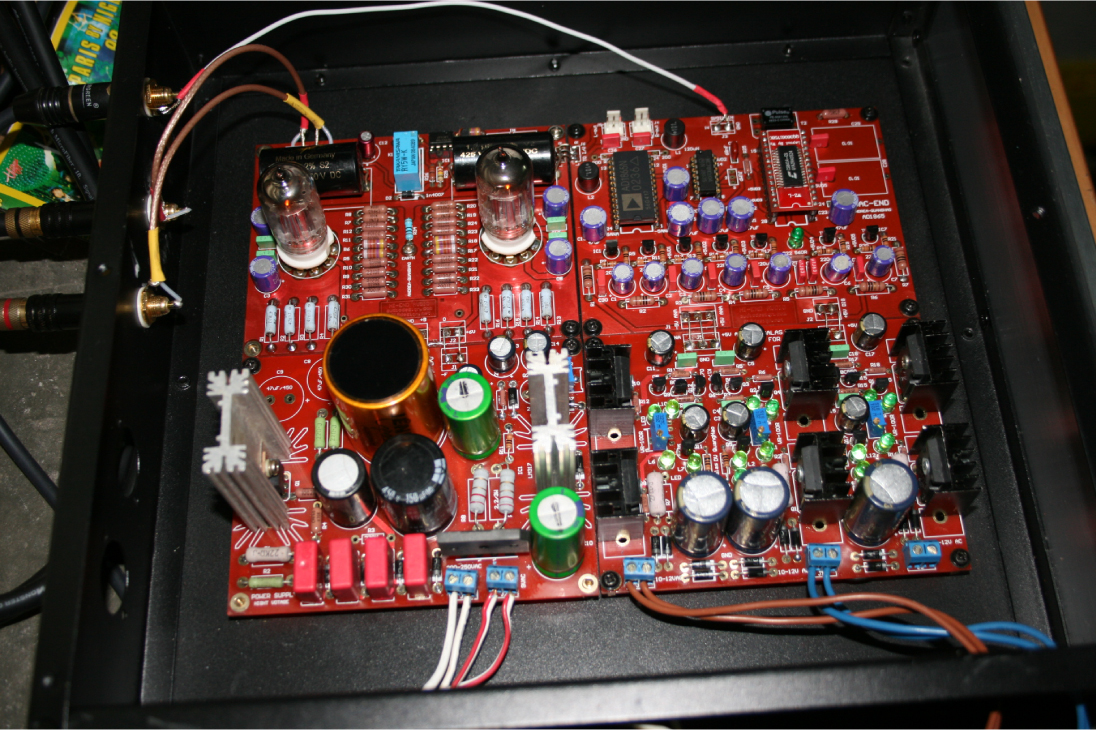

post 524 the salas reg is lit up on the right, yet from the pic no wire from transformer. Have you routed power from another salas reg under the boards?

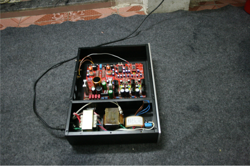

My choise about power supply transformers has been:
LS70-1 0-15X2(0.8A) 0-12X1(0.8A)
R80-55 0-9 X2 (3A),0-250(200mA)

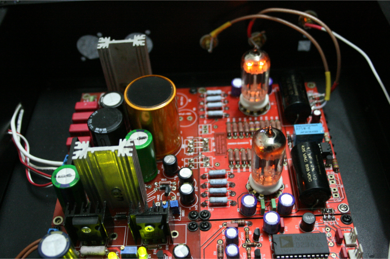

To get the best performance by this DAC project it is necessary use on DAC output module a 200ohm MK132 Caddock resistor.
How accurate that 200R is? Partsconnexion has only 220R.. Any other good sources for those?
RS componentsHow accurate that 200R is? Partsconnexion has only 220R.. Any other good sources for those?
I have these r-core on my table but I am still waitng the pcb to test the these transformers.
The 90% of sound depend by the 200 ohm resistor but are valid also value of 190 - 220 ohm.
If you cannot find the Caddock please use 2 x 390ohm 1% in parallel.
No! You can see in my Tranformer:
Out put:
1. AC=12 V conect to -5V
2.Ac= 12V conect to 2 x +5 v!
Two AC inputs of +5 v I shared a coil, and I must be under the welding
Thanks, thats what i meant by 'shared power'.
