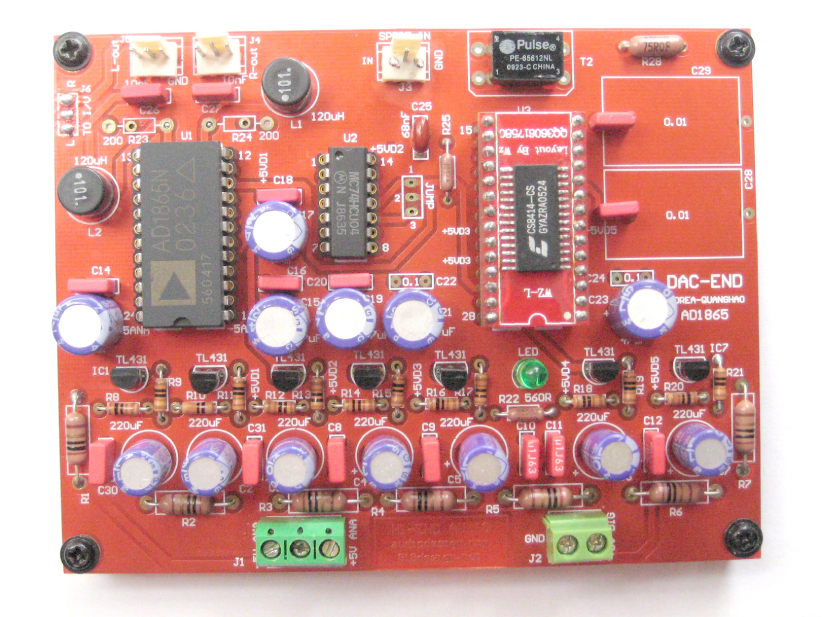

In the I/V tube PCB all the resitors lined up vertically in the centre between the tubes can be 1/2W. The BOM indicates 1/4W but better put 1/2W.

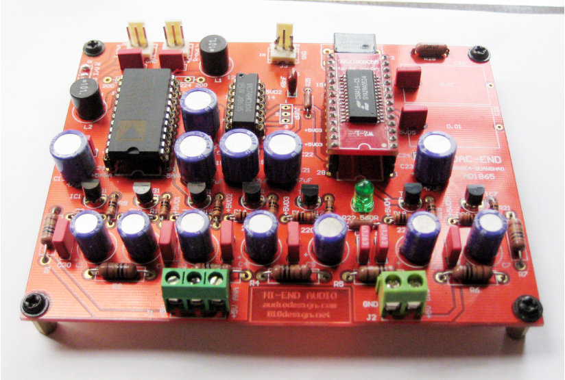

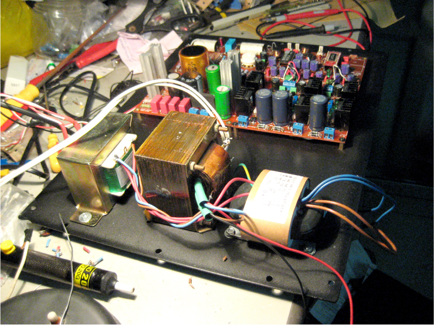

Hi all! I tested the all PCb of DAc-end is Ok!
The sound is good , near my Dac-end use out put tranformer sill, tube 6c45PI
There is one change about the filament of 5687!
Some image!
