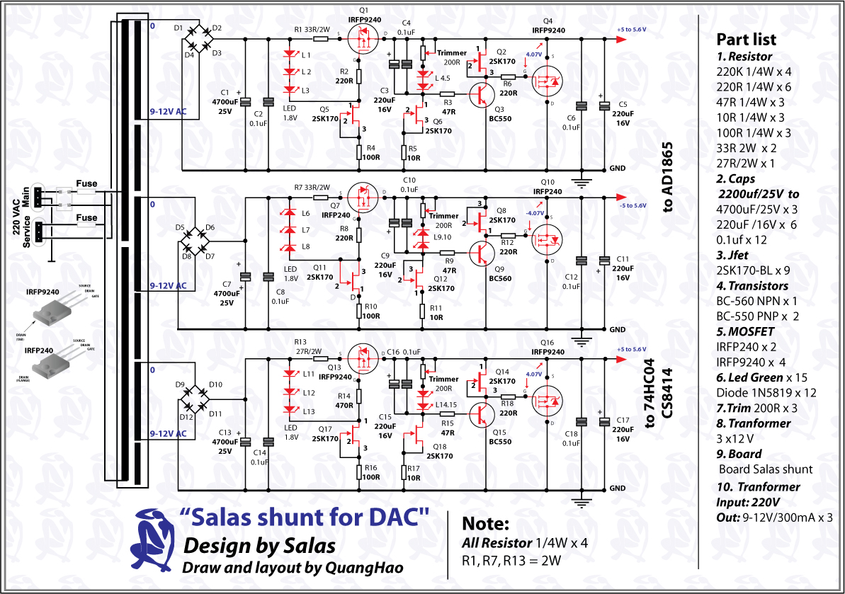

Hello Quanghao,
C1 and C7 are the Jensen 47+47uF 450V on the HV P/S board. Correct?
What is the correct value for R30,R31,R32,R33?
Schematic says 470K ???
PCB says 2K ???
You have soldered 2K on your board. Is it correct?
I don't understand that. Please clarify.
Where is R 1 K ???
In the Salas shunt Part List: first line 220K 1/4W x 4. Where are they? I can't find them.
R14 Salas shunt schematic should be 220R or 470R?
For the I/V stage are C1,C7, No need ( yes Sir)
R30,R31,R32,R33 need for this project!
PCB says 2K ???
It seems that the resistors are taken care of by the 200 ohm resistors on DAC board.
No after R 200 Ohm, we are have one filter ( chock and C 0.01 + R 1 K)
Where is R 1 K ???

To reduce the relay delay time at switch on will be changed the RC cell 220K 220uF on Lm311 with 220K 100uF

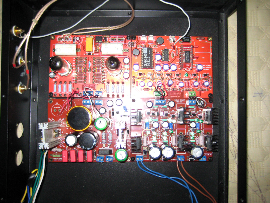

I have do some amendment to Quanghao BOM file. I just follow the figure on PCB photo post by quanghao and schematic by Andrea ciuffoli, I hope it might help some of us to finish the project much easy. Any mistake please let me i will amend it again. Thanks.

Thank you for posting this. I believe it matches what I have just finished compiling except for R34 on the IV board.The schematic shows a 10R resistor. (New ???)I have do some amendment to Quanghao BOM file. I just follow the figure on PCB photo post by quanghao and schematic by Andrea ciuffoli, I hope it might help some of us to finish the project much easy. Any mistake please let me i will amend it again. Thanks.

I am assuming that R30-R33 (2k) are needed when used with the DAC END 2. If I am wrong would someone please correct me.
I didn't see any R34 on IV board or 10R on IV schematic, can you specify it location?
It seen correct because the R30-R33 in schematic post by quanghao at #426 and on PCB both show 2K.
I just clicked onI didn't see any R34 on IV board or 10R on IV schematic, can you specify it location?
About DAC-END: DAC End 2 - the AD1865N-K with single ended vacuum output stage
At the bottom below R32 and R33 I see on the schematic R34=10R
Best
Bob
I see you used the output inductors whereas andrea did not. any reason?
IMO output chokes on the I/V stage, tybe and brand output capacitors on the tubes, PIO, WIMA Clarity whatever.. are all options available on this good project. It's up to the individual's taste to use the choke or not and the type of tube output capacitors.
At this point of the project you choose what is suitable to your own taste. Try, if you don't like it, change it.
IMO for example I would never put bad polyester cap in parallel with good electrolytic cap (Rifa+++, Silmic++) in series with the cathode of the tube. If someone wants I think it should be MKP. I just leave the elecrolytic alone.
I just clicked on
Best
Bob
😱Oh! I miss that one, yes R34=10R. Thanks.
