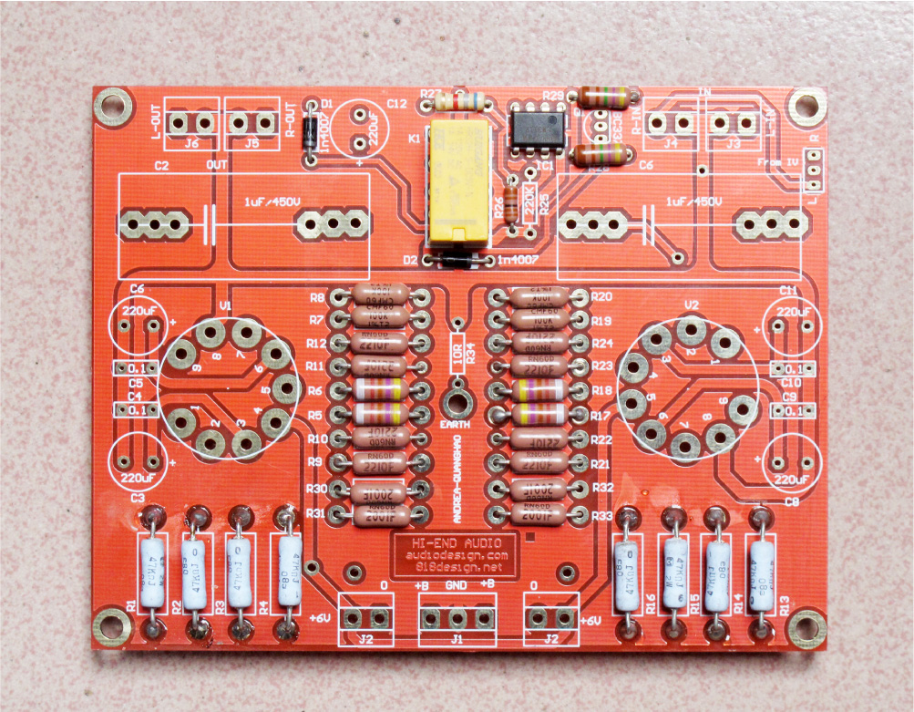

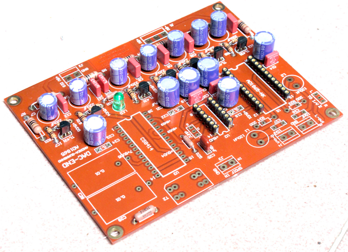

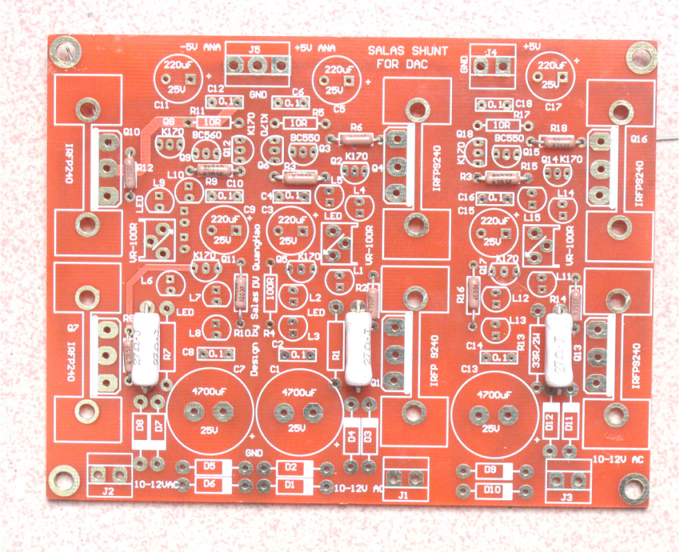

Some image ! i m doing make it!
please keep posting image DAC till it's complete

Transistors on Salas shunt
Part List error
BC - 550 is NPN and BC - 560 is PNP and not vice versa.
Part List error
