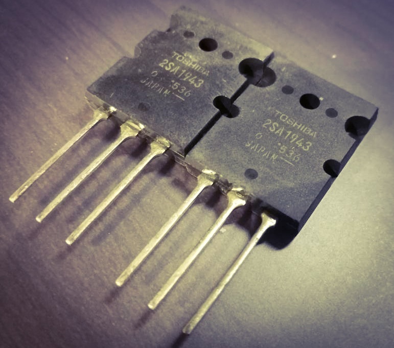

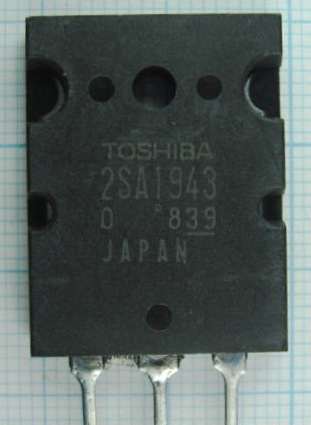

Edit: Photos of two versions, other country made good transistor and good made in Japan
Genuine

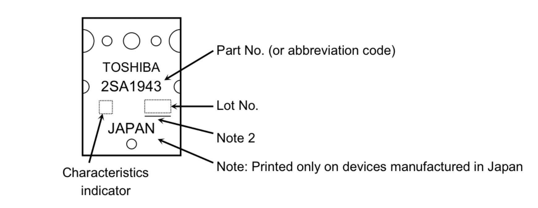

2SA1943
Those are suspect, wrong package for 2SA1943

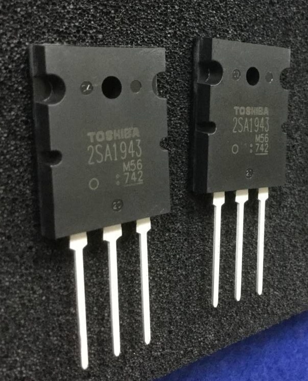

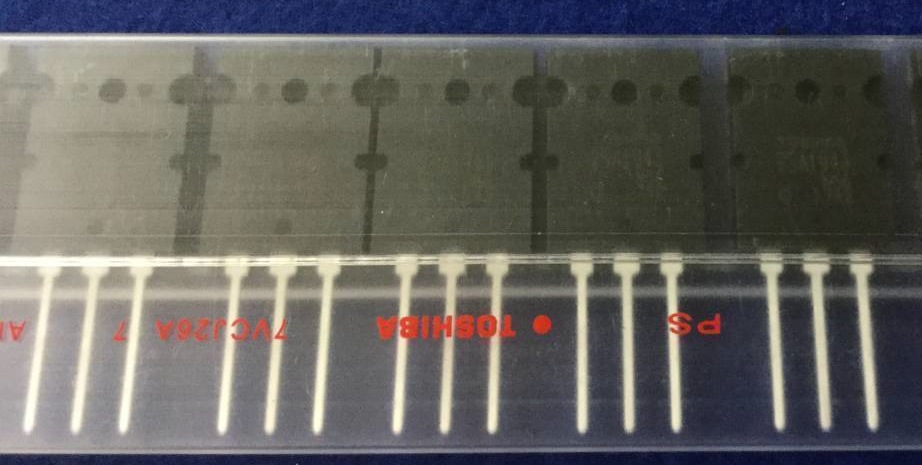

The ones I posted previously are from Mouser and they have it listed as a new item so Motorola must be putting them into TO-247 now.
I got a batch of the older package from Digikey so I have both now
