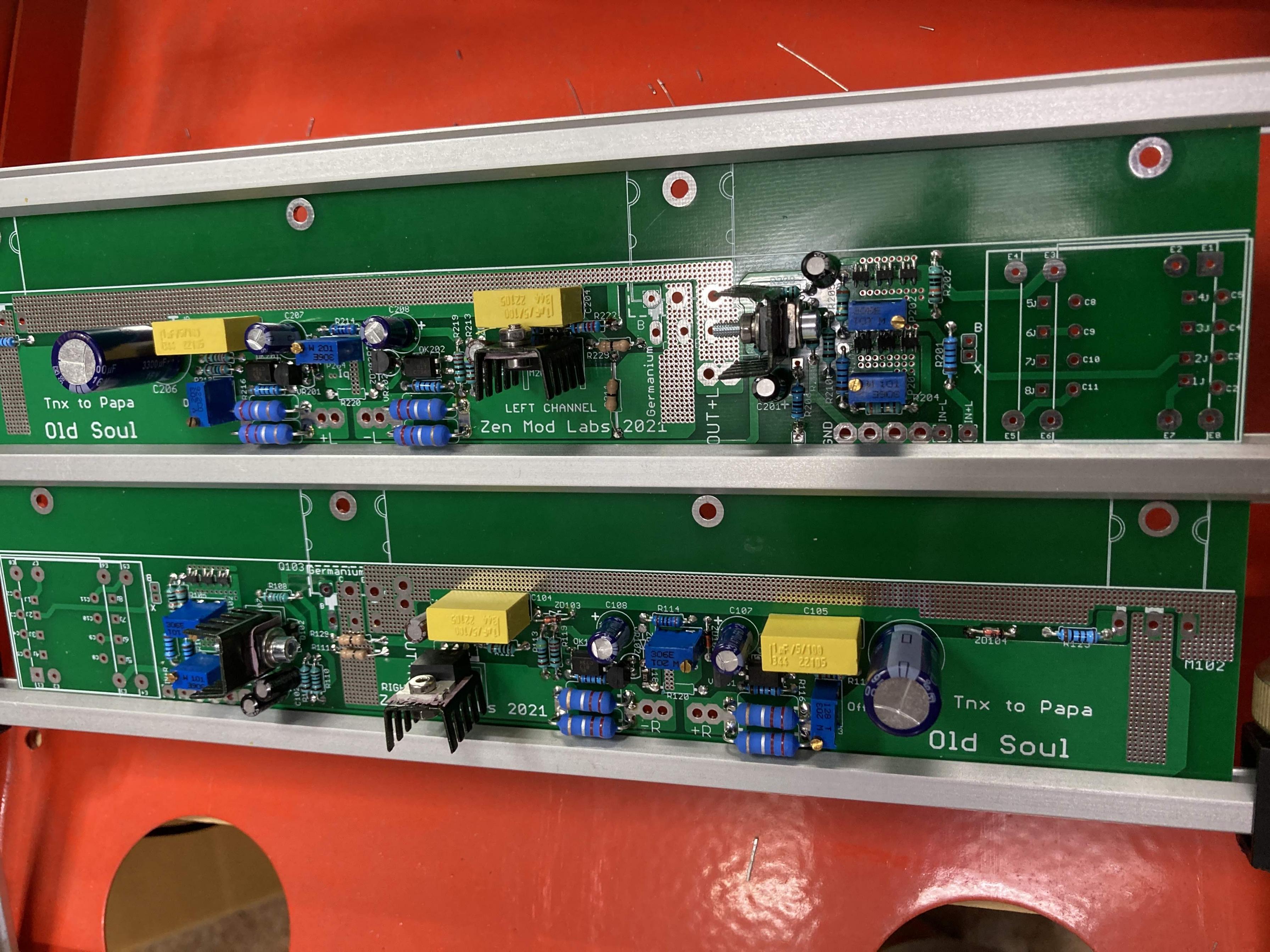

R122 / 222 is defined as 10R(22R)... That is depending on the type of germanium or 2SA1943 thing? Mine is the "round one" (2N1099), do I put 10R @ R122 ?
ZM,
...and R120 (180K) seems to be missing, not in list and not in the bag...
that is my omission, evidently Packing List with that mistake sneaked in.... I know that I corrected it

Part 1 almost done. Now comes the sad (or hard) part: waiting for the rest of the parts.
I need the PSU, trannies, chassis. Since I want to stuff all mouser-parts into one order (to avoid the shipping-steal) I have to wait for the toroidys to arrive, to select the correct snubber-values. 2 weeks wait for old soul!

The only thing I can't quite figure for an Old Soul build is how to mate 2N1099, 1T813 and etc to the conventionally available DIYAudio case format. Maybe it's easier than I'm thinking...
Also, will Old Soul boards drive Shindengen 2SB206?
see pictures how I did it on T Bed
i'm really not having another solution
maybe easiest is having entire pcb on L bracket, then Ge thingie on end of it
yup, whichever Ge type you choose to toss in, it'll work
