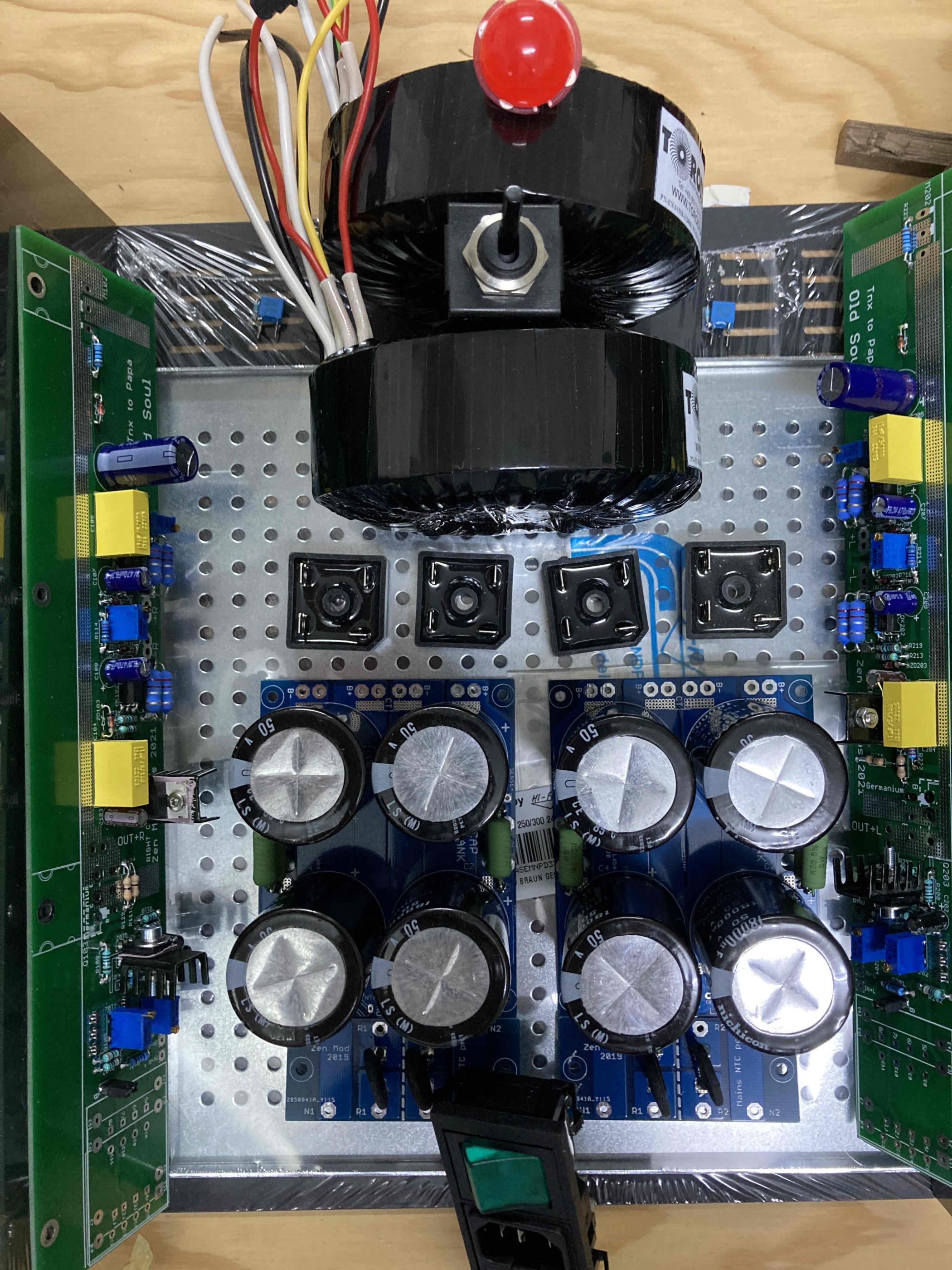

Playing around with the layout.
I got a mini dissipante 3U 300, so space is a bit of a concern for my next washing machine :devil:
Went to confirm how you did it on Tbed, and realized
A) your heatsink is >300mm! (Note to self: be creative, kid)
B) you placed the germanium far away of the board‘s spot, so I guess this isn‘t going to be an issue?image-2021-09-16-08:45:16-593.jpg
HA! ?

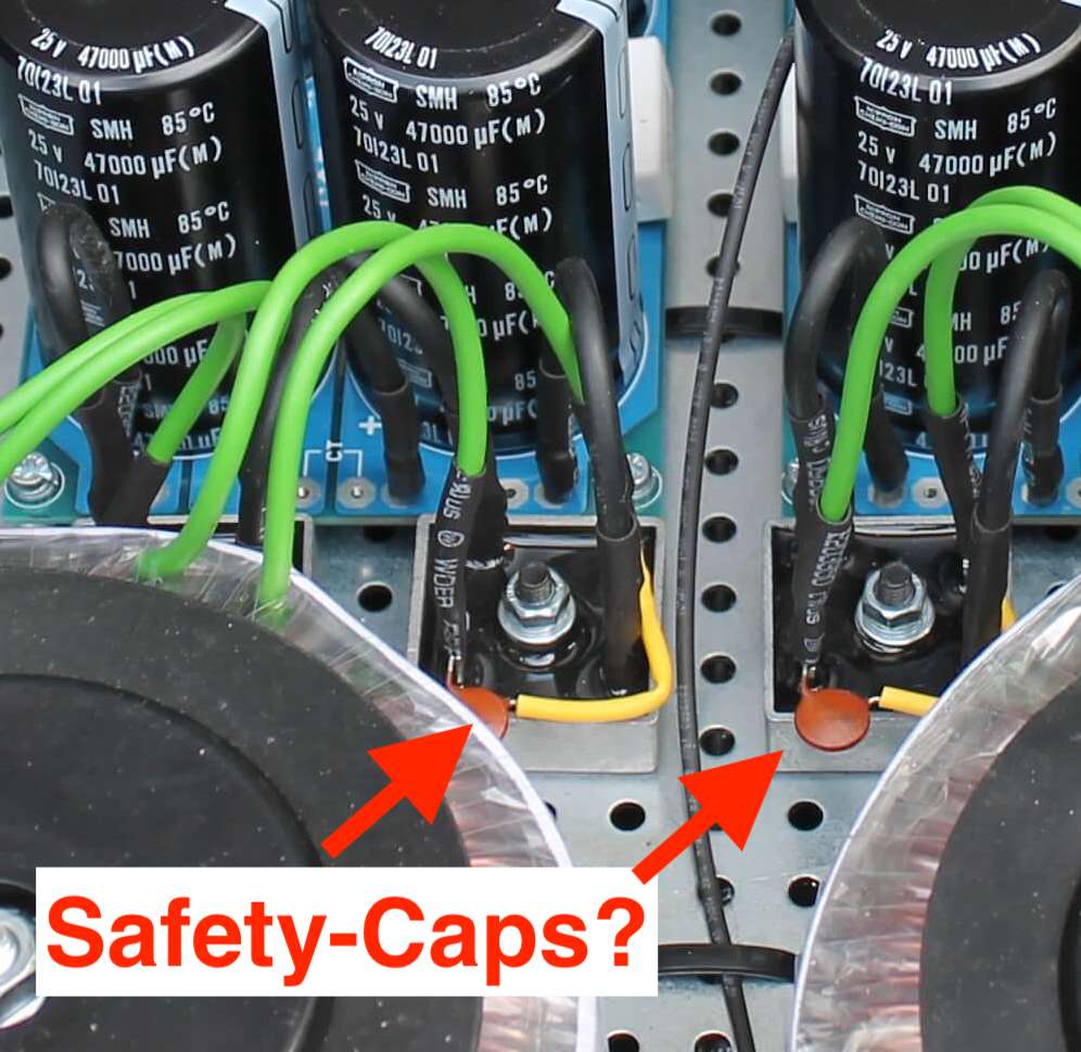

safety caps?
While looking for pics of a built HA!, I found one in your SissySIT, very helpful.
the capacitors on the diodes... safety caps I presume, just like in 6L6's build, correct?
:cheers:

bridge rectifiers
Howdy fellows!
How warm are the bridge rects expected to get? ~50°C, so that the modushop steel-baseplate is sufficient? some moderate heat-sinking if mounted vertically (between tranny and cap-bank)?
Do they spread noise (for orientation-options)?
:cheers:
some thermal goop between them and base plate, proper M4 screws (split washer!) and that's it - you can keep fingers on them indefinitely
see pics of my builds
even if base plate is steel, transfer is more than good enough for amount of heat, while sheer size of baseplate is taking care that temp. of bridges isn't significantly bigger than surround

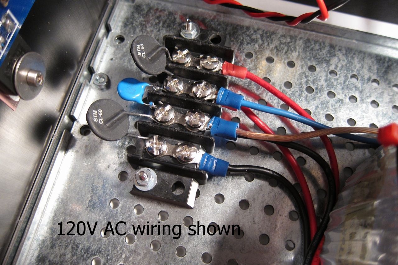

Part & connection questions
Mighty morning and everyone,
re: the HA!-ground-connection, we're told "10mm NTC connecting Audio GND to chassis", ok. I want to support my Swiss supplier to keep it alive :rofl:, but its difficult to translate english electronic-denominations into Swiss-german.
Anyway, should I go for a NTC with its R as low as available? (like, 2R5 ?)
And, thermo-coupling the germanium-bigun has to be non-conductive (so just goop won't do it), right?
and,and,and ? 😀
(I'm at my 4th cup of coffee, so possibly having a head start. Try to compensate by meditating over wether I should complicate the layout and mount the PSU vertically)
NTC need to be up to 10mm in Diameter
you can squeeze bigger one, but bigger ones are having thicker pins, so you'll need to fire up lathe, mill and neighbor's excavator, to decrease pin thickness
value of NTC 10R to 15R, no less
Ge Bigun must have mica and goop, probably easiest to obtain and arrange
or Keratherm 86/82 sheet from Conrad.de, then cut and punch
