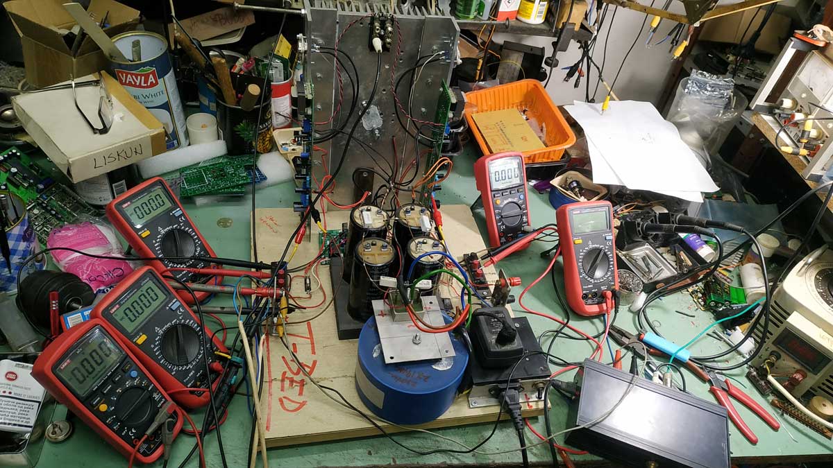

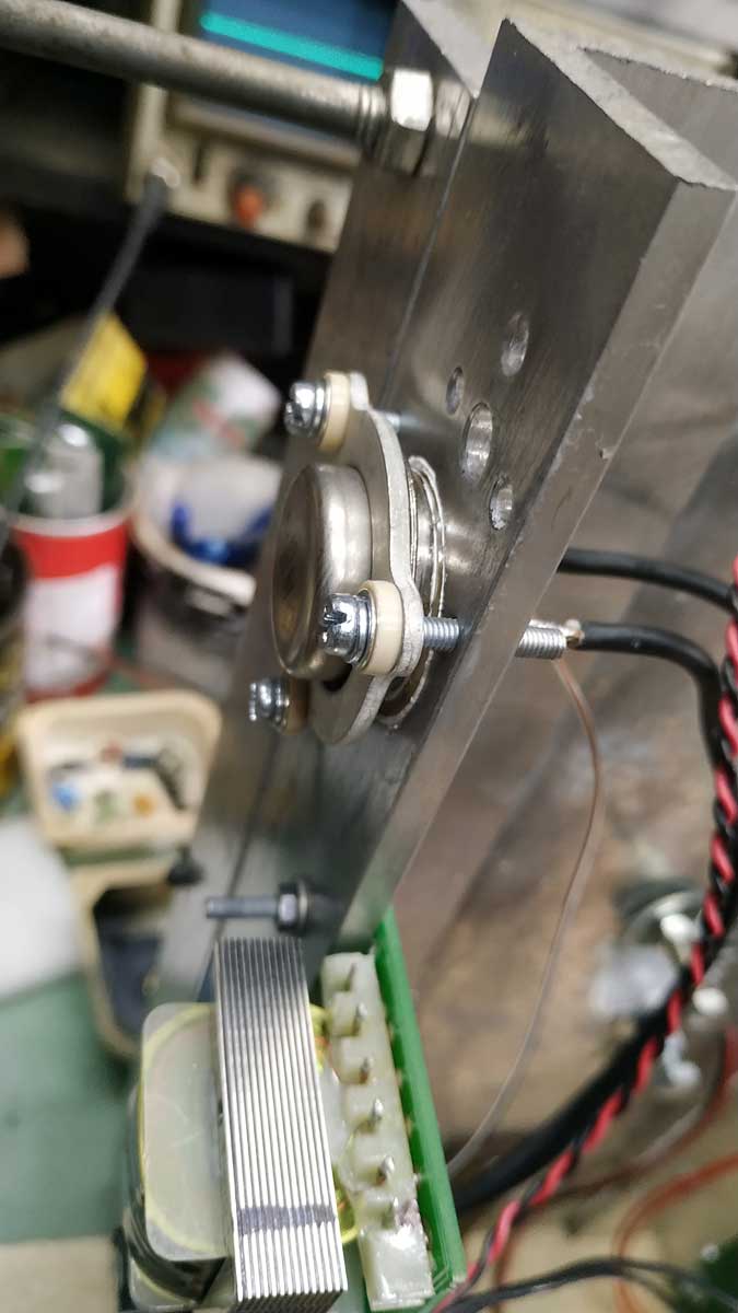

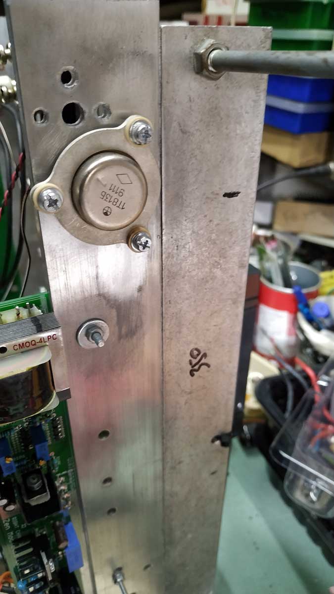

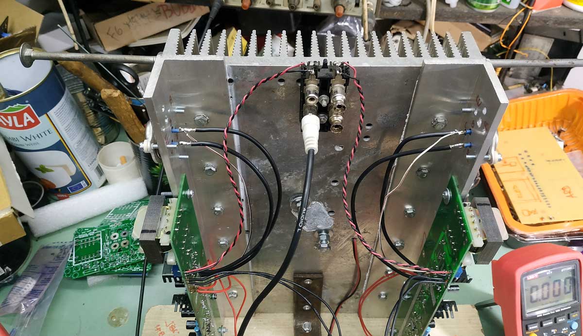

Did mount 1T813 today, in place of 2N1099
fired it up, it set itself exactly at same Iq (as previously 2N1099) , did just minor tweak of output offset
same situation for both channels - everything perfect in static state
then connected old crummy Sigene to input, scope to out, no load, just to check does modulation reaching output
first channel OK
second channel - started , and somewhere at half ( of max) thingie just went South - speaker DC protection dissengaged relays, got 48V across 0R11 resistor group ( where I need to see 110mV)
powered it off, logical check - dead mosfet, dead Ge, two 0R22 resistors dead ( there is a reason why there are 2 or 3W jobbies)
was it 1T813 Dud ? most likely ...... and now I'm thinking what and how to test them if I decide to get them in quantity
it seems test with actual load, fastest way of Ge tossed in 1L container of demi water is easiest way to do it
anyway - replaced what's Dodo, checked rest of circuit and fired it up again
this time everything went good, so did tried both channels with load, up to clipping
first channel OK

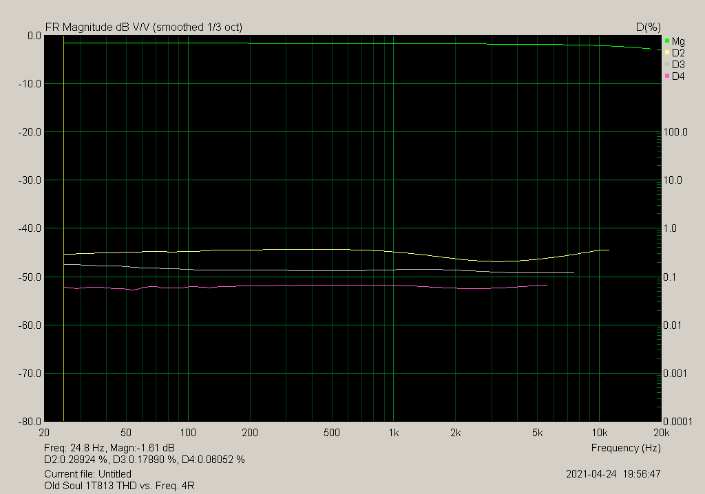

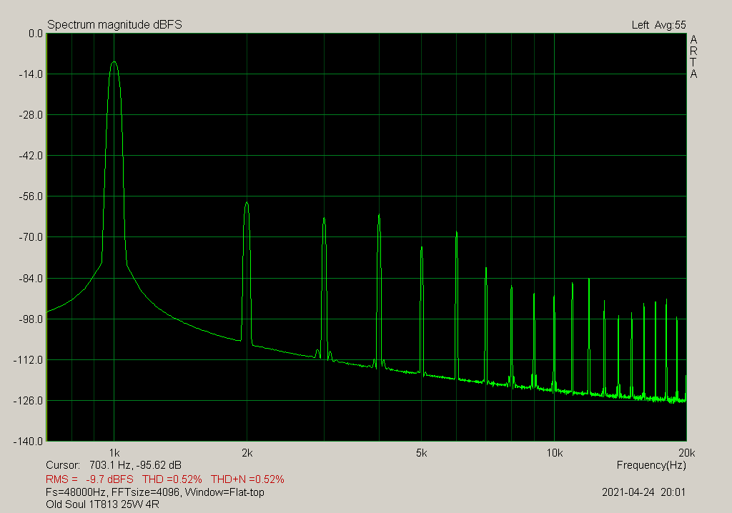

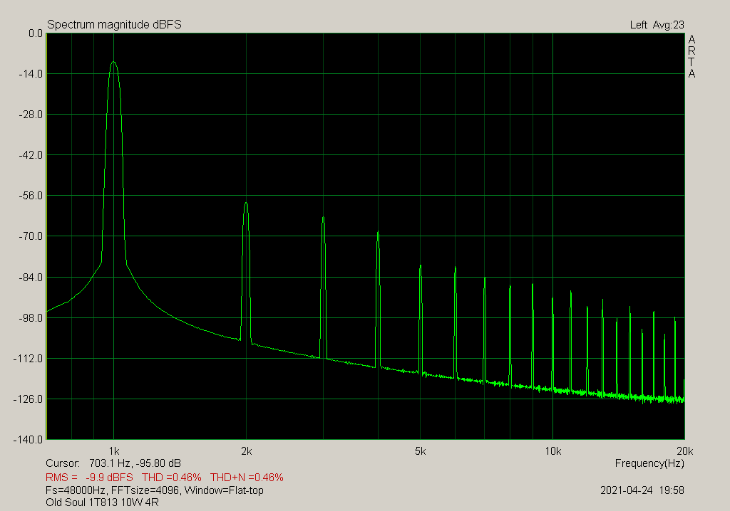

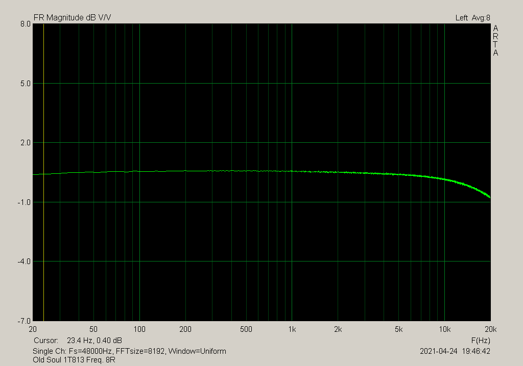

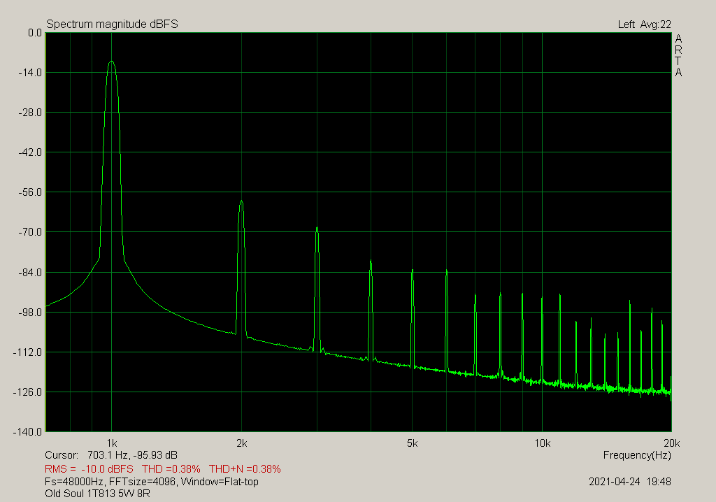

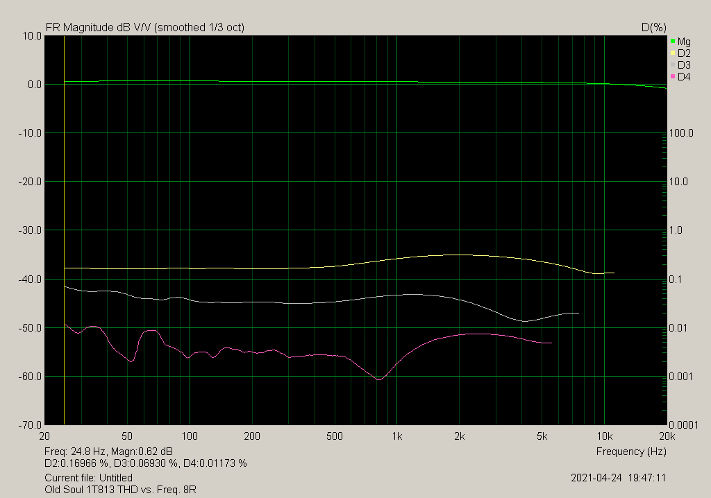

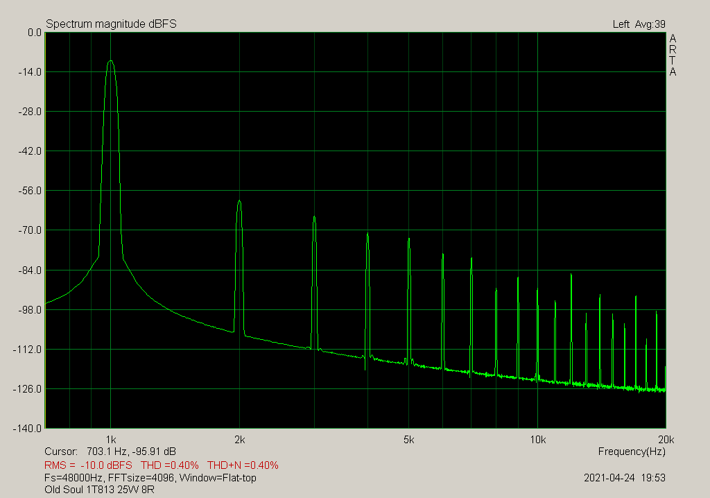

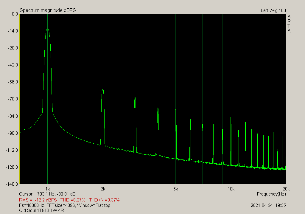

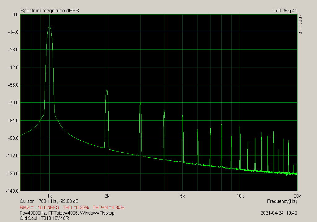

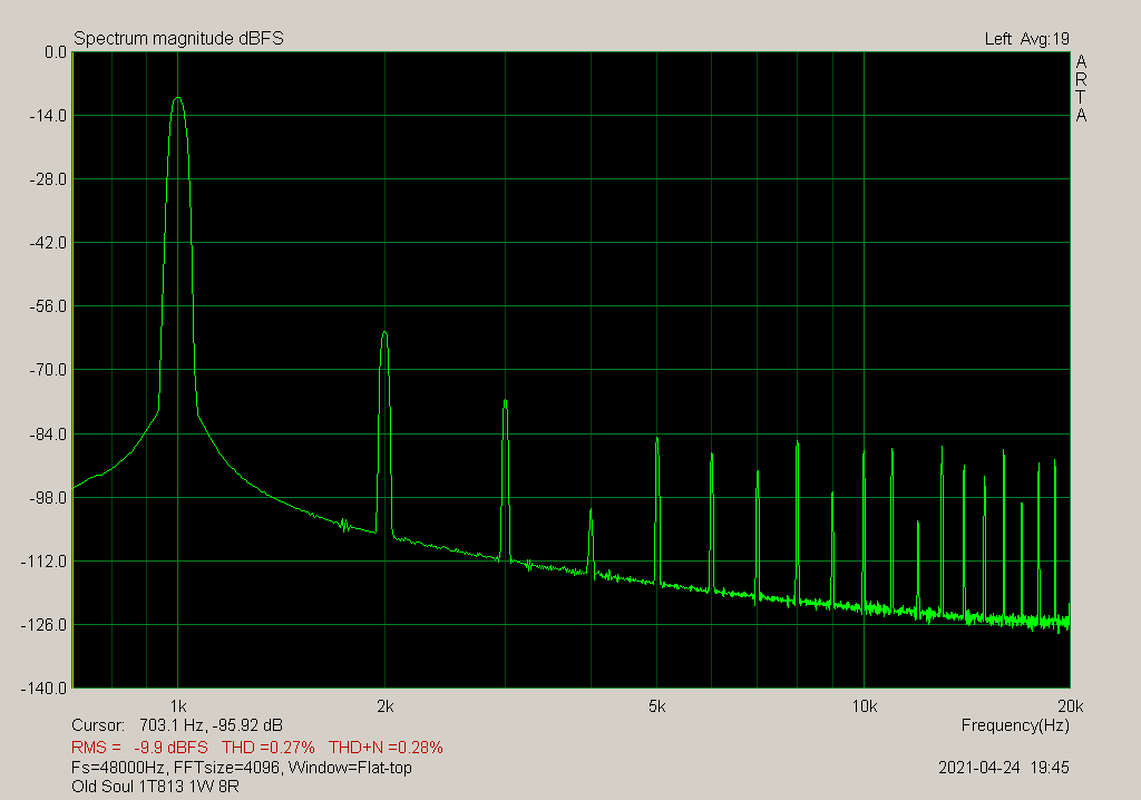

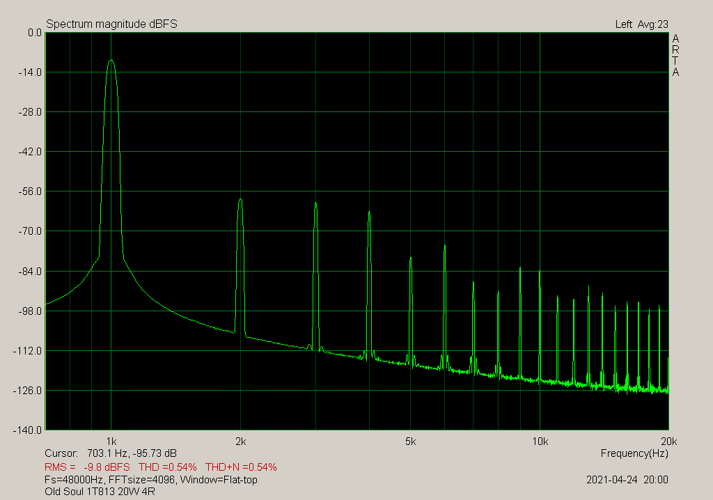

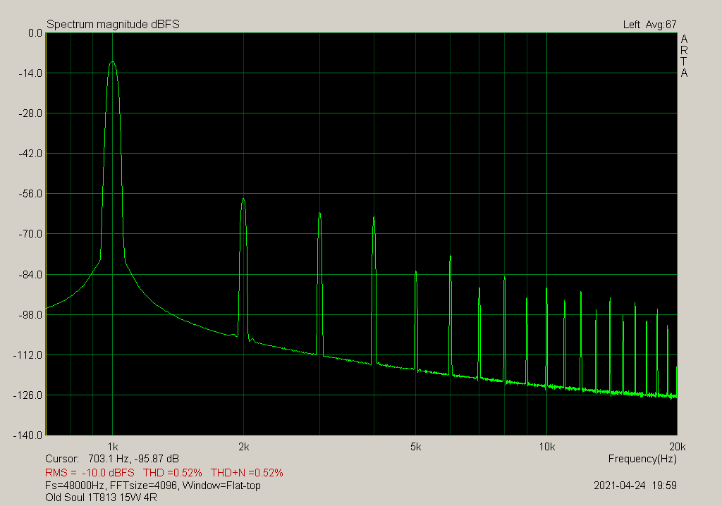

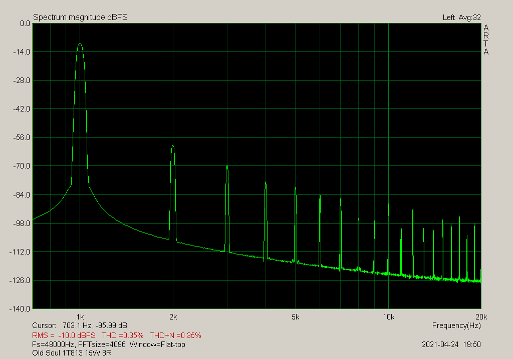

now even more weirdness
checked trice entire setup, done each step at least twice, when seeing how THD numbers are weird
8R load
8R load

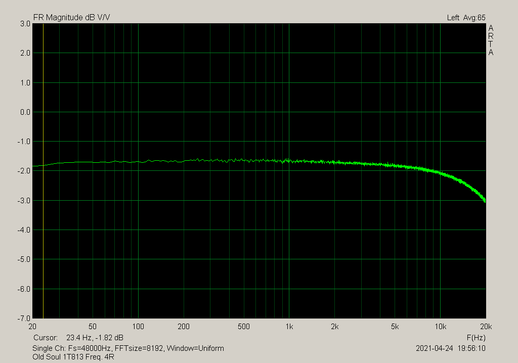

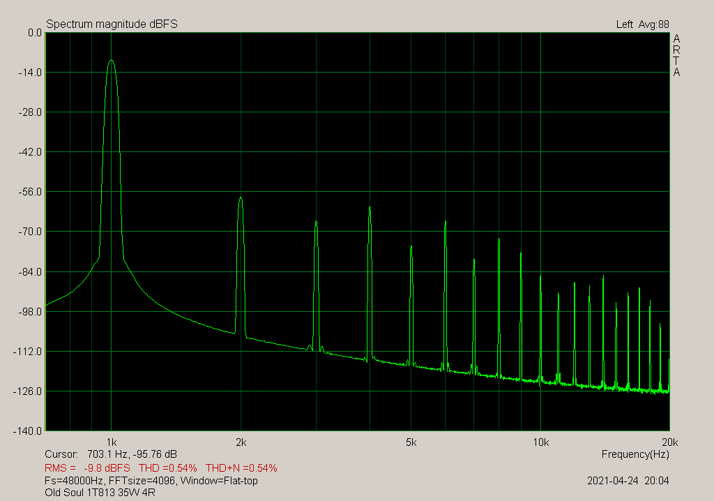

4R load

Tomorrow will THD test other channel, for reference
Still can't wrap my head around exact mechanismus happening here ....... THD Spectra is weird, at least for my untrained eye
will give it some listening and - if I'm able to draw some conclusions in relatively short time, will proceed with 2SA1943 in place of 1T813
from prototyping, I know that iteration is also extremely interesting ...... and certainly most easy one, taking in account acquisition of parts
