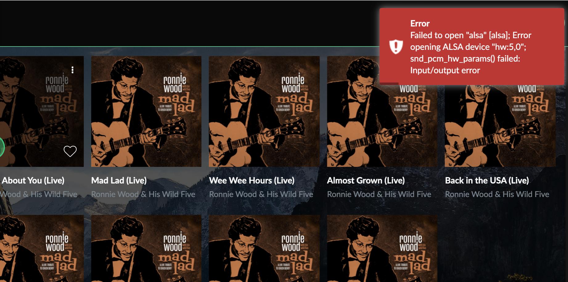

Does anybody have been successful in making the DAC8 work in Linux ? . I have tried several distros in PC but none works. RaspberryPI does not work for me either (with Dietpi).

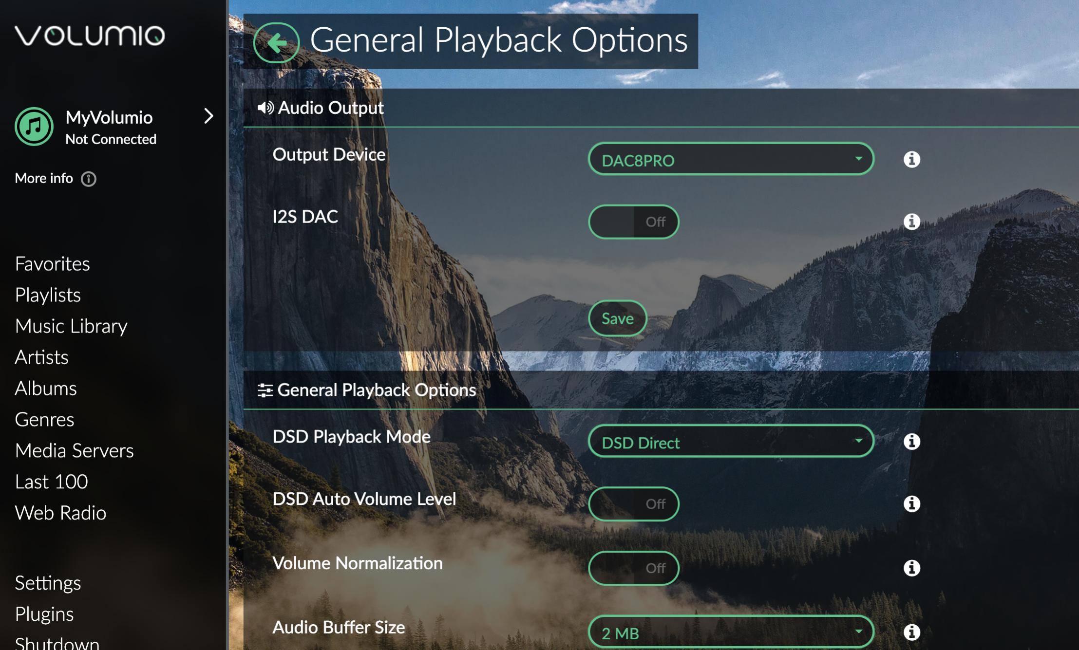

I had no luck with moode but with volumio it worked instantly. the DAC8 must be connected to USB input 2 and you must set the i2s input to NONE in the linux that you use.

I installed volumio on Rpi3b. as i said first i tried moode and it didnt work. but volumio worked with no issues. just plug in the cable and choose dac8stereo as the output device. mine does not have rpi inside the unit. i wanted just a dac to use with any streamer that i want so mine does not have the internal rpi option.

I have tried Volumio in a RaspberryPi 4 .... it does not work either
All the test with Linux failed so far and I am starting to feel really frustrated with the DAC. Pavel does not answer my emails. Do you guys have contacted him recently ?
