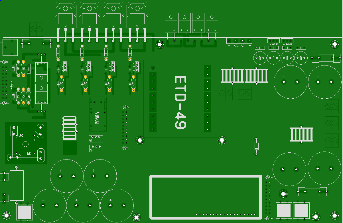

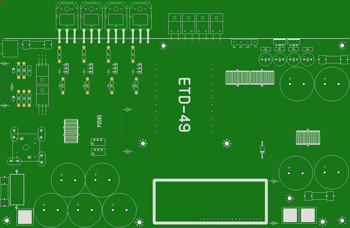

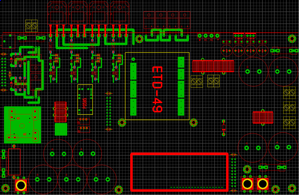

hi luka,
i have modified you pcb layout to use the vertical mounting of etd49 core.please check
if there's any mistake.ill be upgrading it from 500w to 1kw later.is it overkill.i have connected the feedback to negative supply.will correct it ill post primary/secondary turns ratio later.

ravslanka:
Note that diode near 7812 is turned the wrong way on silkscreen
I would also leave about 3mm or more gap between primary and secondary (under the trafo). Primary tracks do not need to be that wide
Also think about primary and secondary snubbers, they can be pretty big (take a lot of space, depends on trafo itself, how good it is)
apart ftom that, it looks ok I think. Btw, take out those big caps, they are not good for this kind of supply, you need small output capacitance, that means small capacitors, but with low internal resistance, if possible to get. If not, more standard ones in parallel
