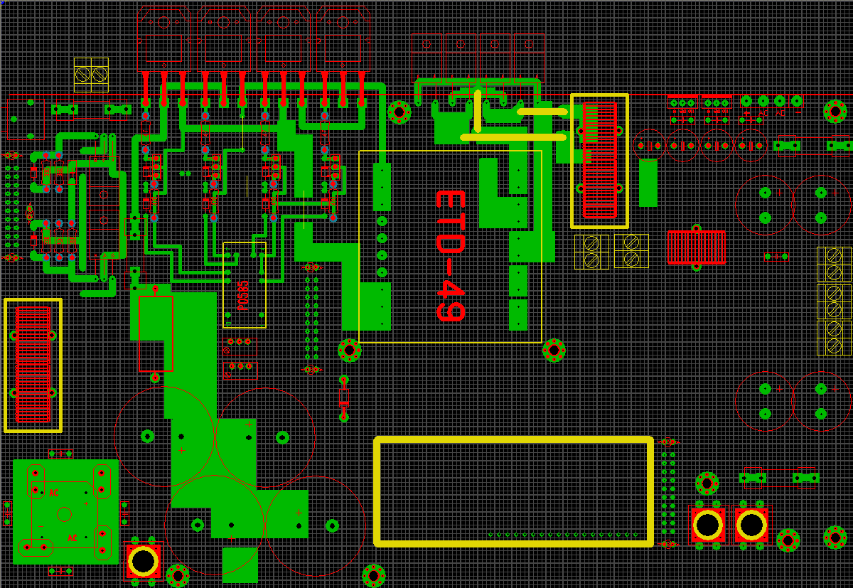

Iron powder core for output sound ok as far as I know
But I don't know why you have 2 inductors after etd, that should be one and after diods, I hope you have it like that
hi luka ,
is it ok now

isnt it primatry providing more current then secondary.

is it ok now

yes, if secondary voltage is higher then +/-160vdc in case of 230Vac input
Its better, but this goes for any trace around primary, secondary... see that top right pin of SG that is connected to... that one is close to secondary, while SG is part of primary circuit
depends on voltage (size of cap), you can calculate what value you will need for your design (ripple current).What size and value of caps would recommend to both of us, Luka?
If all that is too much, go for about 3000uF max per rail, that means 3-4 caps. unless you can get low esr caps, then you can get away probably with even less... everything else is done with regulation, if that is what you go for, as I think you do. I can not stress enough, how important compensation is. If done right, you have almost perfect DC on output, independent of load you have
I am going to go with 4 CHEAPO 1000uf 100V per rail, then AFTER I build and test it I can take out as much as I can get away with.
The board I am laying out is just to test out everything I want to do before I commit to making a few clones of them...

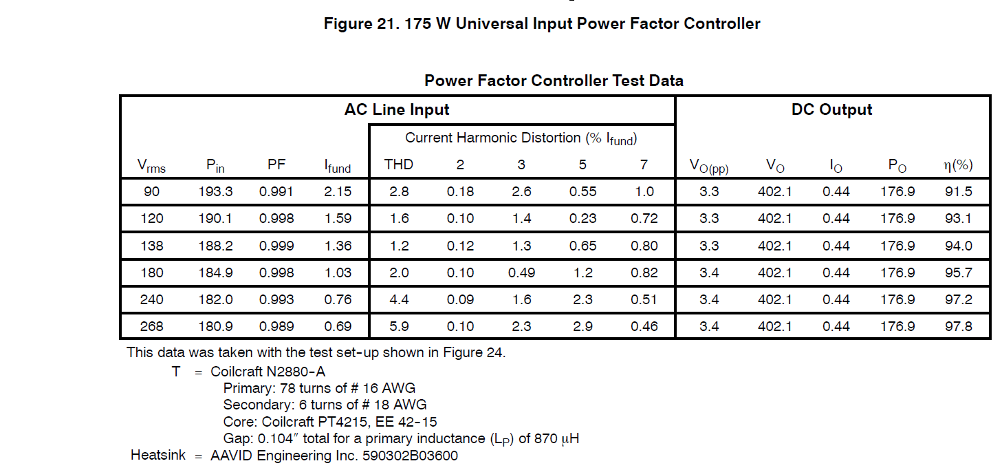

t
heatsink is:
This is from the application note on the MC34262
http://www.onsemi.com/pub_link/Collateral/MC34262-D.PDF
heatsink is:
