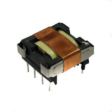

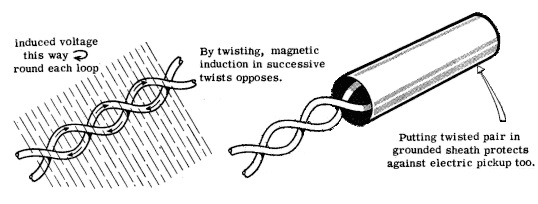

@ Dimkasta

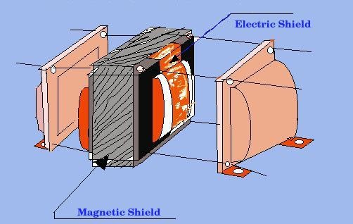

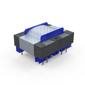

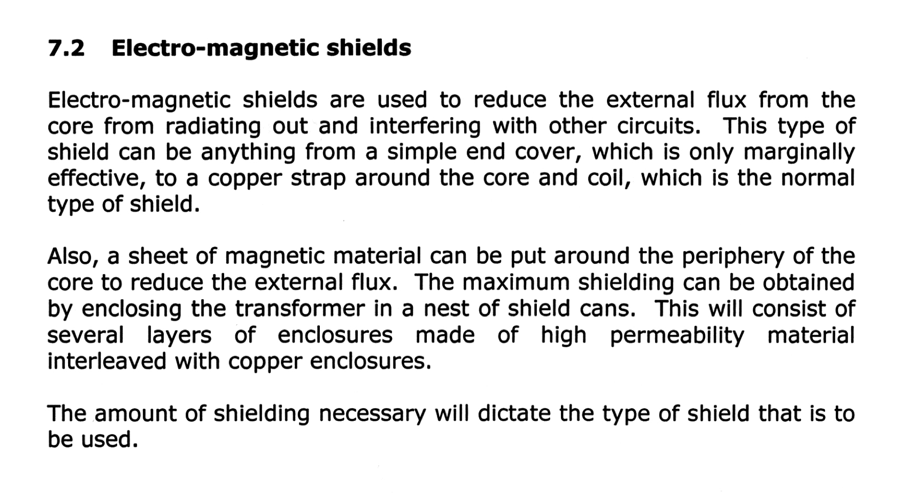

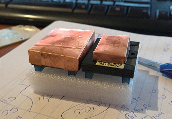

Good try 🙂 You can make multilayers transformer shield protections with copper tape first .
The best solution bend tape all around without shorts or contacts with wire inputs or outputs windings
With close in mu metal can after that you don't be worry about cosmic radiations from Alpha Centauri as well

@ Dimkasta
With close in mu metal can after that you don't be worry about cosmic radiations from Alpha Centauri as well![]()
Thanks for the tip
I have made MuMetal boxes already but I will also add some copper tape as in the lower photos in your post

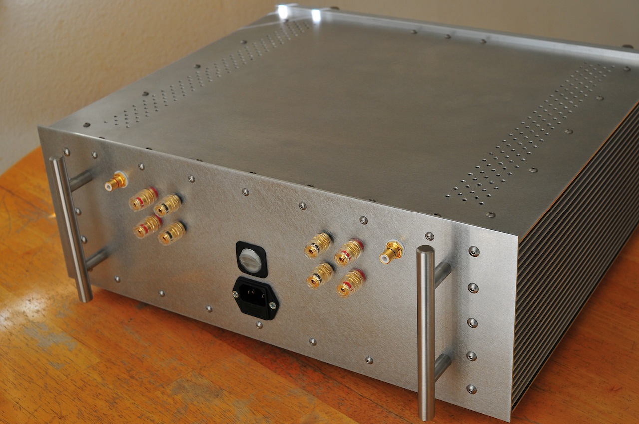

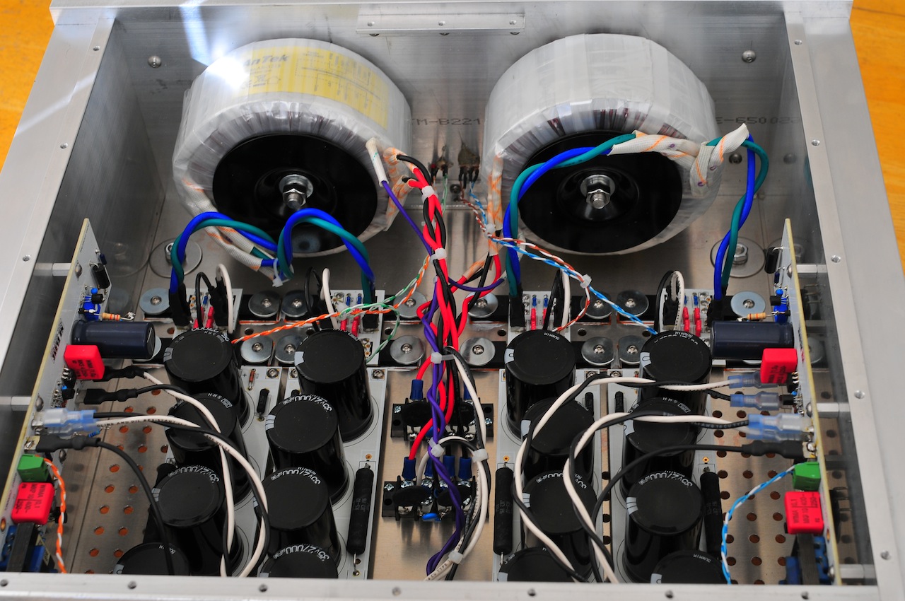

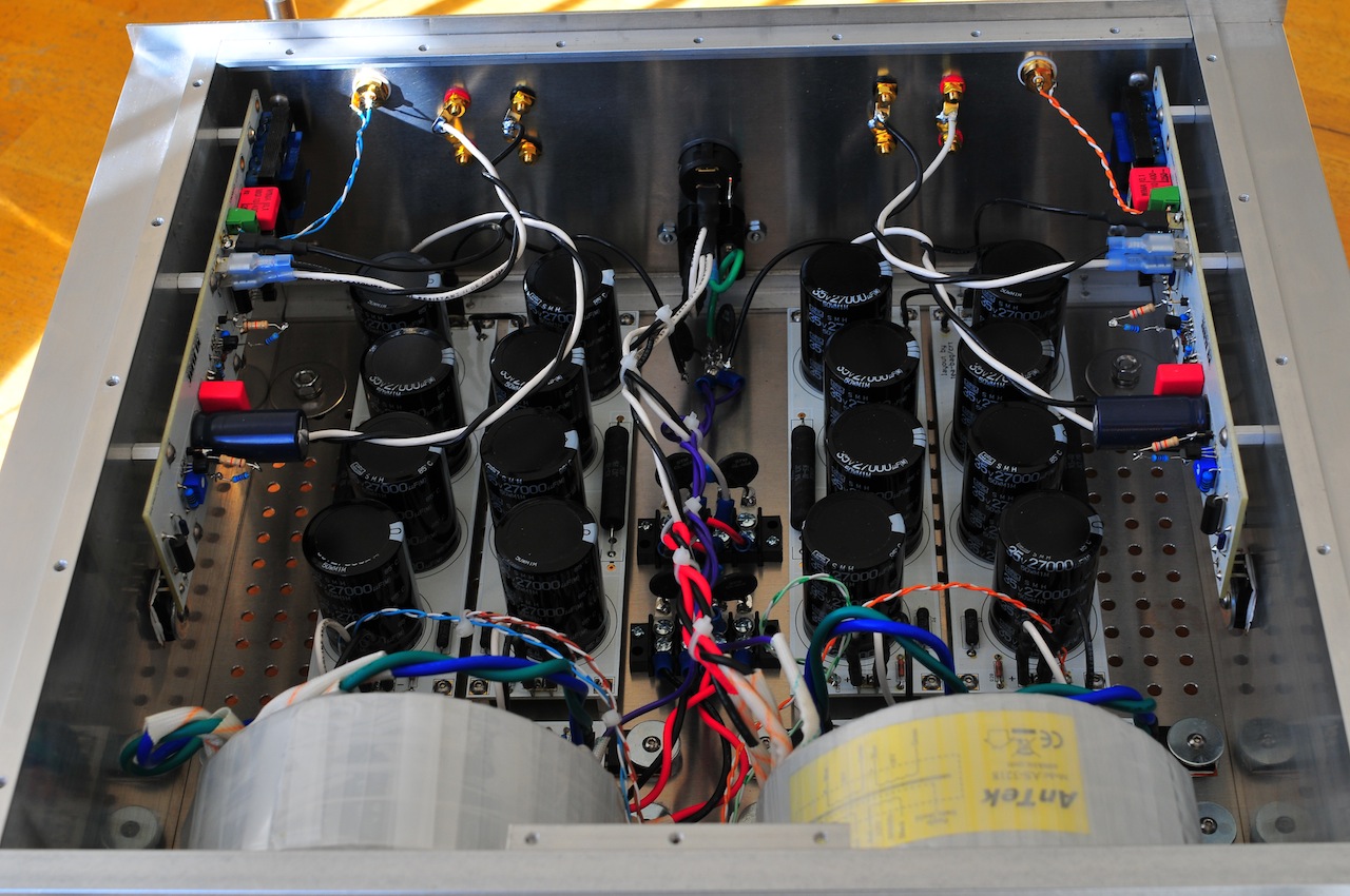

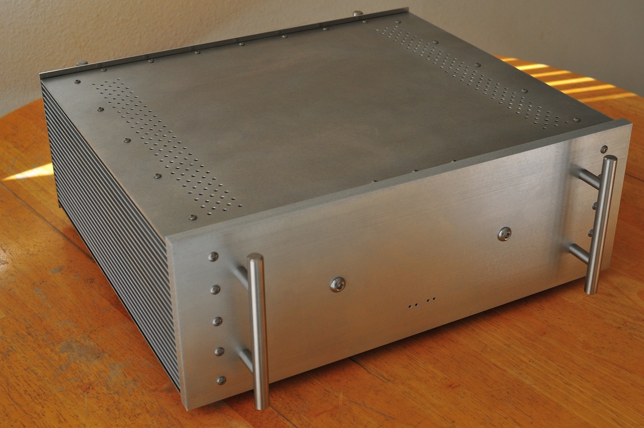

FirstWatt M2 Clone Done.
Happy New Year diyers.
Finally to get the amp up and running, bias set to 630mV, R13,14 on TeaBag's boards use 0.5ohms will draw about 1.26A. DC offset only able to get to 5mV because my part bin run out of certain value that will give me a more closer zero offset, may be do it next time.
The case dimensions approximately 17" width, 5.5" height and 14.75" depth. Heat sinks use 5.375"x14" from Heatsink USA, face plate 17"x6"x0.5" others just 16 gauge 6061H36 plate, all from local raw material shop.
I like the sound of the amp, it is my cup of tea. I am just a music lover don't know how to use the juicy words but it is absolutely worth the time and every single penny that you spend on it.
Thank you to NP's generosity, Choky's and fellows info., TeaBag's boards and Spencer's close match jfets.
Fugly!
(put both bottom and top plate on 10mm spacers , you'll get much cooler inside of amp)
Yes, all the holes drilled by a floor stand drill press.
Will consider add an exhaust fan. BTW, I miss your stone grill sausages.
