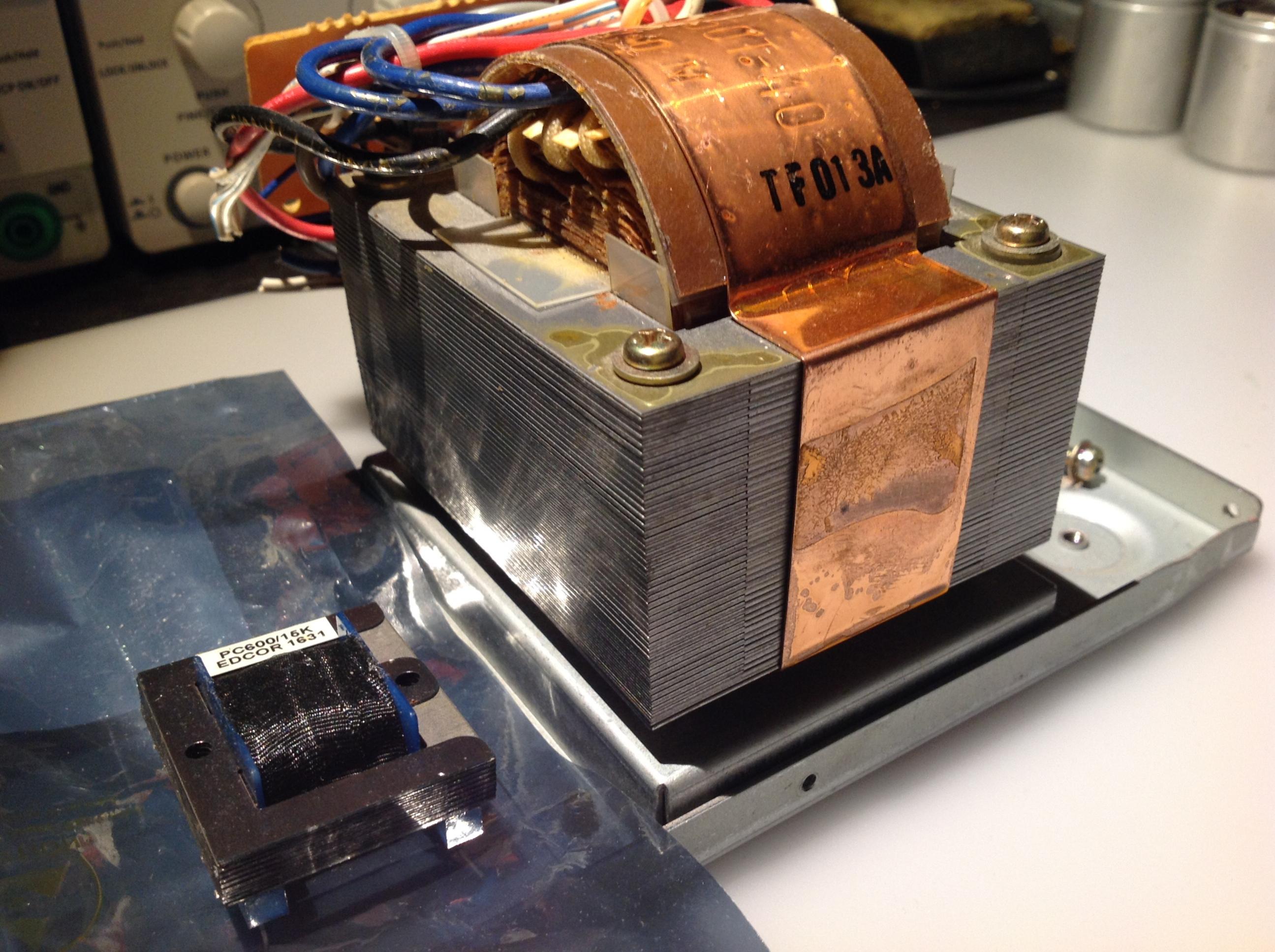

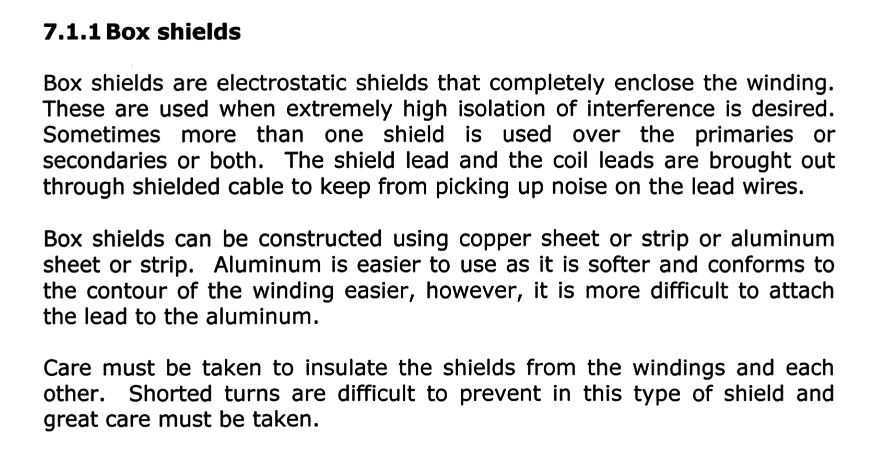

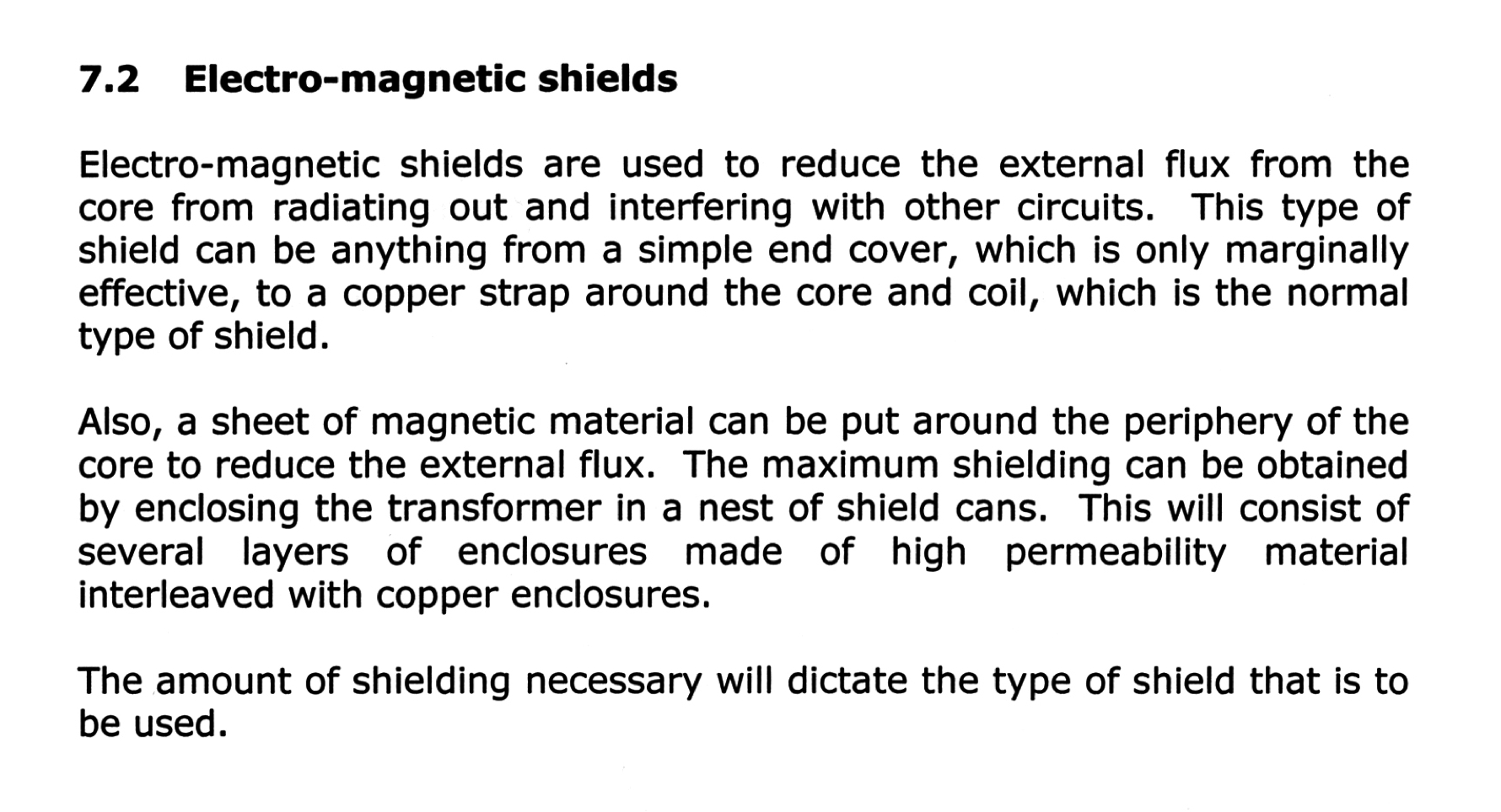

By copper shield foil i mean like on this one.
M2 need care protect from all magnetic components interaction.
