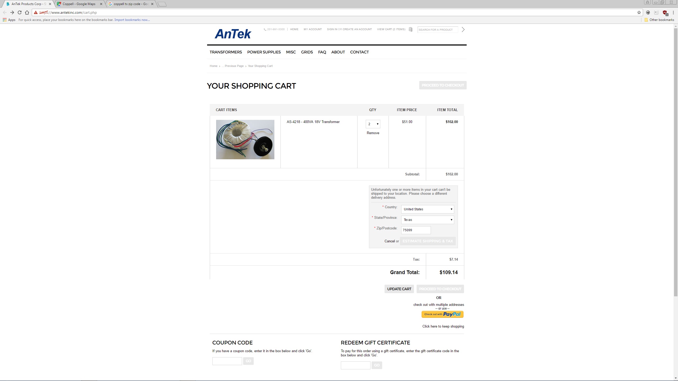

I'll call them. I can use any zip code in TX and get the same message.
Try ordering just one. I think two exceeds weight limit of USPS priority mail. You actually only need one of those for the M2. I have the same one and it's not lacking in power at all.
I called and ordered them over the phone - their shopping cart is messed up at the moment.

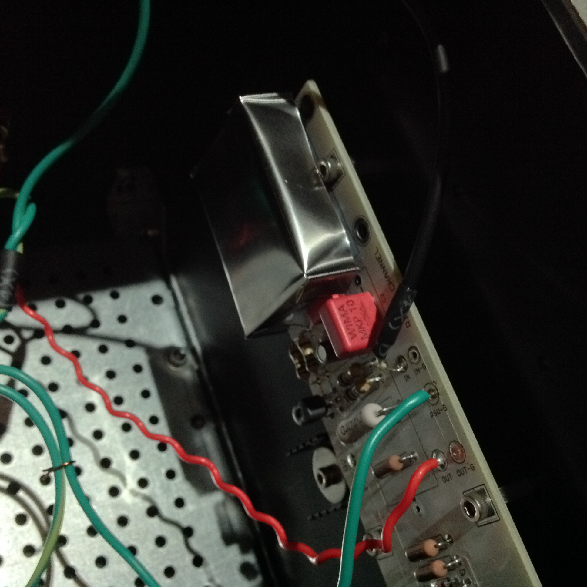

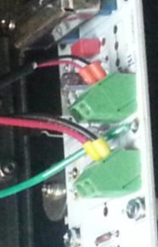

Here's a picture of the layout in progress

Haven't had time to do more. I have a coffee can I will cut up and cover the toroid.
Why i ask about jfets ? Well i never see 2SJ/SK with leg's shape like on your photo but if you say is ok..I have a coffee can I will cut up and cover the toroid.
Yeah coffee can !
Good idea let's try

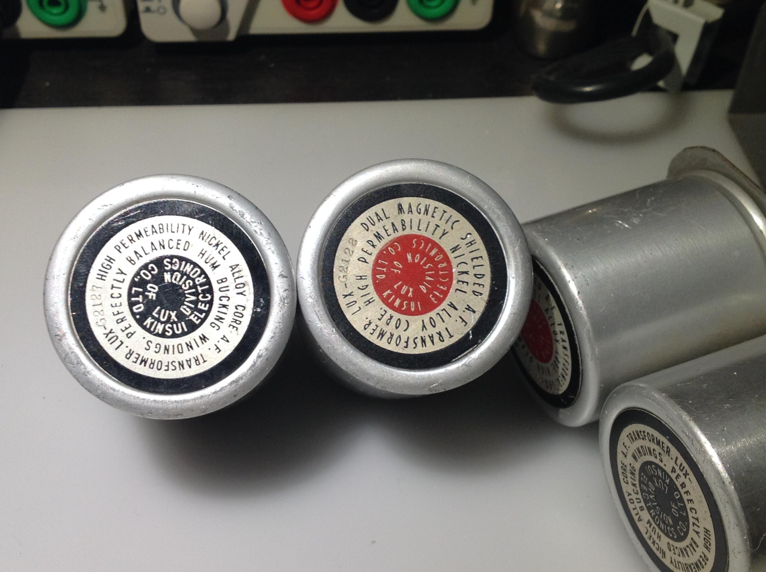

I see some amateurs use copper flexible rubans for shield do you know is efficient ?

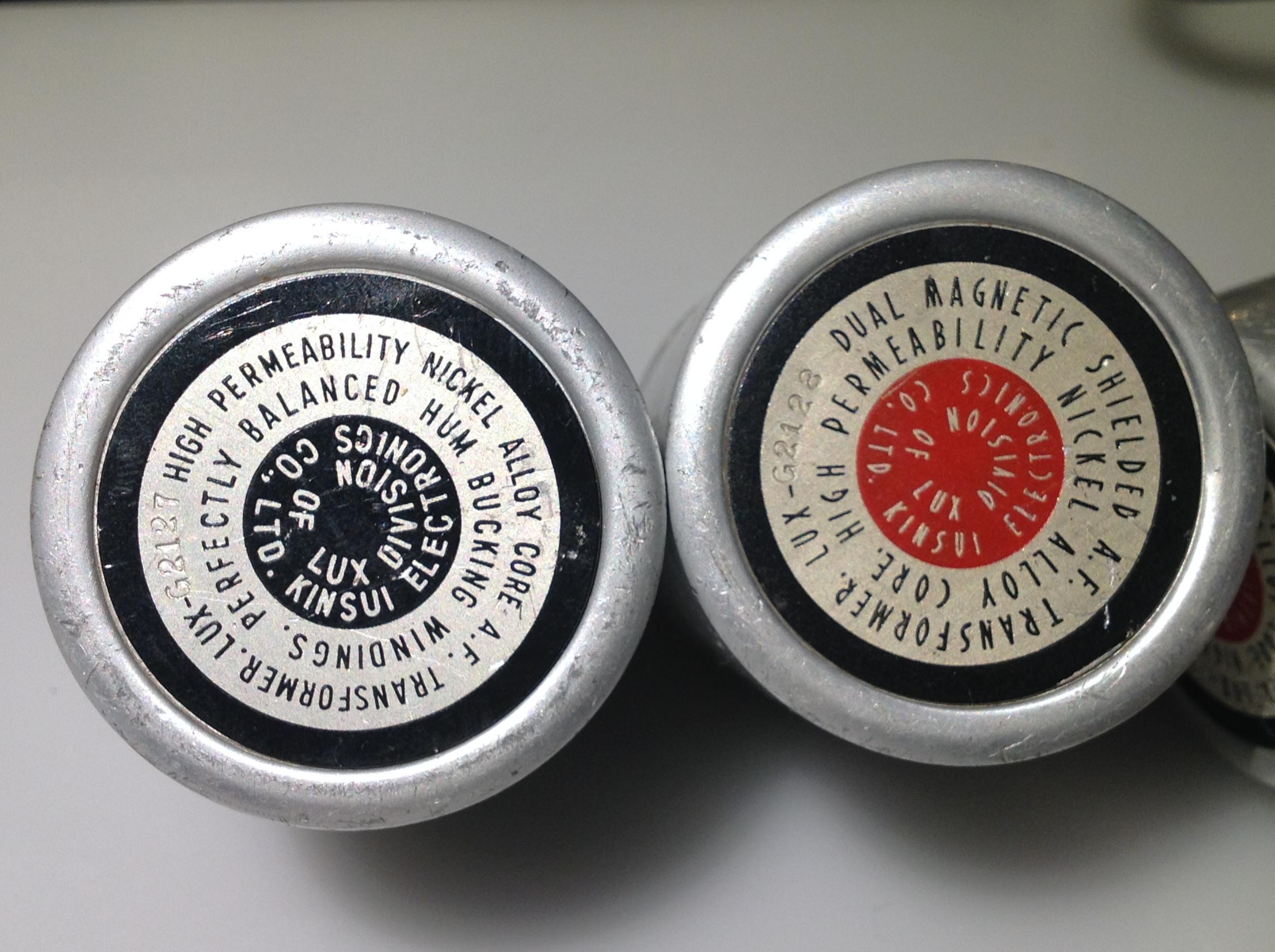

Get this vintage LUX transformers they are dual magnetic shielded A.F
and perfectly balanced hum bucking windings version.
For my diy M2 i use Edcors anyway just must shielded them.
