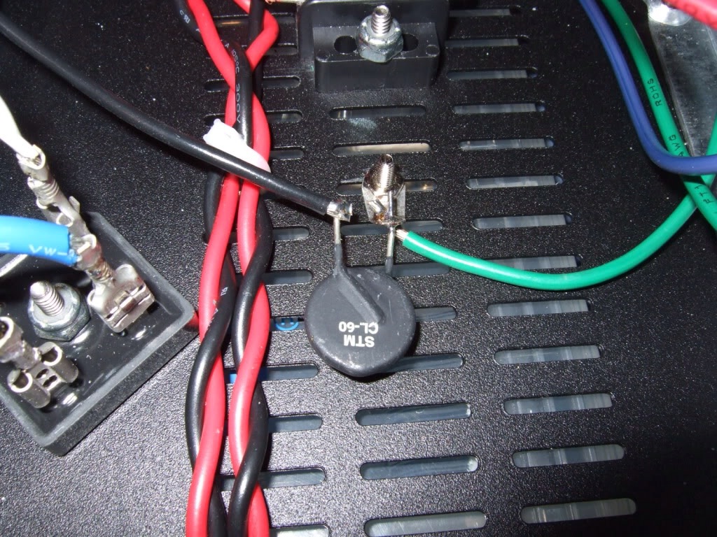

You connected the Power ground directly to the earth ground bolt. That usually causes a hum. First try to follow Nelson Pass's power supply schematic the best you can (put a CL60 and bridge rectifier between ground and earth), and then see if there is any hum.
Why would I put a bridge rectifier between ground and earth, are they not for turning AC into DC?
I'll put a CL60 from Earth (wire from IEC?) to the chassis ground bolt and get a bridge rectifier if it'll sort it out. Do you not need to use all 4 of the connectors on a bridge rectifier?

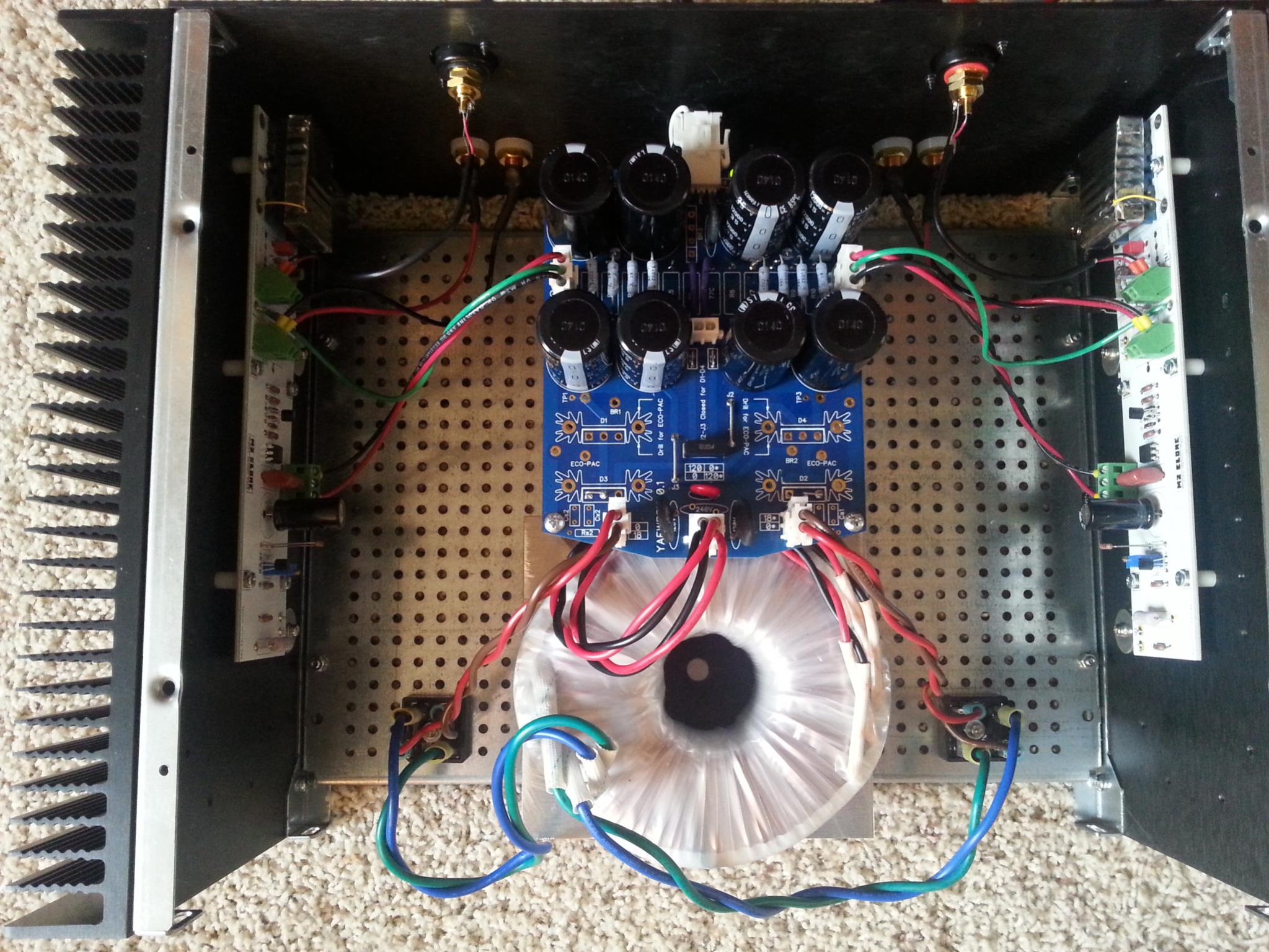

Just for reference about the hum noise. I just completed my M2 and it is noisier than other amps I have built. The First Watt spec has noise at 500uV 20-20 KHz. Somewhat higher than others in the line up. Most others at 100uV. I have 95 dB back loaded horn speakers. The Hum can be heard when I get within a foot or two of the speaker.
Here's a couple of measurements.
Tea Bag PCB's.
Measured with a Fluke DVM, source connected.
Hum didn't change with or without source connected.
Hum didn't change with PS ground isolated from chassis.
Tried relocating all the signal and power grounds to the star ground on the PS but no change. Went back to the original layout on the Tea Bag PCB's.
0.3 mV AC measured across the speaker terminals with the speakers connected.
20 mV AC of ripple on the power supply.
By rotating the transformer the hum changes with a maximum of 0.5 mV.
If I moved the transformer away as far as the wiring would permit (outside the case) the Hum measured 0.25 mV AC and was quieter and acceptable.
Built a couple of shields from tin cans for the Edcor's but it didn't seem to help much.
One thing I noticed was if I moved the secondary power transformer wiring after the bridge the AC output on the speaker terminals would spike up to 2 mV as I was moving the wires, so obviously its being induced onto the circuit somewhere.
If I can get it down to 0.20 to .25 mV I would be happy.

Here's a picture of the layout in progress
@ BDP
Do you try hum is lower if you close chassis with his metal cover ??
Wher is your chassis ground connection ?
I always learn a lot with 6L6 build guides photos by courtesy.
Tnx and best regards 🙂
Edit : bend your audio input wires into corners direction ( experiment) for little more distance from main AC input.

Thanks for the advice, link and encouragement. I've swapped the transformer and psu around, ordered some heavier wire to go between IEC socket and transformer (would twisting this help) and between transformer secondaries and psu board (which I'll twist, thanks Murdoc). I've crossed power wires at 90 degrees to each other (eg IEC to transformer wires are at 90 degrees to M2 board to psu board wires). My input and output wires are at the top of the case and away (as much as possible) from each other.
I've connected a CL60 between IEC earth tab and star ground, connected transformer earth/ground (? not sure which terminology is correct and this is causing some some confusion) to star ground and finally psu ground to star ground.
My star ground is connected to the chassis. Is this correct so far? I'll post pictures when I get the new wiring installed.
If I still have an intrusive hum I'll fit MuMetal shields to the Edcors (where is best to get Mumetal in the UK?).
I really appreciate the help, when I can ignore the hum it sounds stunning!
how on earth ppl don't get first and most basic thing :
IEC earth tab must go directly to chassis
then main audio GND point goes through CL60 to same point on chassis
after that - whatever you do is sound issue , but safety issues are covered
if needed - you can replace that CL60 with short or with diode bridge in parallel with CL60 , depending of actual needs
That's what I've done, I was looking for confirmation. The switching between terms of earth and ground is a bit confusing.
It's what I've done in the other bits of kit I've built but in this thread I've read chassis ground, star ground etc and it confuses things when you're lacking confidence due to a mess up months ago.
