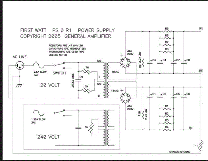

This is the schematic that I used:

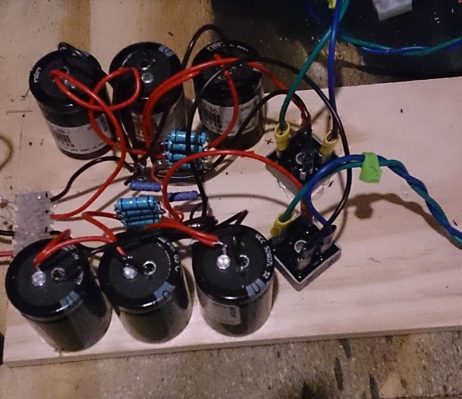

This is the point to point, used a tag board, the .47R are in a 3D ladder, and the 2.2K is on the other terminals. Used 600V wire that I will be using in a tube amp project, probably over kill, Caps are 22K uf.
While while you cannot see it, the thermisistors and the cap are in the screw terminals on the 110 side of the transformer.
