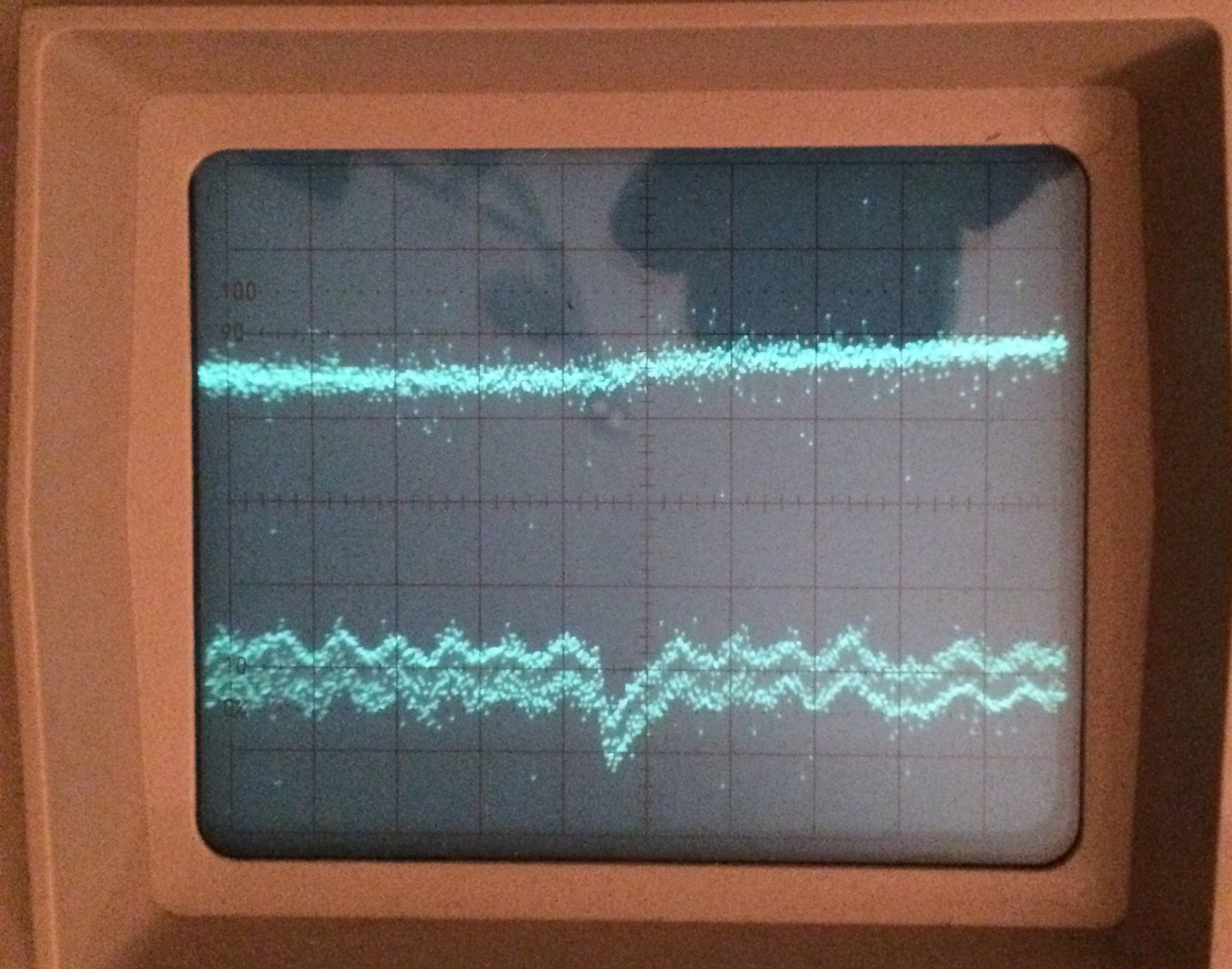

Generg, you may have a point there: the DC drifts when I touch the supply clips. Will mount proper cables tomorrow.
Firmed up the power supply cabling and now the DC drift is within +-10mV.
I have the hunch that the remaining erratic drift comes in from the mains, very difficult to establish this in measurement, though.
The absolute Vgs in my FQA devices differ by almost 2V, so there is a chance that changes in supply voltage convey to the output DC.

Attached a shot from my scope to back up my hypothesis. Bottom trace is positive rail (AC coupled, 50mV/Div), top trace is output (DC coupled, 20mV/Div). Time scale is .5s/Div.
In the middle of the screen there seems to be a drop in supply voltage by 50mV or so, followed by a recovery of the beam position due to the coupling capacitor of the scope. At the same position the output DC starts to rise.
Maybe you find this interesting.

The offset of an M2 will drift with supply some mV due to the mismatch
of Vgs of the N channel vs P Mosfets. The pot is meant to trim that, but
if you do the math, some dependency on ps voltage remains.

Itd be easy to check if its mains variation though surely? Just check the mains voltage every once in a while and see?
I am looking for variations of 50mV/22V, i.e. 2 ‰. My simple volt meter doesn't do that.
Which of the FQA gave lower Vgs? If it is the N, you may try compensating using 2-3 1N4148 diodes or a green LED in series with P1. Or, you may use the Toshiba 2SJ201 and 2SK1530, they exhibit Vgs difference of about 300mV at 1.3A Id.The absolute Vgs in my FQA devices differ by almost 2V, ...
Cunning! I might try that. Unfortunately the LED won't light up...
Voltage regs would be simple, too, but more parts I'd need to cram in. And I don't have any at hand.
My FQAs have Vgs = 3.74 V for the N channel and Vgs = -5.62 V for P, measured in situ.
