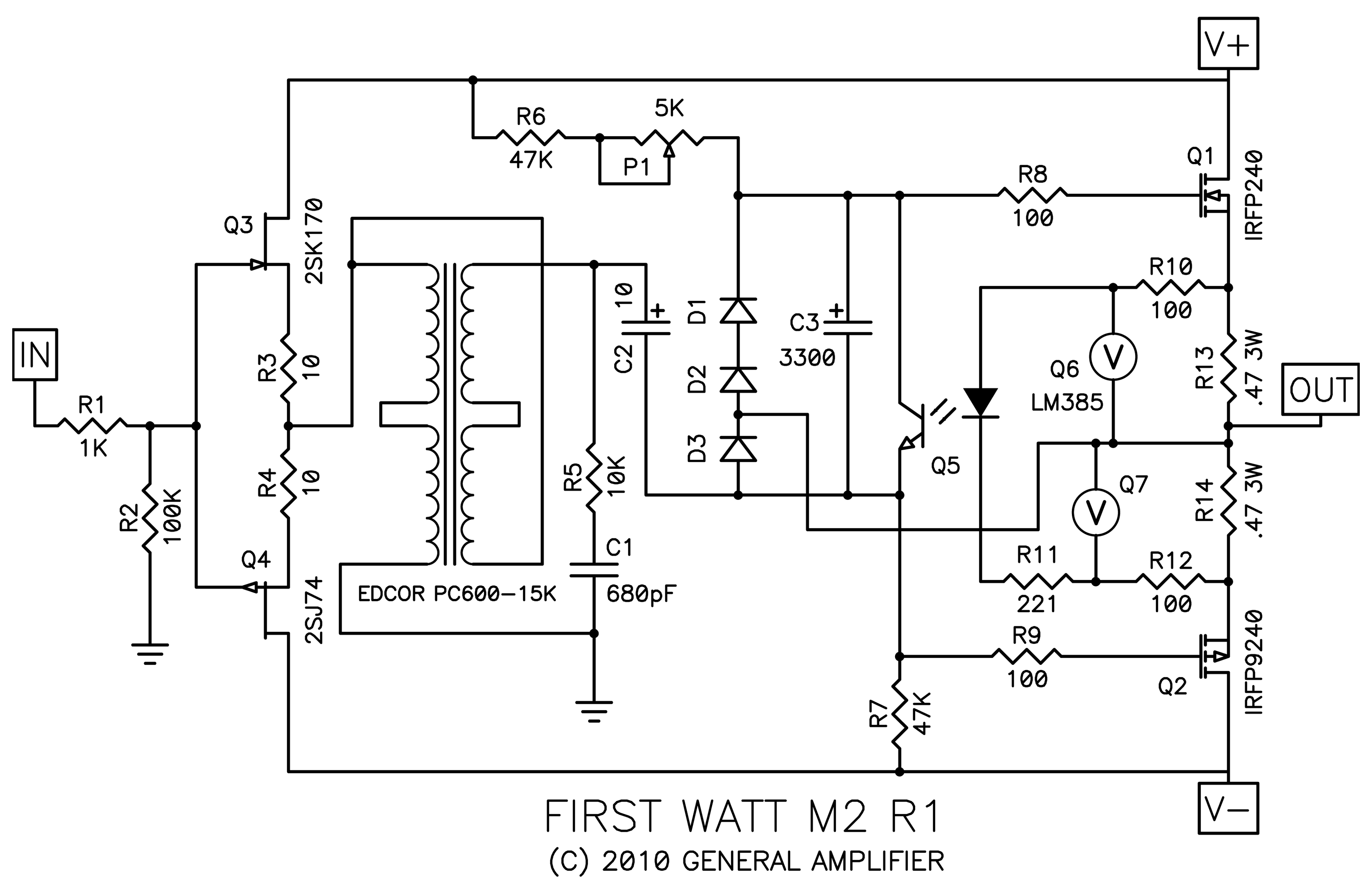

you can do the math:
The supply voltage drops from V+ over the n-FET, R13+R14, and the p-FET to V-, total drop some 45V.
Running at a bias of 1.5A (according to ZM) R13+R14 will drop ca 1.5V.
The data sheet of the FETs will tell you the Vgs necessary for that 1.5A, and remember that the Vgs of a p-FET is negative.
R6 and P1 need to drop the voltage from V+ to Vg(n-FET), and R7 needs to drop from Vg(p-FET) to V-. Between Vg(n-FET) and Vg(p-FET) the optocoupler will drop the two Vgs you read off the data sheet and the 1.5V over R13+R14.

I suggest the following alternate values for R6: 49K9 for a 5% increase in the adjustment range and, if not enough, 52K3 for a 10% increase in the adjustment range.

if I remember correctly - I finished having 68K in place of R6 .......
generally - if fiddling with pot can't shave positive output offset , increase R6 to first higher value (higher than sum of R6 and P1) , so 56K or 62K , or 68K in case of needing more change
same applies for R7 value , if output offset is stubbornly negative
all that referring to schm in Papa's post #1

, but there is opposite way for doing same thing - either increase appropriate resistor or decrease opposite one
regarding Iq - funny thing is pretty self-biasing ..... don't bother is it 1A2 or 1A5 or what , both channels will be the same and , as long as all parts are genuine , it'll sing as original Papa's
count on Ugs difference between N and P mosfets , for same current
however , as with all Papa's schematics - count on fact that he's usually taking parts from pre-selected drawers** , so changing any appropriate resistor (say for + or - 10%) if needed on the fly, is trivial thing to him
(one of) purpose(s) of all these schematics thrown on all of us in past few decades is pretty much the same - to same things became trivial to us , too
** he didn't said that , but logic dictates the same, for most cases ;
however , upon completing the amp , if output offset stubbornly stays negative , decrease R6 ; if it stays positive , decrease R7 ; I believe I needed 39K for one , but can't remember which ; even though I used FQP/FQN parts , Geschenk by my älterer Bruder Generg

so , just imagine effect of clamping diodes (D1-D2-D3) - they are clamping output node to rails , limiting max . signal amplitude
NB that output node is in strong correlation with mosfet gates , so clamping of outout is in fact achieved with gate clamping
Q6 and Q7 are there to maintain no more than 1V25 across corresponding resistors , saving LED from nasty peaks and maintaining smooth biasing

Now you may want to consider the Laterals such as the Allfets used on the F7, eliminate both the optocoupler and LM385 by using 4 x 1N4148 for bias and easier to drive due to lower input capacitances.
