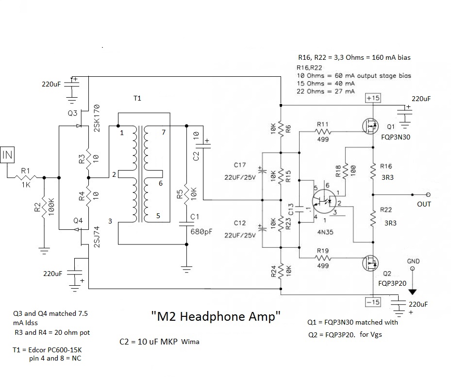

Official M2 schematic
I'm collecting parts together to build an M2. I already have a B1 buffer but I am wondering - is unity voltage gain is enough for the M2? I should think it's ok right?
Cheers
My room is small so I don't think I use too much power. I used a
cd player directly into the M2. Variable volume control was used
on the cd player. For me, it was loud enough. The max output
of the cd player was around 2V RMS.
Dennis

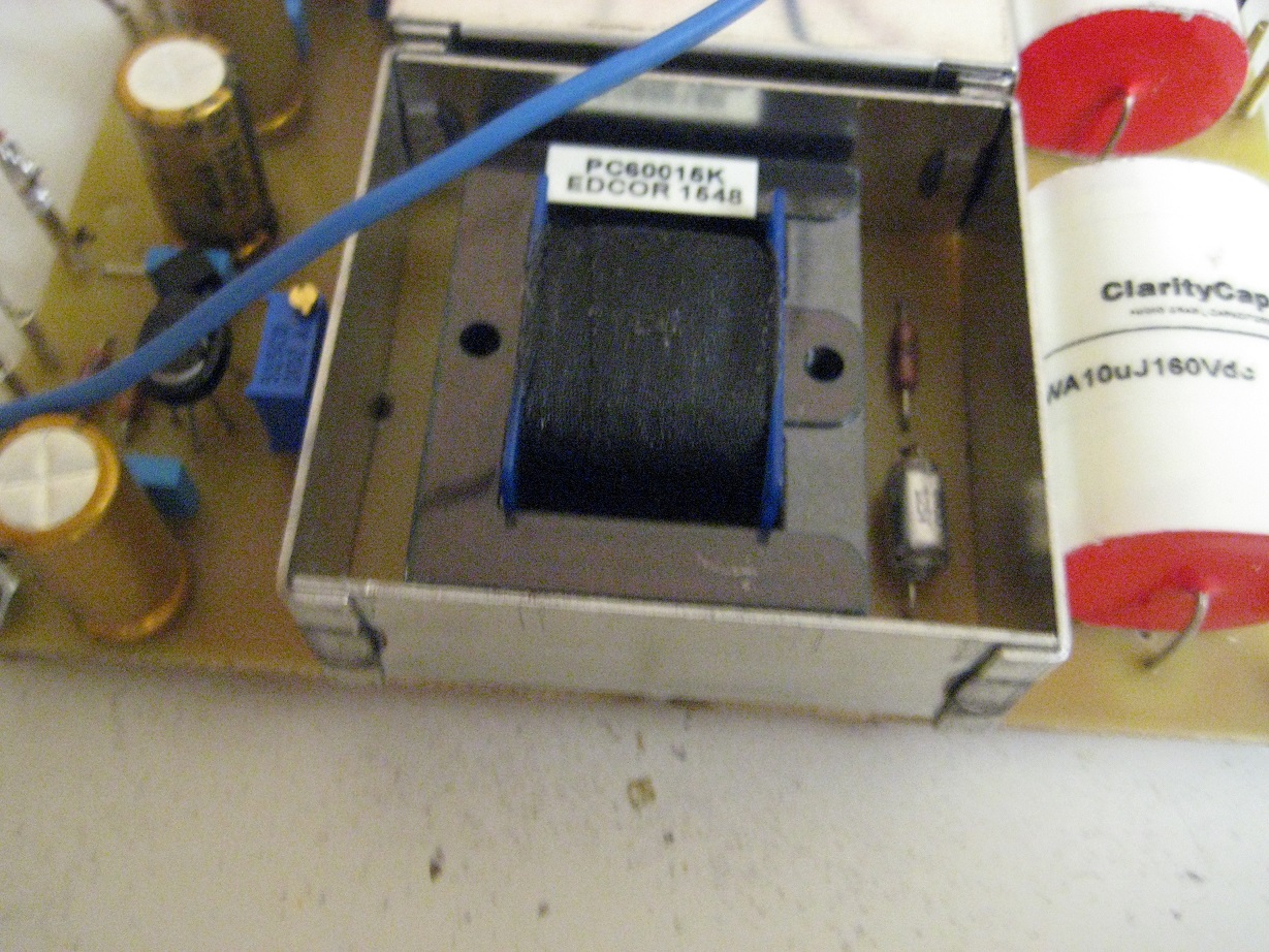

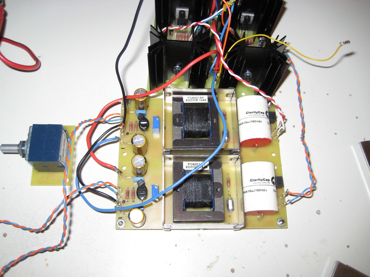

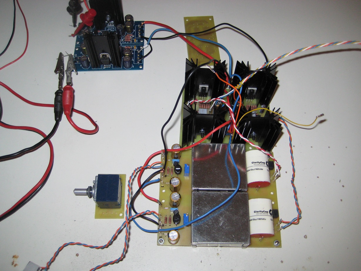

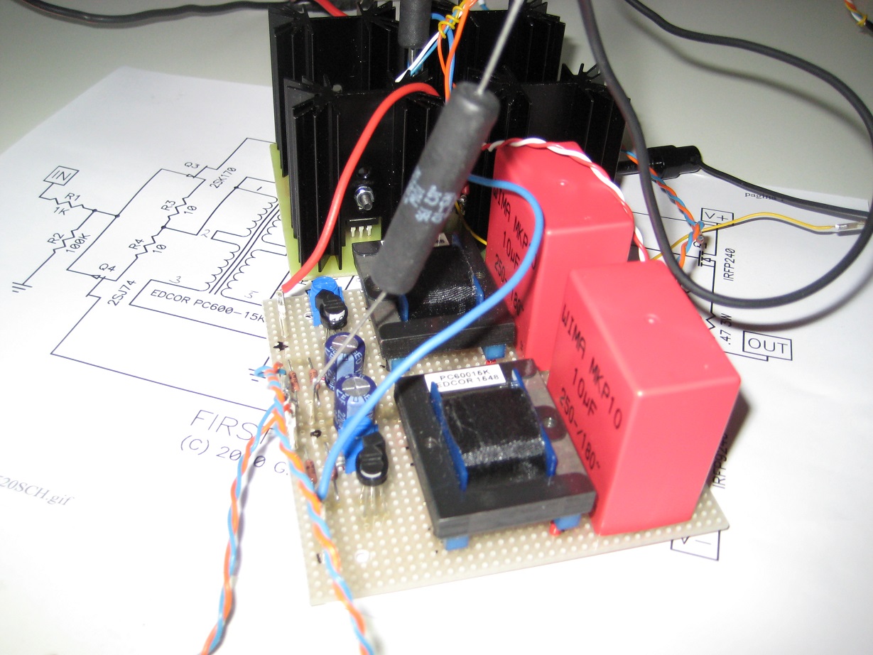

M2 frontend is sounding Mega Giga Super nice, as frontend for a headphone amp 🙂
I combined it with the upcoming DIY Headphone amp output stage and it's a keeper...
So I made a quick PCB, found some old Teko TK3710 RF-cases for shielding the Edcor's and the M2 Headphone amp is born 😀
Strange....I always hated the combination of transformers and audio...but I was so wrong... CSX1, F6 and now M2 they all sound so nice.
Makes me wonder how the M2 sounds on my big loudspeakers... 😱

Regarding the BOM, I added a resistor and a 5 mm LED to the schematic used to create the boards. Those two components are optional but I thought some people might want to install them. The resistor's designation is R15 and the value used in other published First Watt schematics is 10K.
Regarding the MOSFETS, there is no matching between N and P devices, but pay attention to what Nelson said earlier in this thread.
If the Vgs difference between the devices in a given channel is larger than between typical Fairchild ones, you may have to tweak the effective value of the trimmer to be able to set the output offset to 0.
[from zen Mod]
or value of resistor in series with pot
